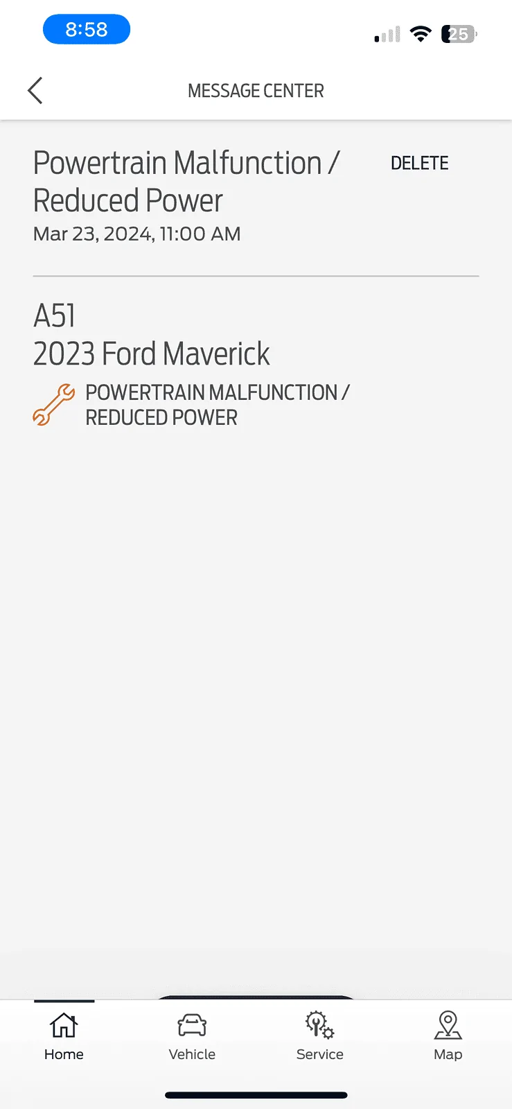

So I just got hit with this junk today. Had 10k trouble free miles, got my service done including a couple reprogramming recalls and sure enough my truck died on the expressway less than 1k miles later.
2023 Lariat Hybrid deliver Feb 2023
Ford Maverick Powertrain Malfunction/Reduced Power Mode IMG_2451

I bought a code reader that can reset the computer. I don't want to give them my truck just to collect dust while corporate figures out a fix.
Welp. Truck cleared itself this morning when I was driving back from daycare. Also shows no issues in Ford Pass now. I'll still scan it once the reader arrives.
