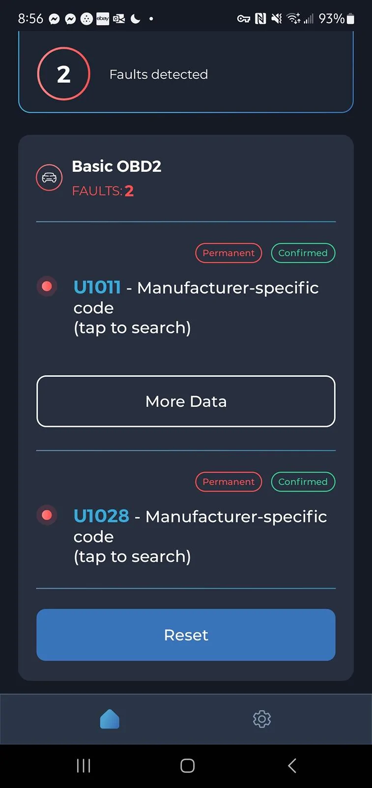

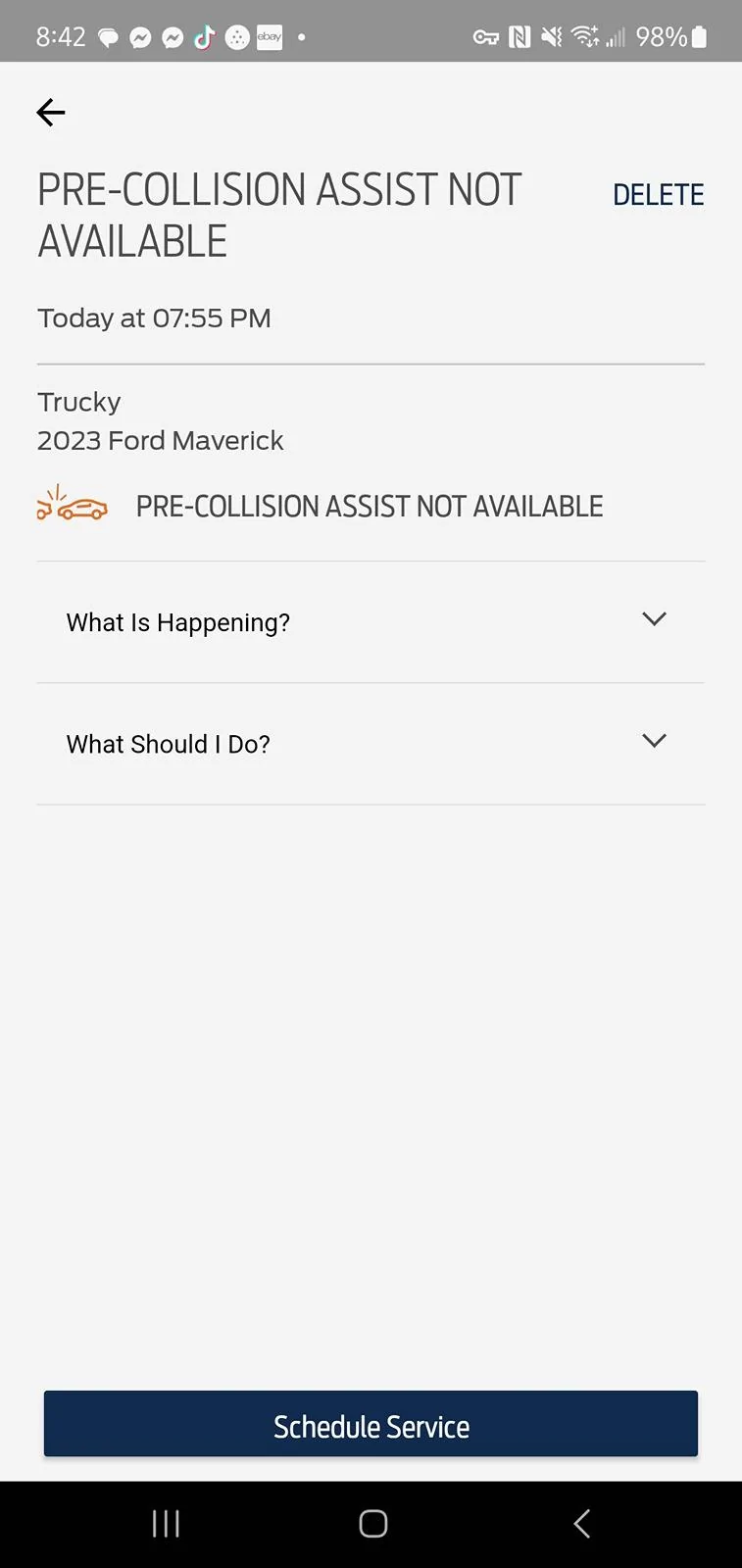

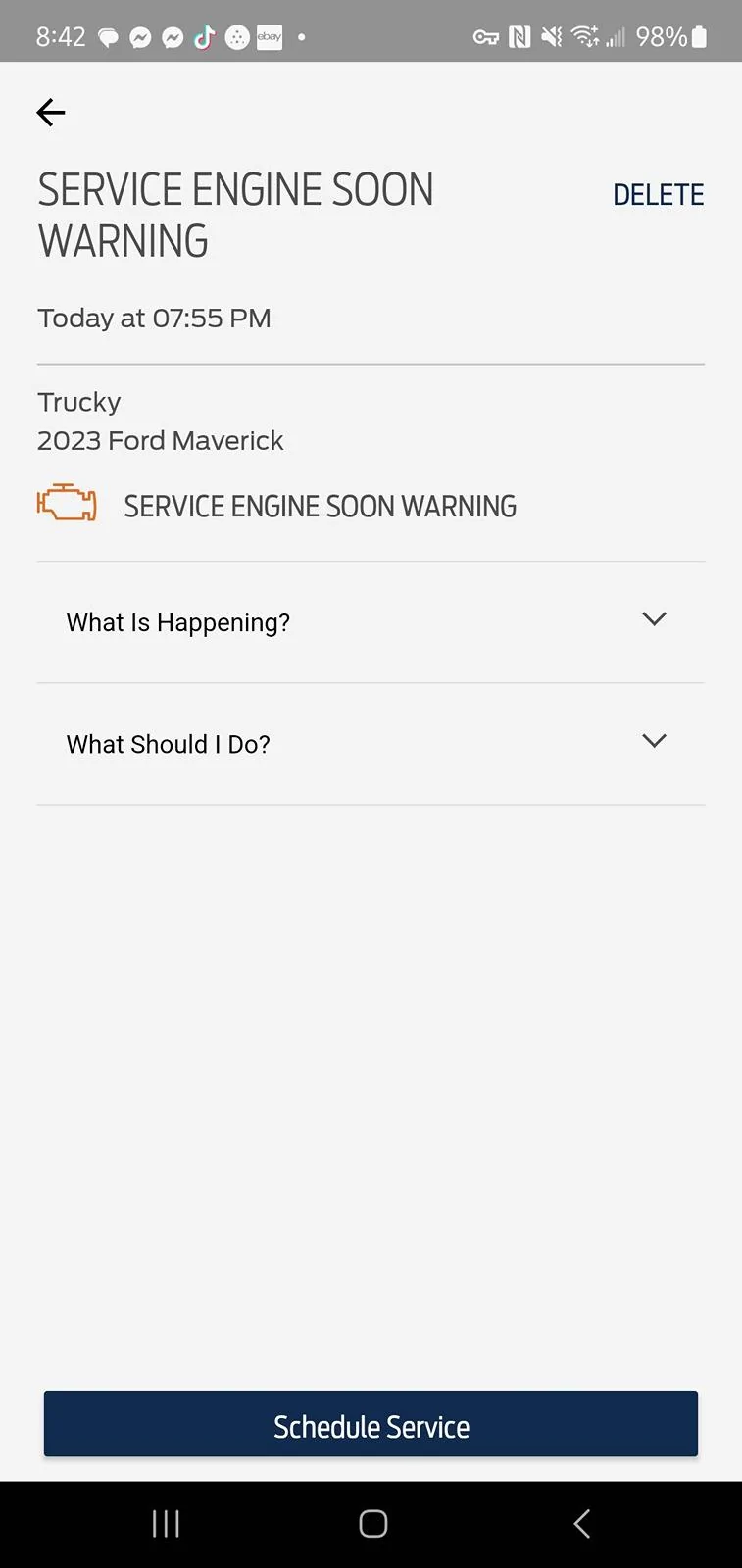

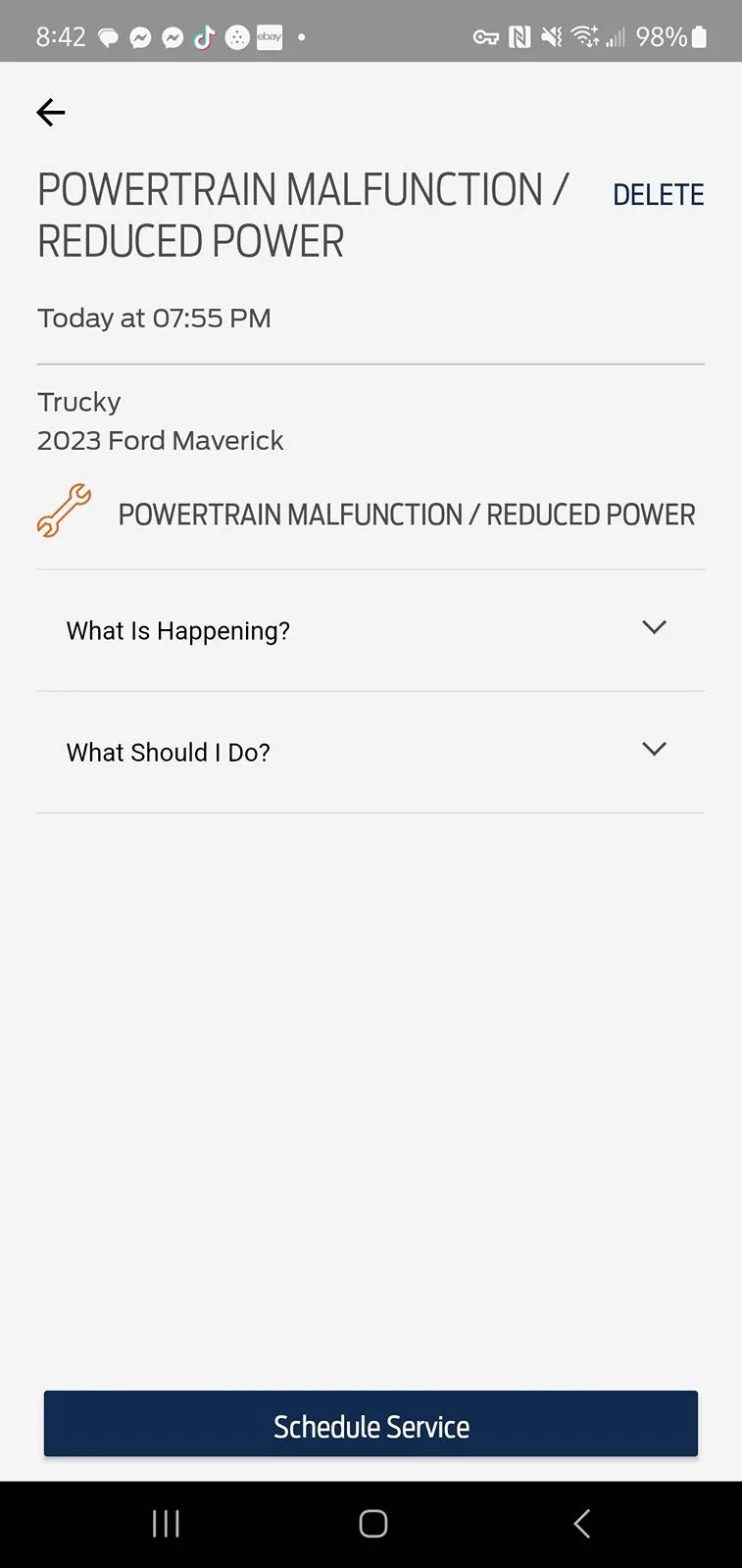

Well it's happened to me with my 23 XLT Hybrid with less than 12K miles.
Driving home around 65 and the dash went crazy. Pulled over, turned the truck off, and waited a little while. I then turned the truck back on and it drove home fine, but the CEL remained on. I also recently had the turn signal recall done a few weeks ago. I haven't done the instrument cluster recall.
Thankfully no one was behind us when this happened!
