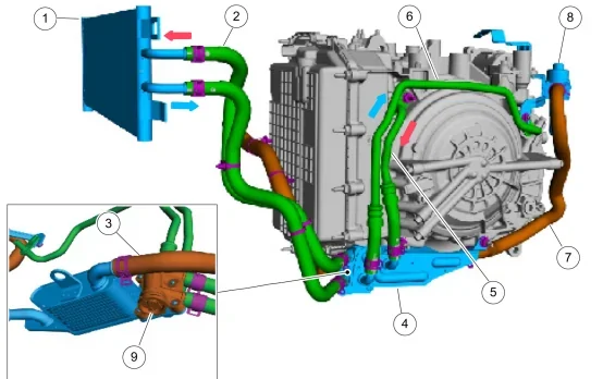

I thought all EB’s get the transmission cooler and the 4K did not add anything.
You’re saying the EB 4K gets a bigger transmission cooler than the 2K or maybe the 2K gets no transmission cooler. Model year differences also?
Apologies to OP for continuing to go off topic. EB folks can be obnoxious haha.
They all have transmission coolers.
Looking at online parts ordering, it appears that 2025+ EB 4K tow package may have dropped the auxiliary cooler setup, but it isn't clear. IMO, this would be a major downgrade for the 2025+ 4k tow EB Maverick. Parts ordering shows that in 2025, the aux. cooler is only found on the Tremor.(?) I'm not 100% certain on this. It would be great if a 2025+ EB 4K tow owner would check for the existence of the aux. cooler hoses, easily seen behind the radiator.
EDIT: I had forgotten about this prior thread where it was determined that the 2025+ 4K tow does not have the air-to-fluid cooler so disregard the below as it does not apply to 2025+.
For MY2022-2024 only, so disregard:
Both standard EB (2K) and 4K tow EB get a water to oil (trans fluid) heat exchanger. The purpose of this is to warm up the transmission quicker when cold and keep the transmission closer to water temperature (~185 degrees) when hot.
In addition to the exchanger, only the 4K tow EB and Tremor get an auxiliary air to oil cooler in front of the radiator. This setup typically keeps maximum transmission temps about 10-15 degrees cooler than the standard EB setup. IMO, this is the most important of the upgraded components the 4K tow package offers to the EB Maverick.
In normal, everyday operation a temperature of 200-210 is typical for a standard EB 8F35. In a 4K tow EB Maverick, it is rare to see temperatures higher than 195 degrees. With my bed loaded with gear on steep Rocky Mountain passes, I've never seen a transmission temp higher than 206 degrees in my 4K tow EB.
#1 below is the auxiliary cooler that is only found on 4K tow Ecoboost Mavericks. This has a thermostat that opens for operation at 194 degrees.
#4 below is the heat exchanger.
