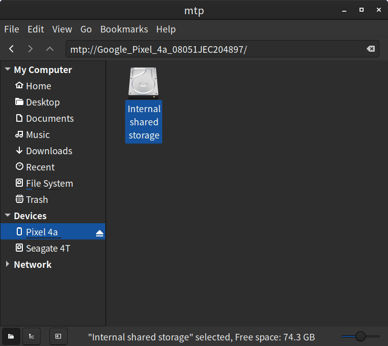

On Android, couldn't one just select USB File Transfer (aka MTP - Media Transfer Protocol) when connecting the USB cable to the Maverick? Then use the Mav's USB music player?
On my Linux PC, it makes the phone look like a removable drive when connected via USB.
I don't have my Maverick yet, but am hoping I can play music stored on my phone, via USB cable, using MTP.
Ford Maverick Placing music on a USB drive Screenshot from 2023-07-09 12-51-59
