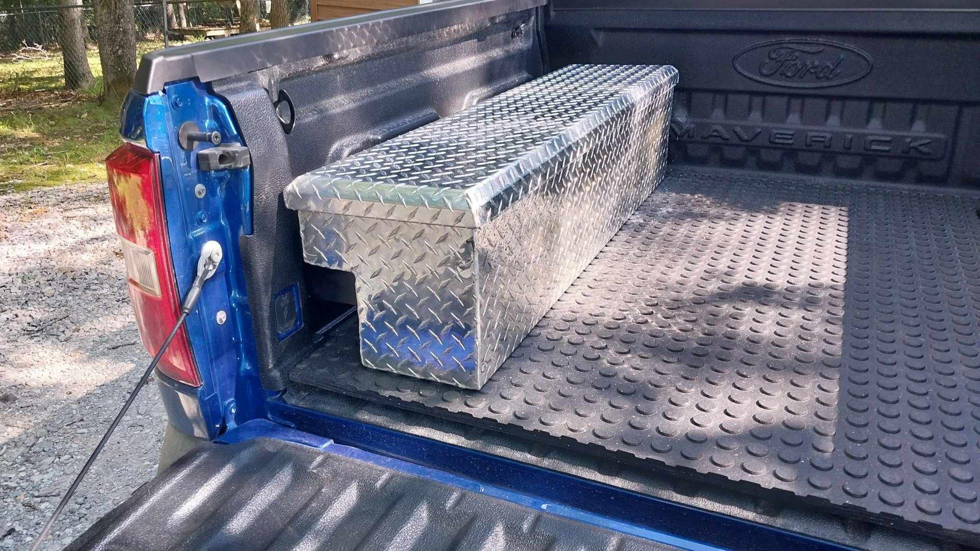

We switched to the Mav from a sedan and sometimes I miss having a trunk to throw a cooler and other stuff in. A hard tonneau cover and 2x6 would get the job done, but I'm cheap, and I already had the wood, so I put together what I'm calling the Pickup Truck Trunk.
The front piece slots into the bed pockets, with a spacer at the bottom to increase the footprint.
The 2 side blocks slot under the bed edge and hold down the top with 5/16" carriage bolts and star knobs. The 1by is cut to length to fit snugly into a pocket in the bed side with a cut out for one of clips for the plastic bed toppers.
The top piece has a J channel to lock the front piece. It's cleats are also trapped, side to side, by the bed, in front by the side blocks and in back by the tailgate.
I also added a couple pieces of parachute cord to clip the big pieces down, just in case. As Mike Rowe used to say, 'Safety 3rd'.

Good idea. I found 2 old light weight chrome shelfs and very strong Harbor Freight magnets that hold them in place and a couple of painted 2x4 in the bed notches to secure them. Similiar to yours but I can disassemble magnets in seconds to take out when hauling big stuff. Something else I added is an old hiking stick, drilled a large hook in one end that stays in my bed to pull items that may slide to the back of the bed, out of reach. Hiking stick hook comes to the rescue.
