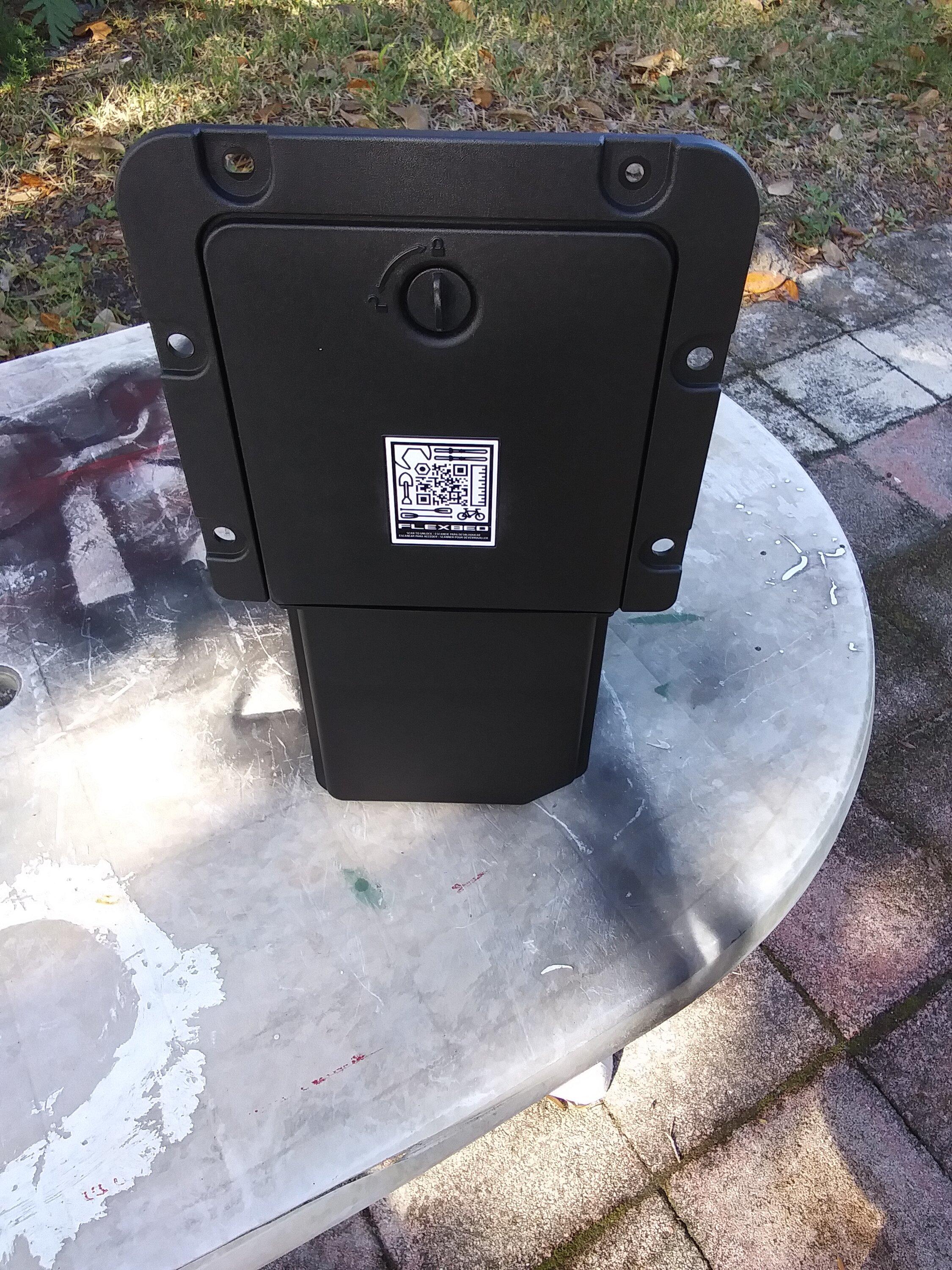

Went to dealer this am and they actually had cubby /compartment in stock . $45 + tax fordpass points . want to use up fordpass points . look up # NZ6B-E286C36-AD to find part and it has a different part # . funny they didn't have hb-1 bolts in stock . Will make due with what I have . didn't install yet .

Installed cubby on drivers side/left side . not a big deal . will need 10 mm socket/wrench and T-30 bit/wrench to remove tie down holder for cubby to fit it in . I had additional 10 mm bolts in my bolt leftover container . otherwise you'll need to add later on . you could just use the 4 bolts from the cover that you have to remove . take one out to take to Ace or other small hardware store for comparison or order from dealer . so I have cubby o n both sides . keep tow strap , bungee and tie down straps in cubbies .

Amen on taking one of the bolts you have to a hardware store and match up..........the bolts from dealership were $15+ for a pkg of 4, and you only need 2. I think I found matching ones for 40¢ each.

Although not needed, I ordered two extra bolts from the manufacturer of the cubby, just for appearances sake, to fill in the two extra holes. The bolts were fairly cheap. That said, I could not get them to screw into the two holes. I was afraid that I would snap them by trying too hard. I assume that it is Line-X spray in the holes that is blocking the way. So, I left the two holes empty. No one notices it, but me.

What he said but don’t wait for ford and their bolts. They only come in a pkg of four and are $5 each! Go to your hardware store where they can be had for less that a buck a piece.
