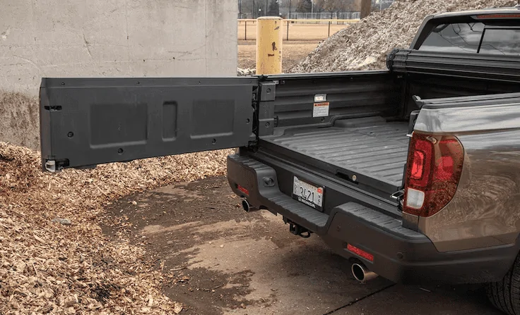

I'm jealous of the side opening tailgate.
But of course I want it all, I don't want to give up the middle hook for sheet goods.
My CRV had a side opening hatch, sometimes it was helpful, sometimes it was a hindrance.

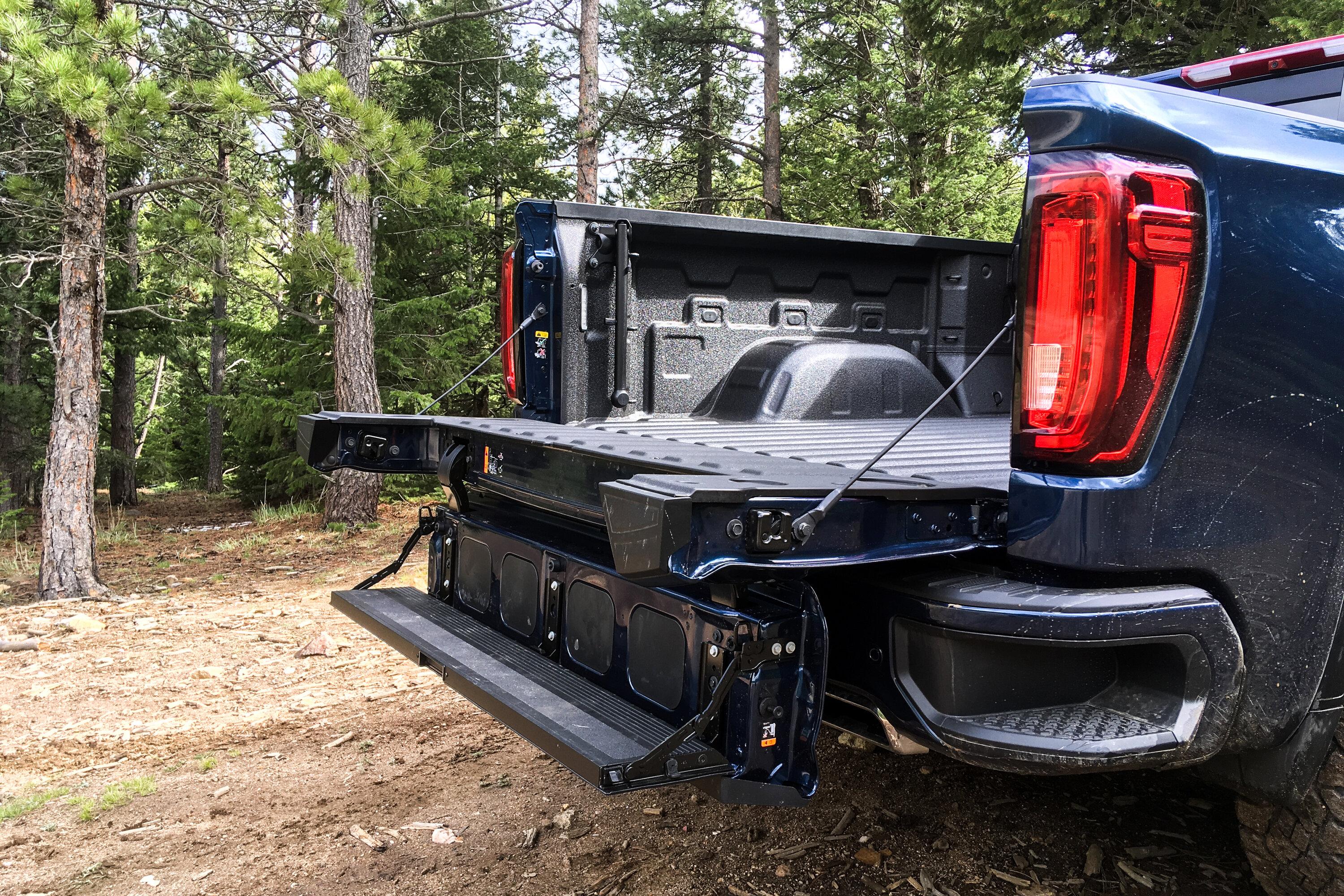

I think GM has the best design with the step that pulls out:
Ford Maverick Pickup Truck Trunk gmc-multipro-tailgate-review-1
Plus the steps in the bumper... literally perfect for any size truck. It's just sad to see them all feel the need to get so tall and oversized.
I refer to that as the “magic tailgate.” It’s a great design. My Maverick is lowered so even as a short guy, I don’t need a step.

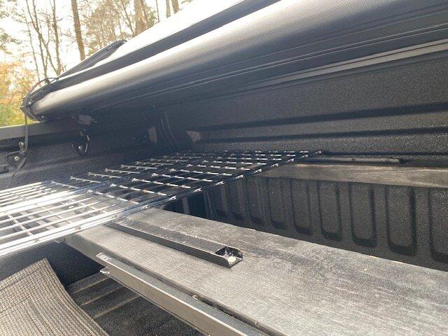

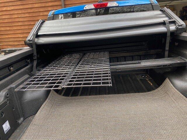

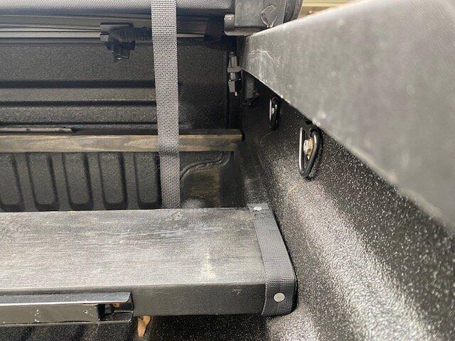

This works for me - very functional and very cheap. (Max cost was about $90-$120) 2x6 lumber cross members with Harbor Freight "very strong" tool hanging magnets, (1/2" by 2 feet - $3.40 each, nailed to the tops of the 2x6's. Ran across the 3 metal racks at Lowes. I put in 1 to 3 racks on top of or beside the 2x6's depending on what I'm hauling.
The 2x6's have old pieces of straps nailed to the ends of the lumber to keep them from scratching my paint/SIBL. The 2 1/2 ft x 4 ft metal racks (shelves) (needed no cutting) were like $40 at Lowes and I can simply lay them on top of the 2x6's and the two 10lb magnets hold them very tightly with 20lbs of magnetizem without rattling. There's 2 HF magnets on each 2x6, I can lay the metal racks down horizontally across the vertical 2x6's or have the racks horizontal, held by side magnets on the 2x6 depending on what I am hauling. OR, simply take them out completely to haul a dirt bike or sheets of plywood. The 3 metal racks laying horizontal across the top of 2x6's provide a shelf for hauling 2 layers of stuff. (shown in pictures)
NOT SHOWN are 2 (2 1/2"'x6') "Underbed" plastic bins that or on wheels so I can easily pull the binds out. Plastic underbed binds at Walmart were $5-$10.00 @. Occasionally some things roll forward so an old hiking stick with a hook on the handle helps retrieve whatever rolls. Hiking stick is held in place with broom holder (magnetic of course) and attached to the inside of tailgate so it has easy access. Hopefully below pictures will better explain.
All of the above can be pulled out of the bed in 1 to 2 minutes or put back in, in 1 to 2 minutes. Secret to this set up are the strong magnets from Harbor Freight. Everything stays in place. Been using for almost 3 yrs and 20,000 miles on 2022 Hybrid and has adapted to everything I hauled. Gator Tri-fold tonneau has been on for 2 1/2 years and I've never seen a drop of rain get through. Below the horizontal racks I can keep the two 2 1/2 x 6 foot "underbed trays" that are on tiny 4 casters.

The horizontal rack sits on the bed ledge to the left and an additional magnet attached to the side bed to secure rack does not move or rattle.
Ford Maverick Pickup Truck Trunk IMG_1689
2x6's for horizontal rack are 1 up front and 2 more on the other 2 slots in the bed. Straps keep the 2x6's from moving and scratching SIBL.
Ford Maverick Pickup Truck Trunk IMG_1690
Horizon racks sitting on top of magnets nailed to the 2x6's provide two layers for hauling stuff. Metal selving racks could easily hold 100-150+ pounds.

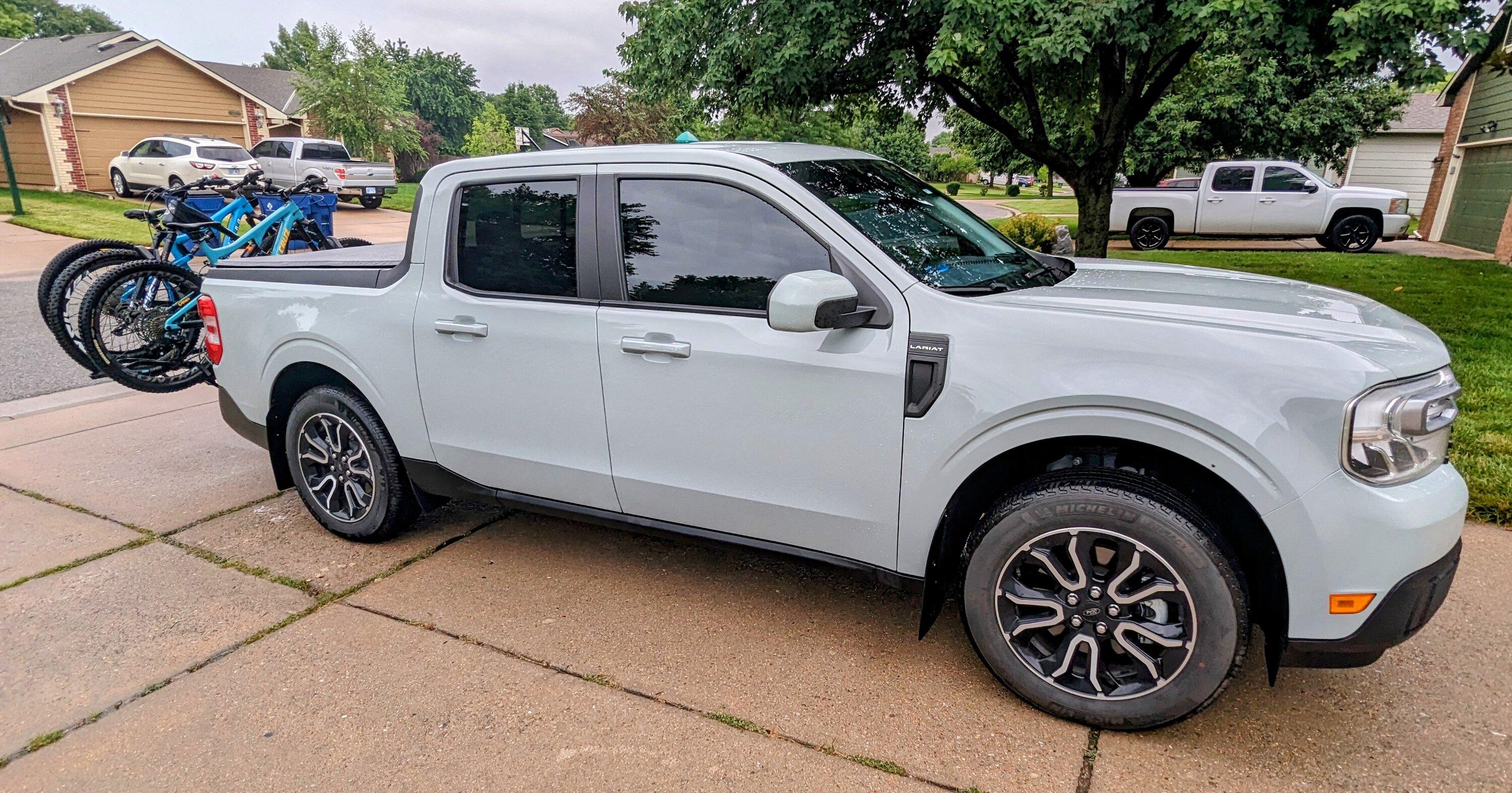

Since it’s not sitting over the “axle”, do you feel the weight? I hope I make sense.
reason I ask is because I had a HD bike rack (45-50lbs) on the hitch and a 31lb bike and I could feel it back there. It’s hard to explain but I do have 4k tow.
The weight wasn't noticeable at all. I've often wondered it mounting things to the receiver would effect the feel, if not the handling, of the truck.
it's the aerodynamic drag you're feeling, not at all the weight. I know this because I have done it.
Makes sense. Thanks for the confirmation.
BTW, I have no doubts with the Mav. I was just curious what it was I was noticing.
