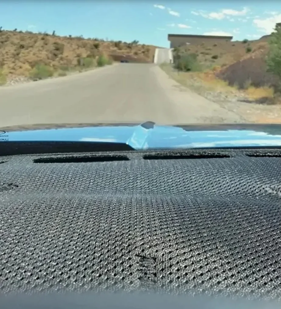

Ford Maverick "Park Brake Limited Function, Service Required" after truck rolls backward toward a drop-off Screenshot_2026-06-09-16-31-09-11_40deb401b9ffe8e1df2f1cc5ba480b12
I also made a video of it not happening. My proof.
Same Hill. Watch the drive indicator as I shift to park. I then open the driver's door. NO automatic parking brake activated.
2025 change to the software?
