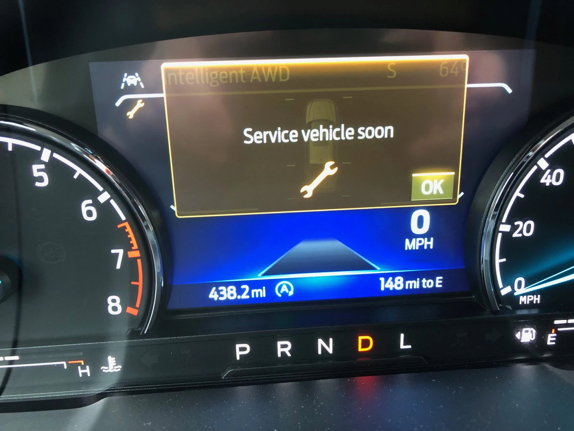

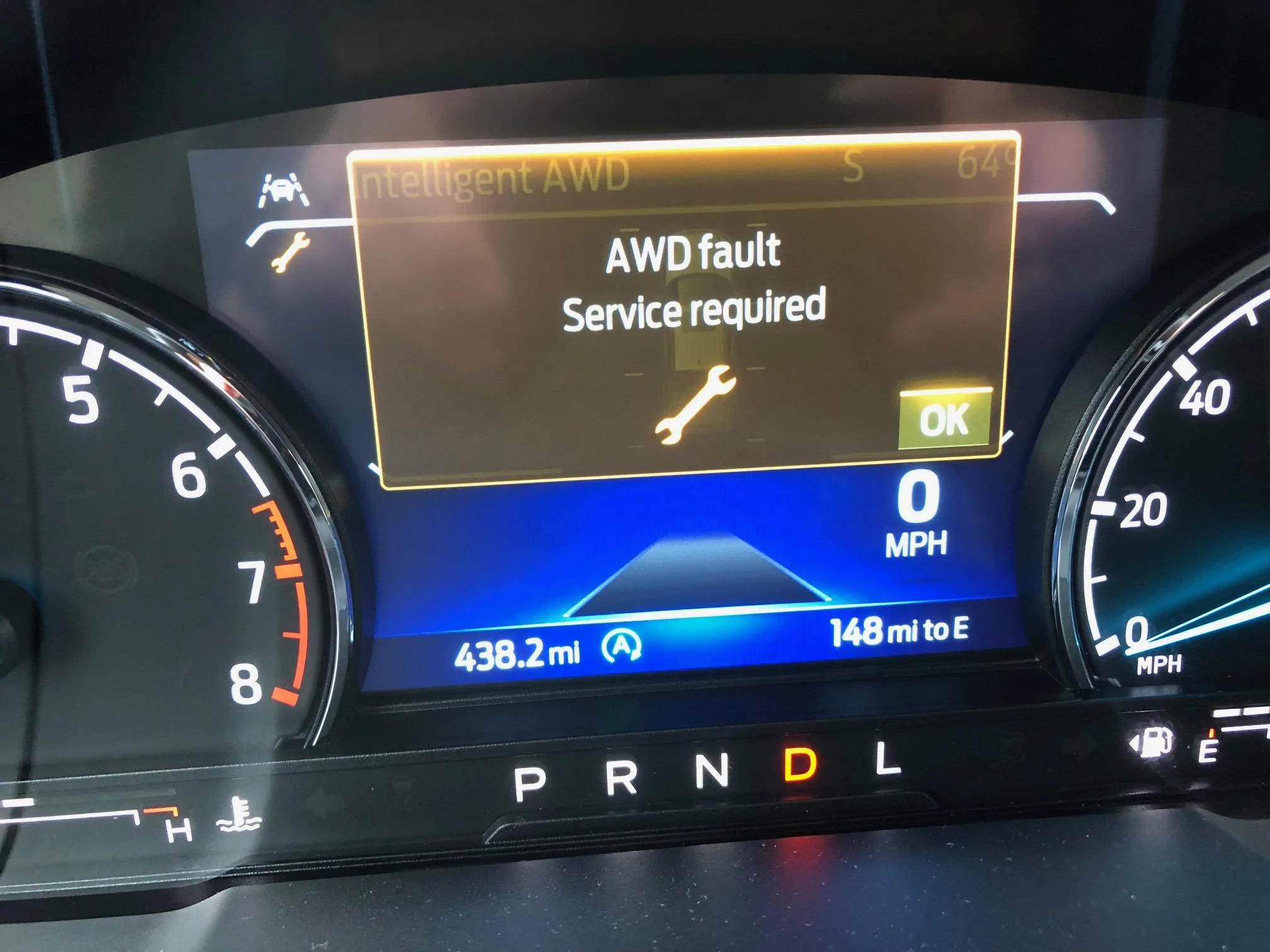

Yep, unfortunately this is the latest added to my list of various issues (some minor, some not) that I've experienced with my Maverick since purchased in Dec. 2021.
The scenario:
At about 4K miles, I got in my truck to go to work one morning (happened to be my birthday), turned the key and it cranked up as usual with no hesitation but immediately popped up the "AWD fault Service required" message. I pushed the ok button to acknowledge on my steering controls, then the complimentary "Service vehicle soon" message popped up. I seem to remember, but can't swear to it, noticing that the engine idle seemed to be a little lower or maybe sounded slightly off timing wise. So, I turned the engine off, waited for a couple seconds, then turned it back on and the two message duo... AWD fault... and Service vehicle soon... messages both appeared once again as before. I powered off/on the engine one more time, hoping that this would clear it this time, but the same results appeared yet again. So, I decided to start my trek down the road for a piece, to see if that may reset the fault warning messages. Low and behold, that worked...so then I power cycled the engine a couple of more times just to make sure it didn't pop right back up, and fortunately, it did not.
I made it to work with no issues and it hasn't appeared since. I'm at 5,090 miles at the time of this post and no more warnings since.
I've got a service appt. scheduled for Aug. 1st to have them address this and a few other matters, so we'll see what they tell me then.
I'll update after that, when I get a chance.
Seems like Ford Quality was definitely not JOB ONE in this instance :mad:
