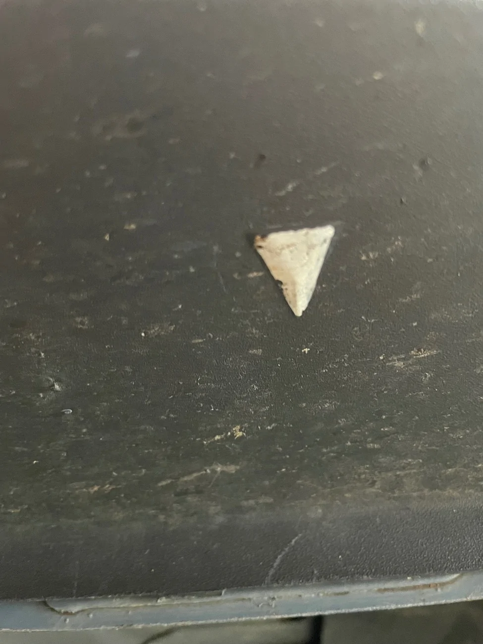

The little arrows that point to the pinch weld lift area is really hard to see. It’s easy to paint those white or any bright color. This makes them so much easier to see. I used a fine tipped small brush. Painted them on my truck when new and after 15,000 miles they are still easy to find.
I put a piece of grit tape on my little arrows. Makes it much easier to feel & position the magnetic pick” onto the pinch weld. Yours are prettier - but you can’t see them unless you stick your head down there:)

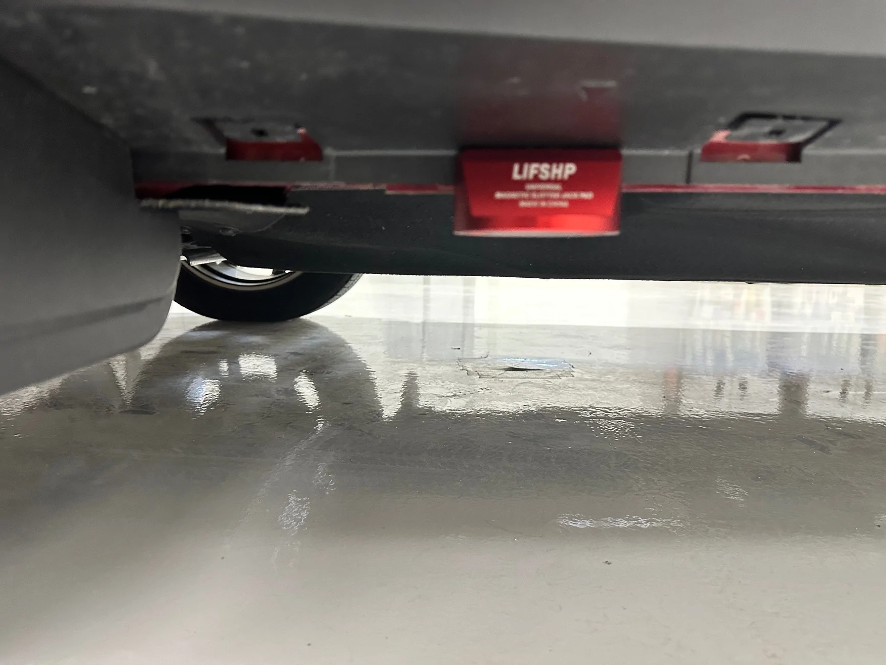

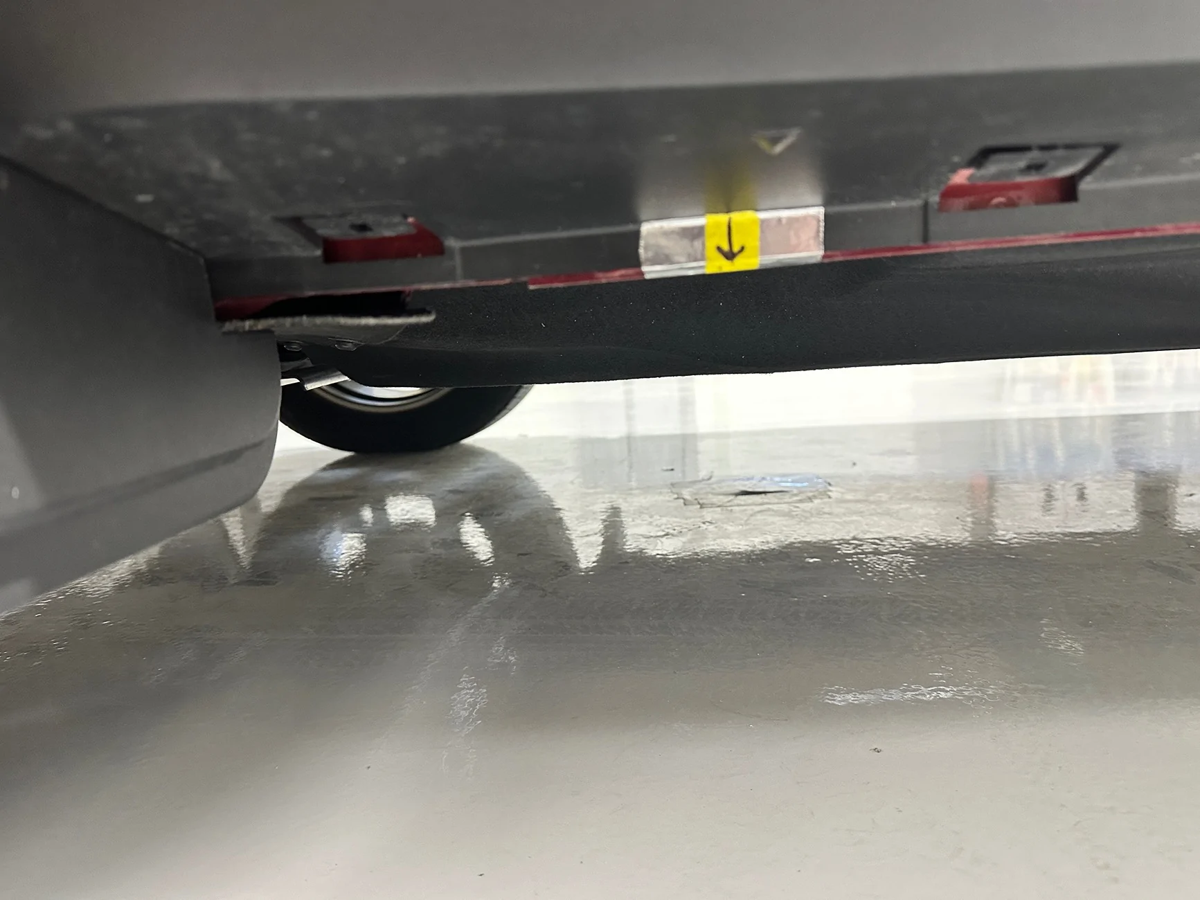

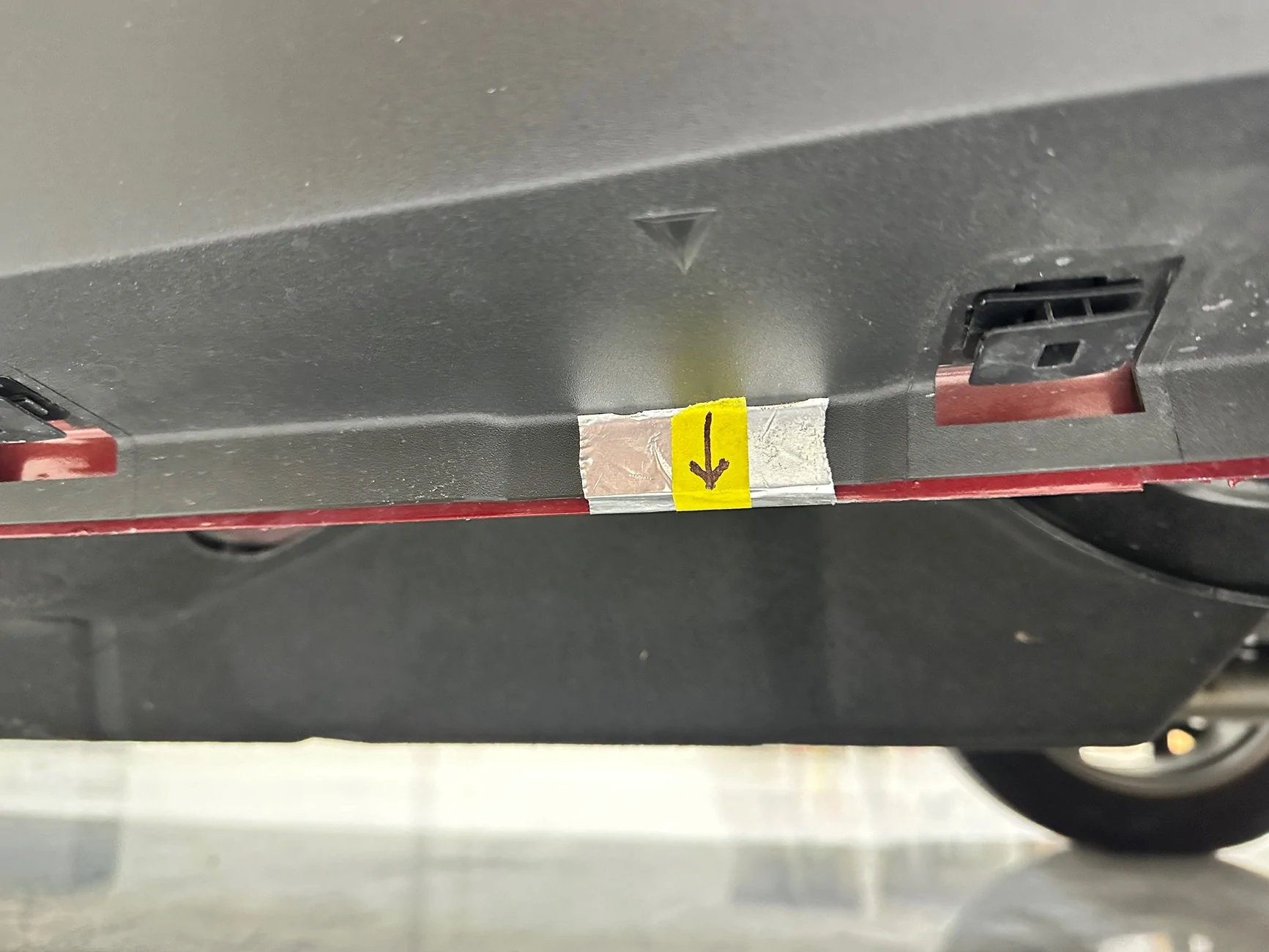

I did something similar as I had been considering taking the truck to Discount Tire to have a tire balance issue addressed. If you’ve ever been there, they get 4 guys all with floor jacks pretending they’re NASCAR Tire Changers and they’re just gonna throw those jacks anywhere they think is solid. Well, I marked the spots, but still haven’t summoned the courage to take it in…
I also bought a magnetic jack pad that clips on over the pinch weld (3rd pic).
I have a different but very similar jack pad. It has a magnet in it, but even so, it is tight enough on the weld/plastic trim that I have forgotten to take it off and have driven around with it hanging from the rocker panel for a day or two. :D
