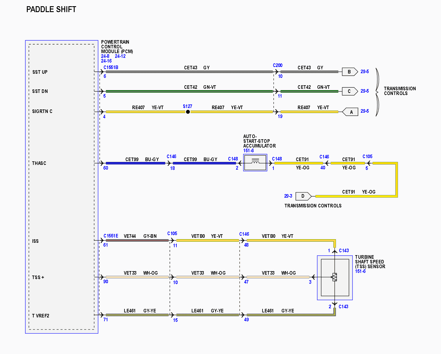

Is that what pin 7 is for, signal return?
Signal return its for the padle shifters it self. Reference ground low current. I dont belive its for the cluster to know what gear the truck its in .

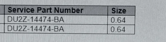

Parts list of things needed for the conversion will add them here later on.

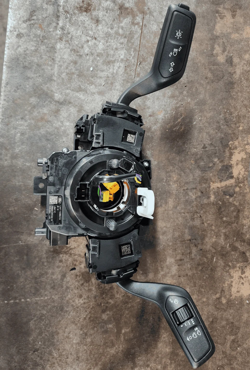

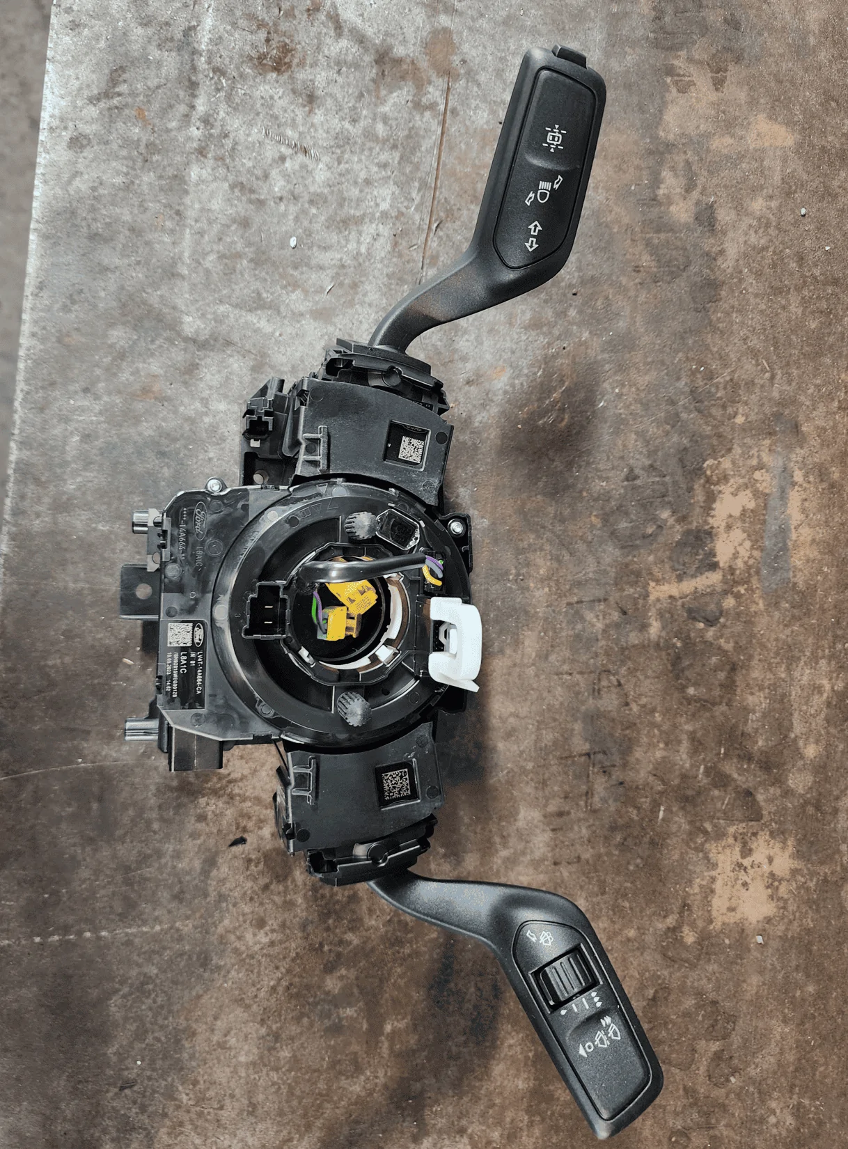

Steering control Module from Ford Maverick XLT With Heated Steering Wheel and lane departure if you want it. Module will Come with both switches and Clockspring.
Steering Wheel that comes with Paddle Shifters of your preference Ford Escape Or Bronco. i took a risk and bought an European on From Ford Fiesta ST but you dont have to spend that money for it.
PCM Wiring terminals X3 so You can add them to the pcm connector.
DU2Z-14474-CA
Steering control module
Connector Terminals X3
DU2Z- 14474-BA
Wires Looms , Zip ties and shrink tubing for wiring and 3 different colors 16 gauge cables.

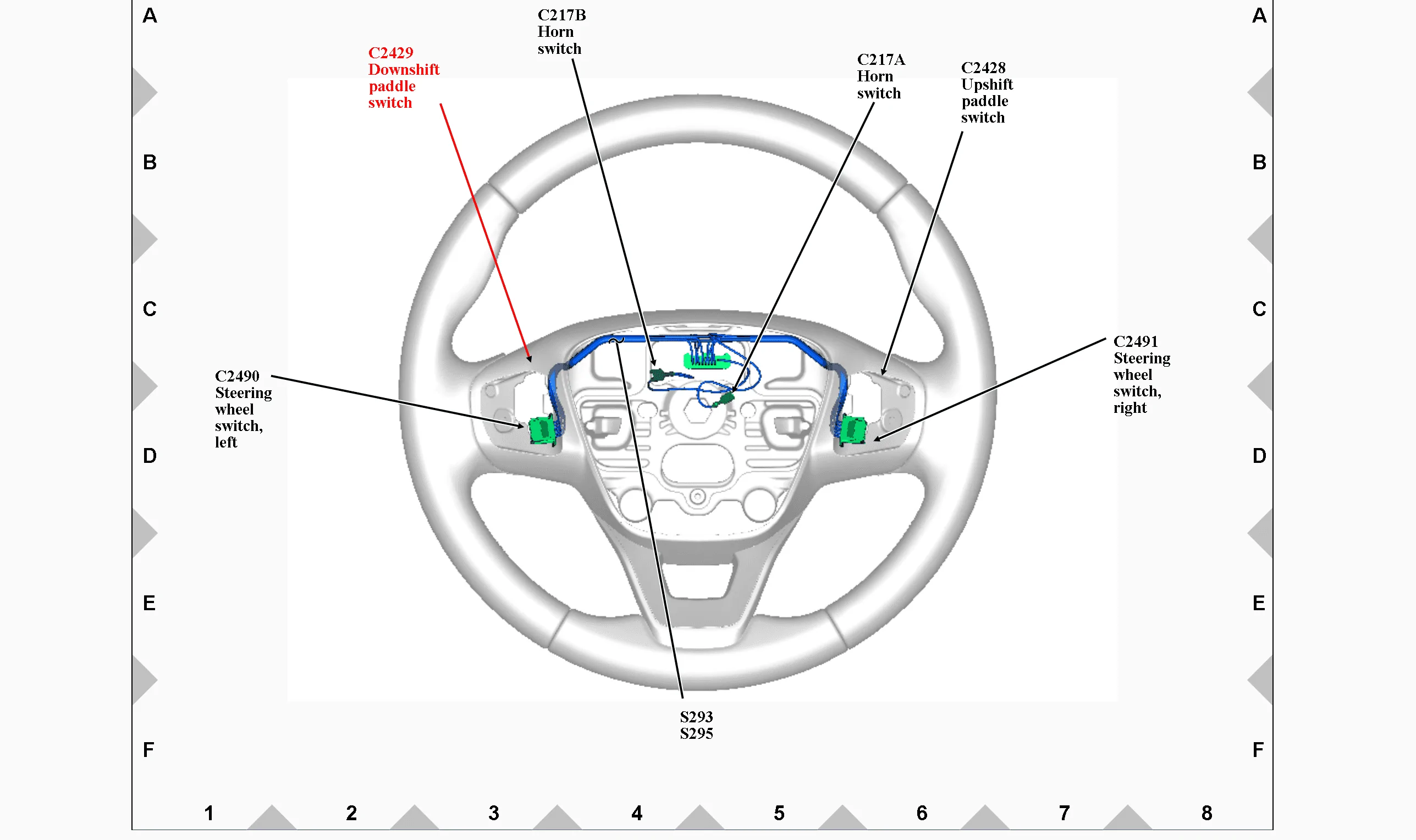

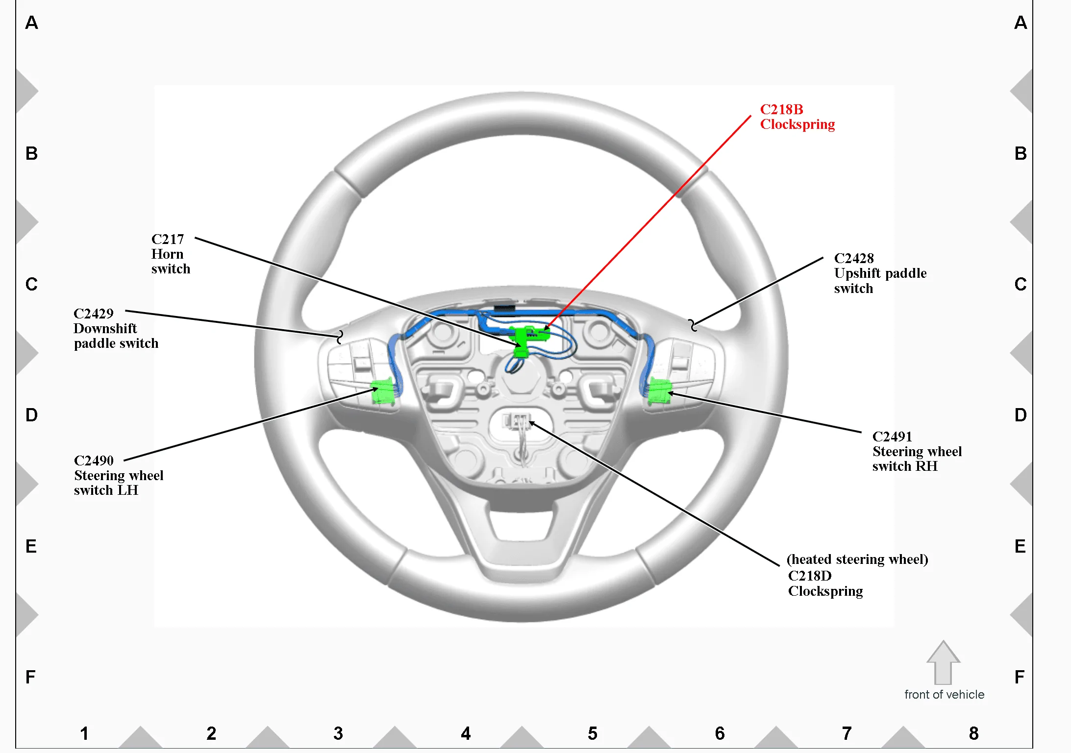

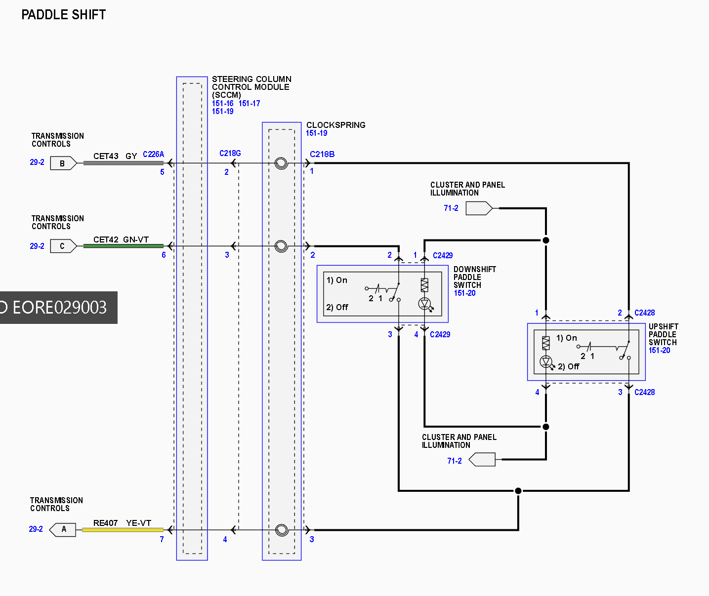

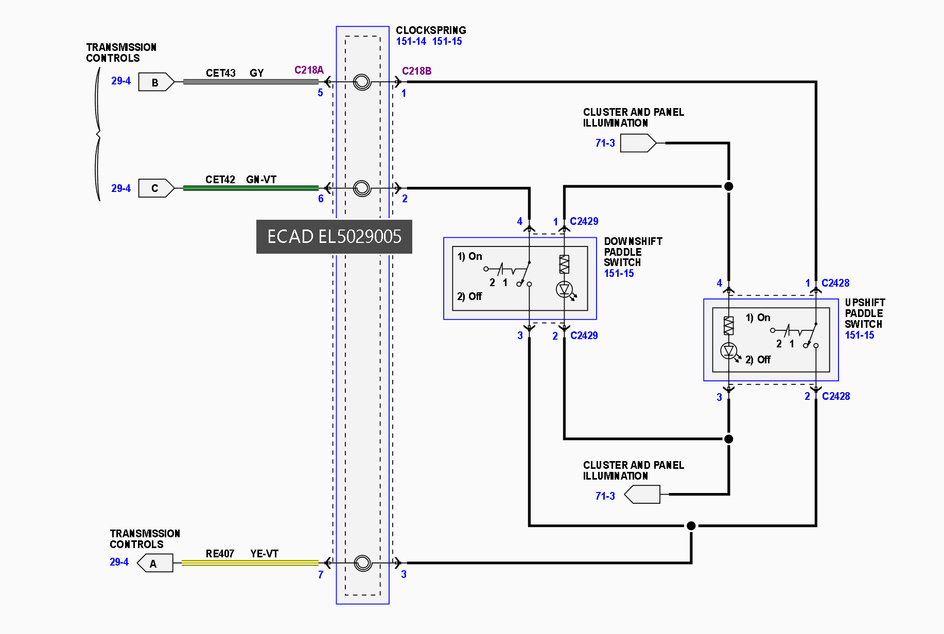

Transmission paddle shifters wires diagram. adding here.
Now i will be adding the Ford Maverick 2022 XL since thats the one i drive . Mine already has Cruse Control added and other switches. Notice this one on the PCM Shows it already comes with 2 wires for the up shift and down shift on XL model its false the diagram i had to add all 3 wires.

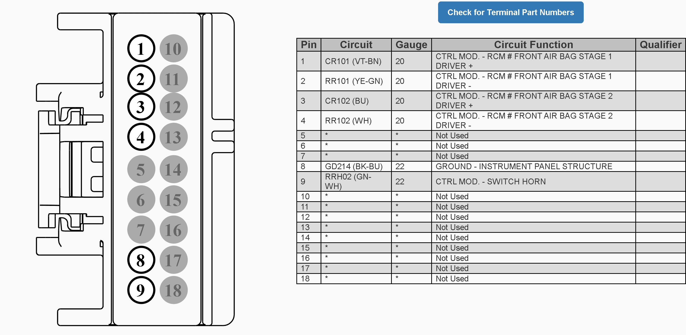

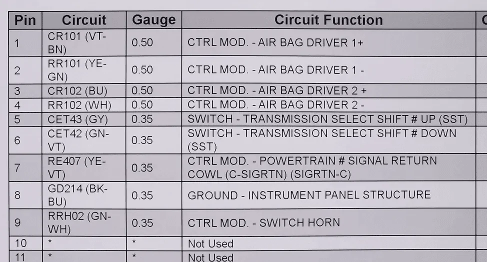

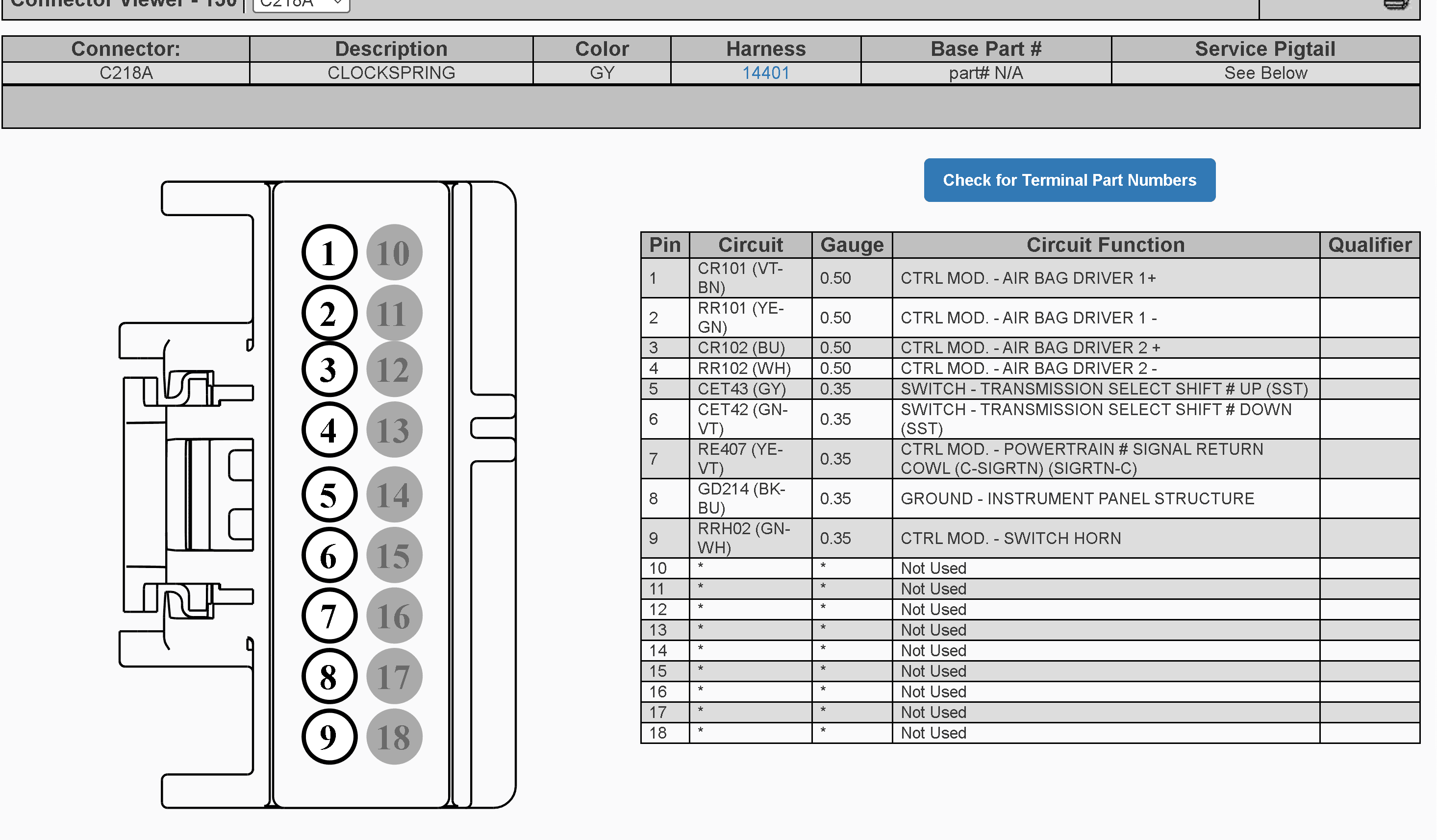

PCM Connector from 2022 Ford Maverick shows pin 5 and pin 6 from pcm having shifter up and down . Good sign """
Connector from clock spring to steering wheel shows pins could be added for the steering wheel .

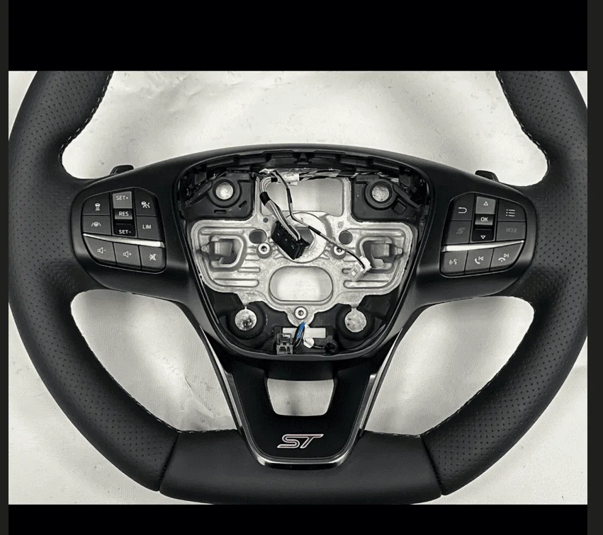

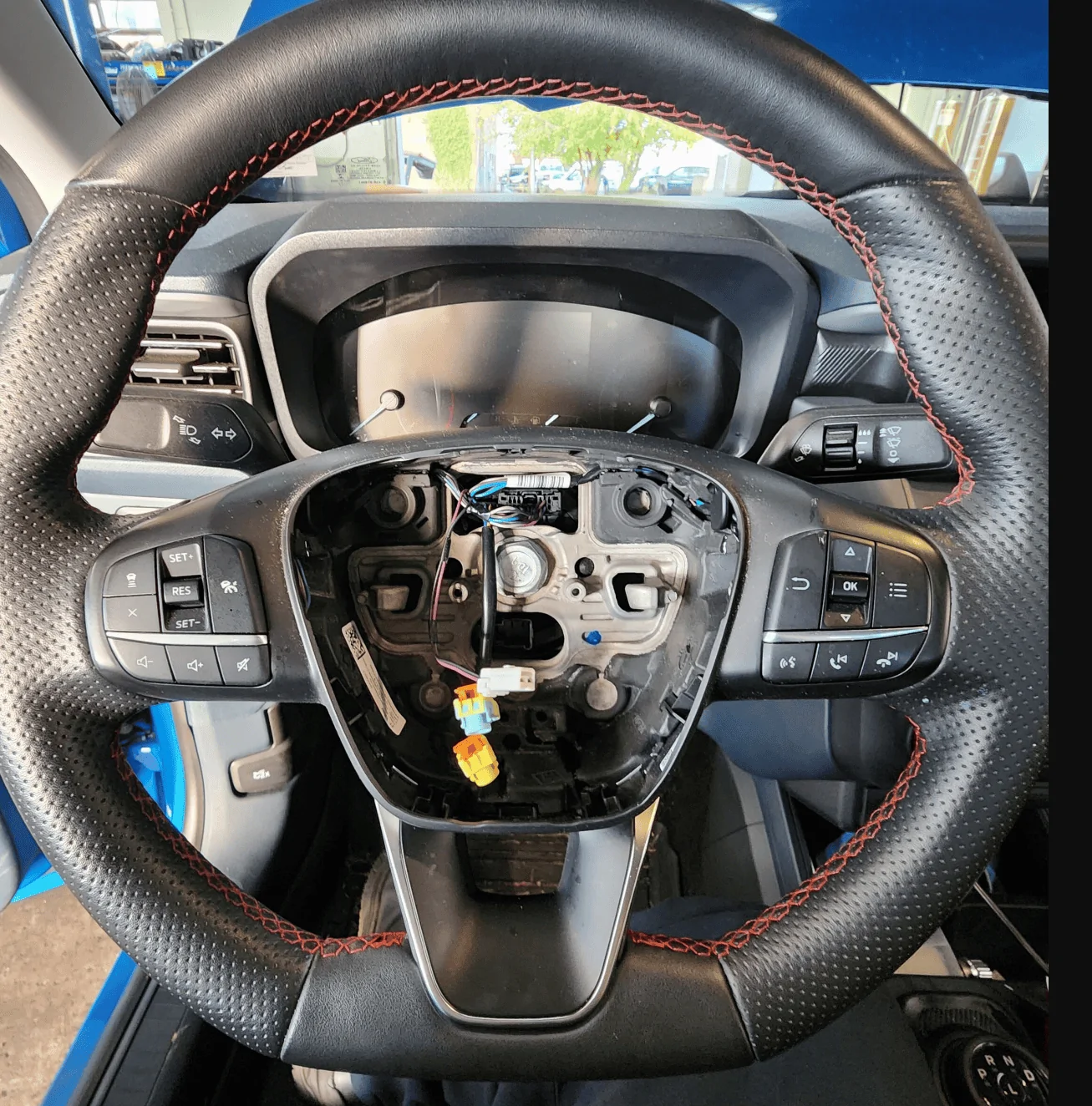

Im adding this because this its the steering wheel i bought. from UK ford Fiesta
Now i will add process . and pictures Start By removing Negative Battery Terminal.

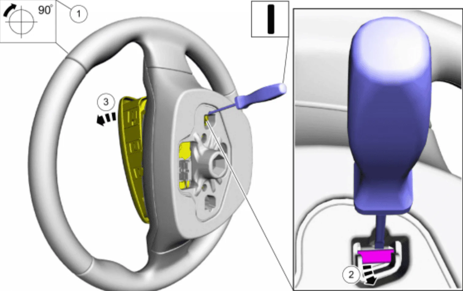

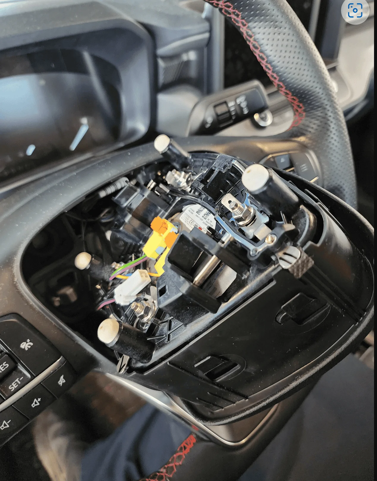

And remove Air bag From steering wheel.

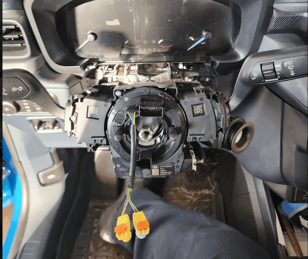

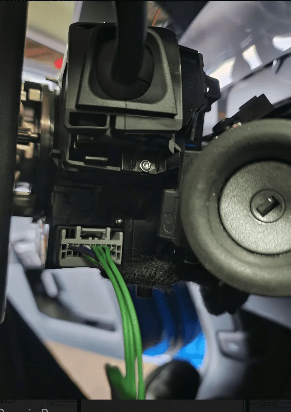

you got to do both sides. once you removed be carful disconnecting the 2 air bags to clockspring connectors . use a pocket screw driver or Pick . just carefully pull clip and press on the sides with your fingers and pull up. first your going to disconnect the white connector of the horn.
once you remove the air bag you should put the wheel straight, remove clockspring connector on top and remove the 24mm bolt so you can remove steering wheel from the steering column.

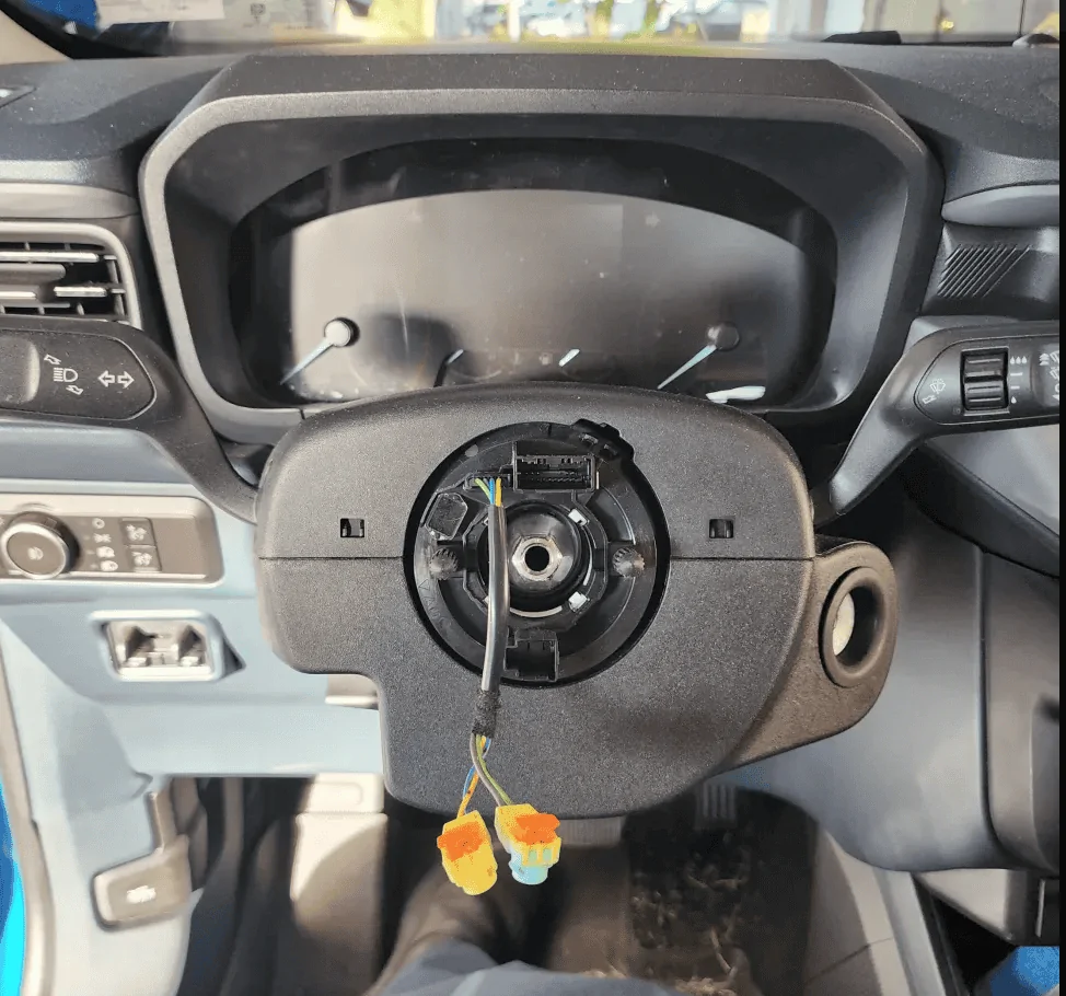

Once you remove the steering wheel you should left like this.
Remove bezel from steering Column 2 bolts on the bottom. be gentle with this as this interiors on the mavericks gets scratch easily you know the drill with mavericks interiors.
Unplug all connectors on Steering Control Module and remove the steering control module 4 bolts you will see they are big black bolts torques t30 or t27 dont remember right now lol apologies. when pulling out be carefully as on the back they have notches that holds it in place.
Once you removed it install the new one that you bought for the conversion and follow the same order but before you install the bezel install the 3 pins and make the wire harness for paddle shifters.
part numbers for connector and wiring its on top.
thats how it should look like when install with ford oem terminals .

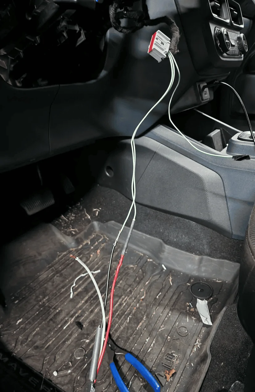

PIN 5 = upshift / PIN 6 = Down shift / PIN 7 = Signal Return needed """

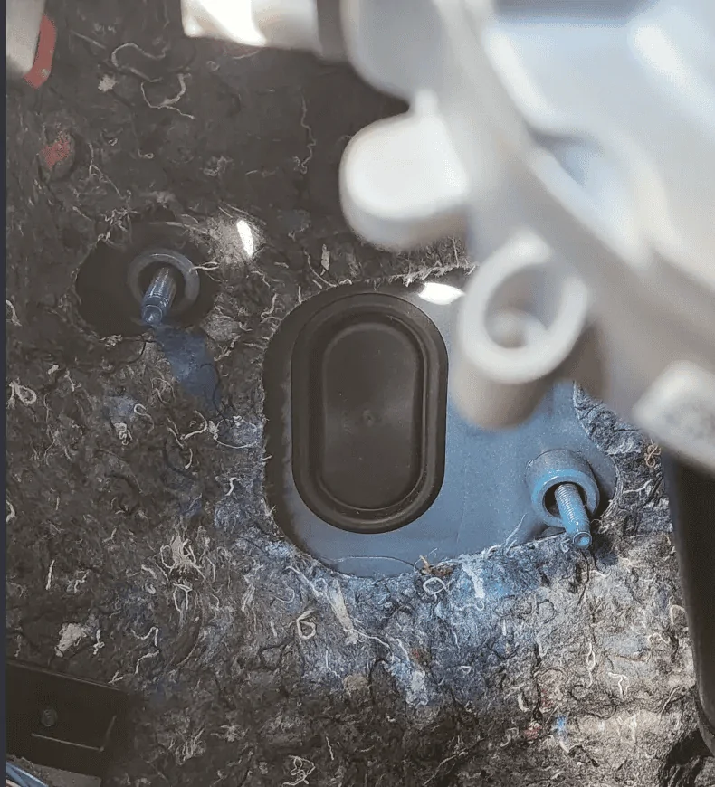

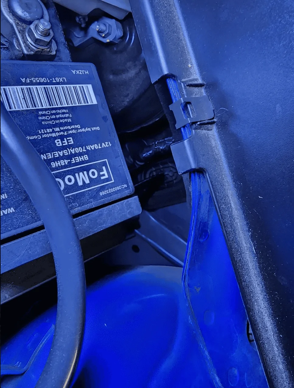

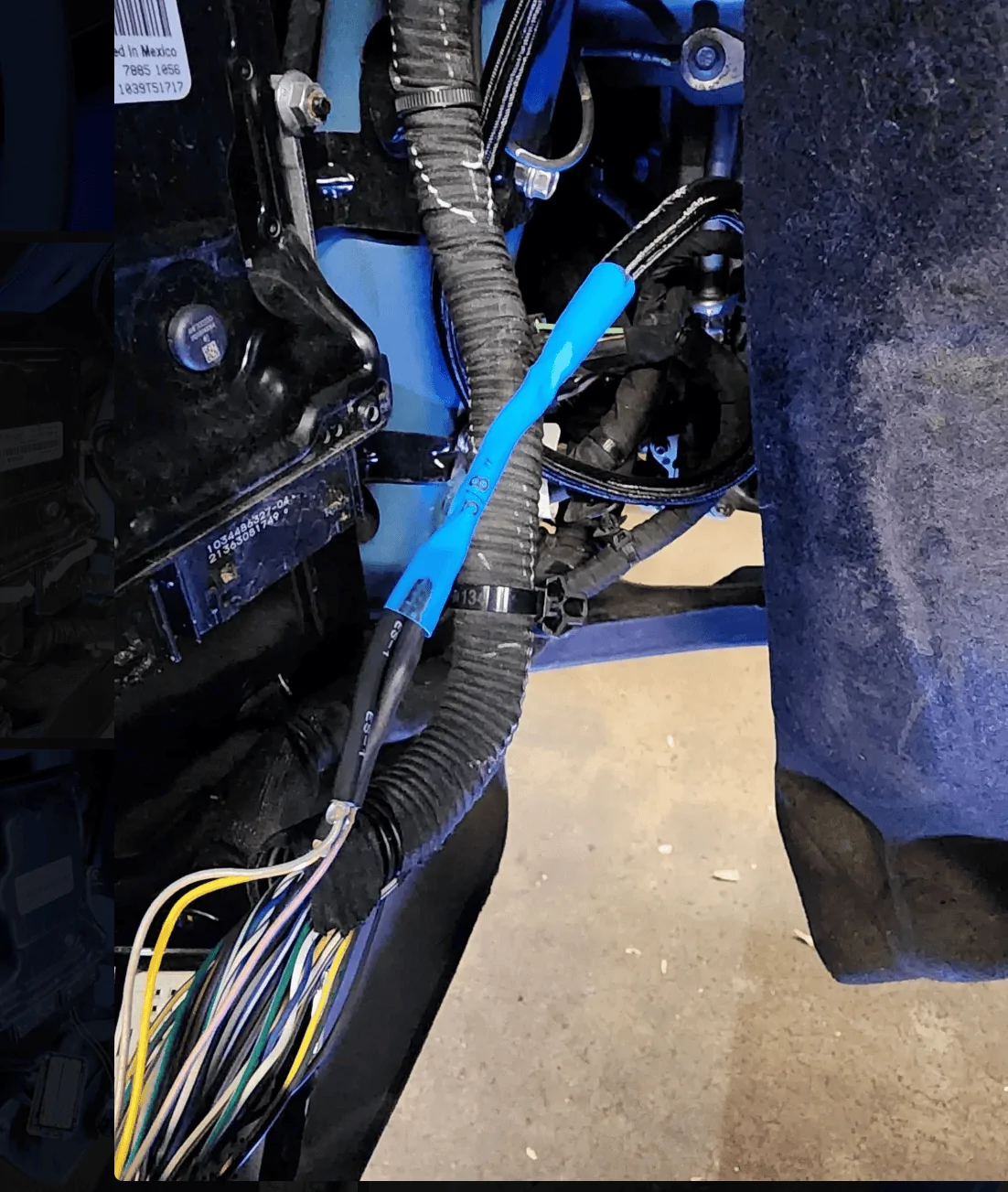

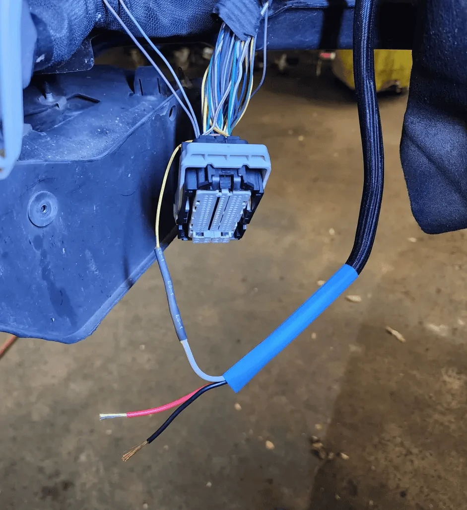

Make A Hole on the rubber by the firewall your going to see a big plugged and pass the wires true it make sure to but insulation on the wires to protect from ambient and rotten.
dont know if you can see the wireloom pass true and the harness i made.

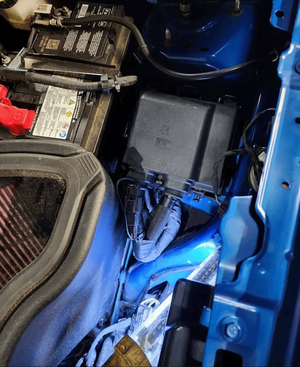

I pull the wires next to the battery and used the whole true to pass the harness to the fender well area . clean and secure cant even find it in the picture. lol

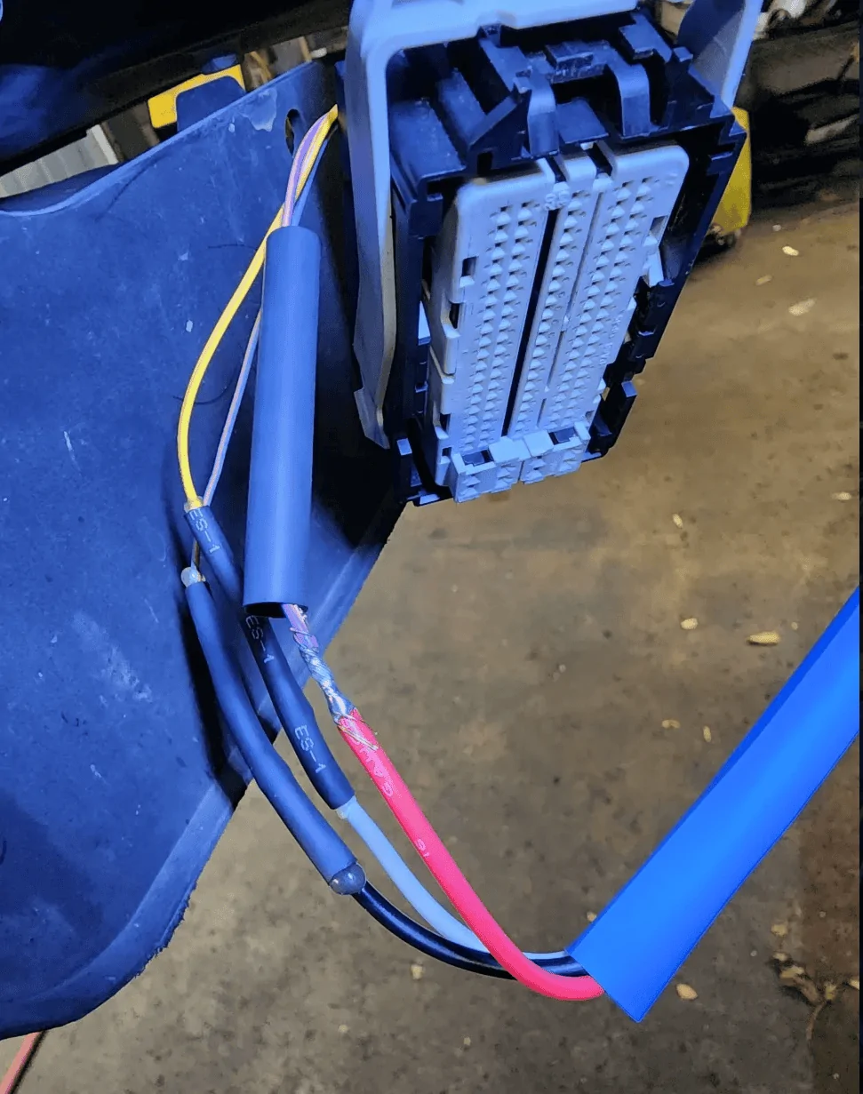

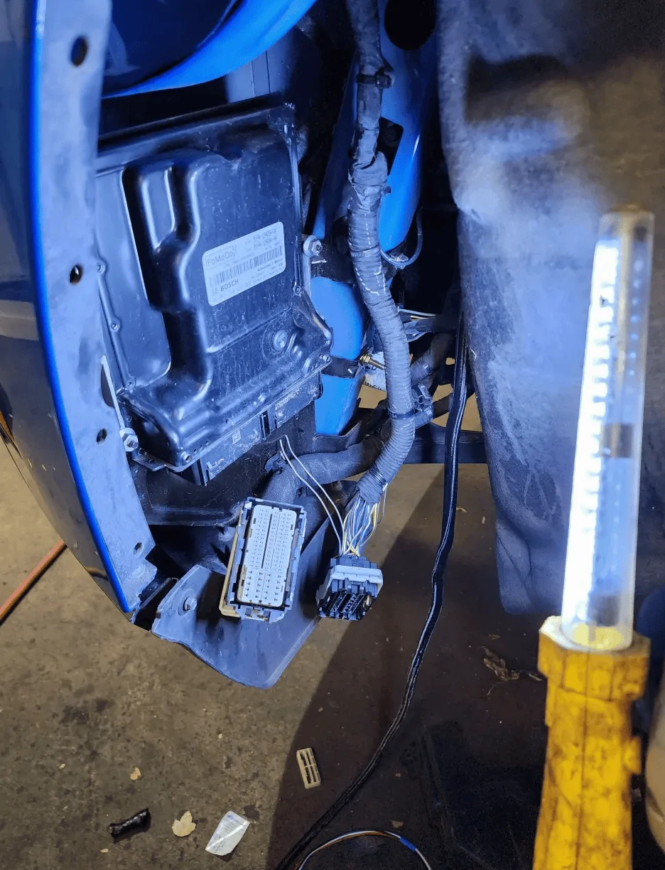

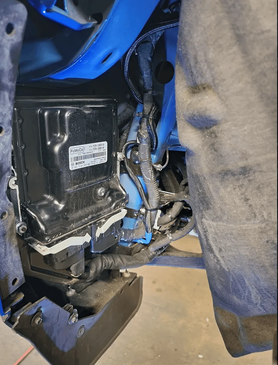

Remove front Driver side wheel and fender liner. and remove PCM dust cover to get access to connector.
remove first pcm connector the first one to the right. remove the tape cut a little bit of the insulation from factory . With care always. remove the top of the connector shield and bottom white pin protector all with care. maximun care when removing or installing terminals. as you can see i added the 3 cables alreay on the connector was kind of on a rush.
heres wiring on terminals your adding to this connector mine did not come with them but on the ford wiring it says some come with up shift and downshift terminals already on the connector be aware.
heres my little hand writing explaining the wire harness i made and the part number for the pcm terminals that will be needed.
Install everything back toghether the same way you took it out. Next i will post Instructions for enabling with forscan. be patient with me.

That oval plugged hole in the firewall with 2 studs going to nothing on either side looks like that may be for a clutch pedal setup that ford decided not to do.
