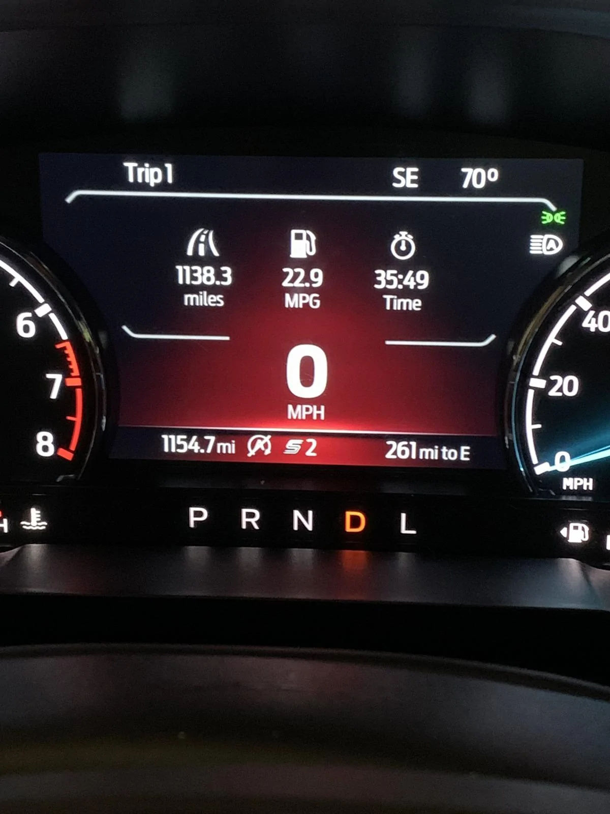

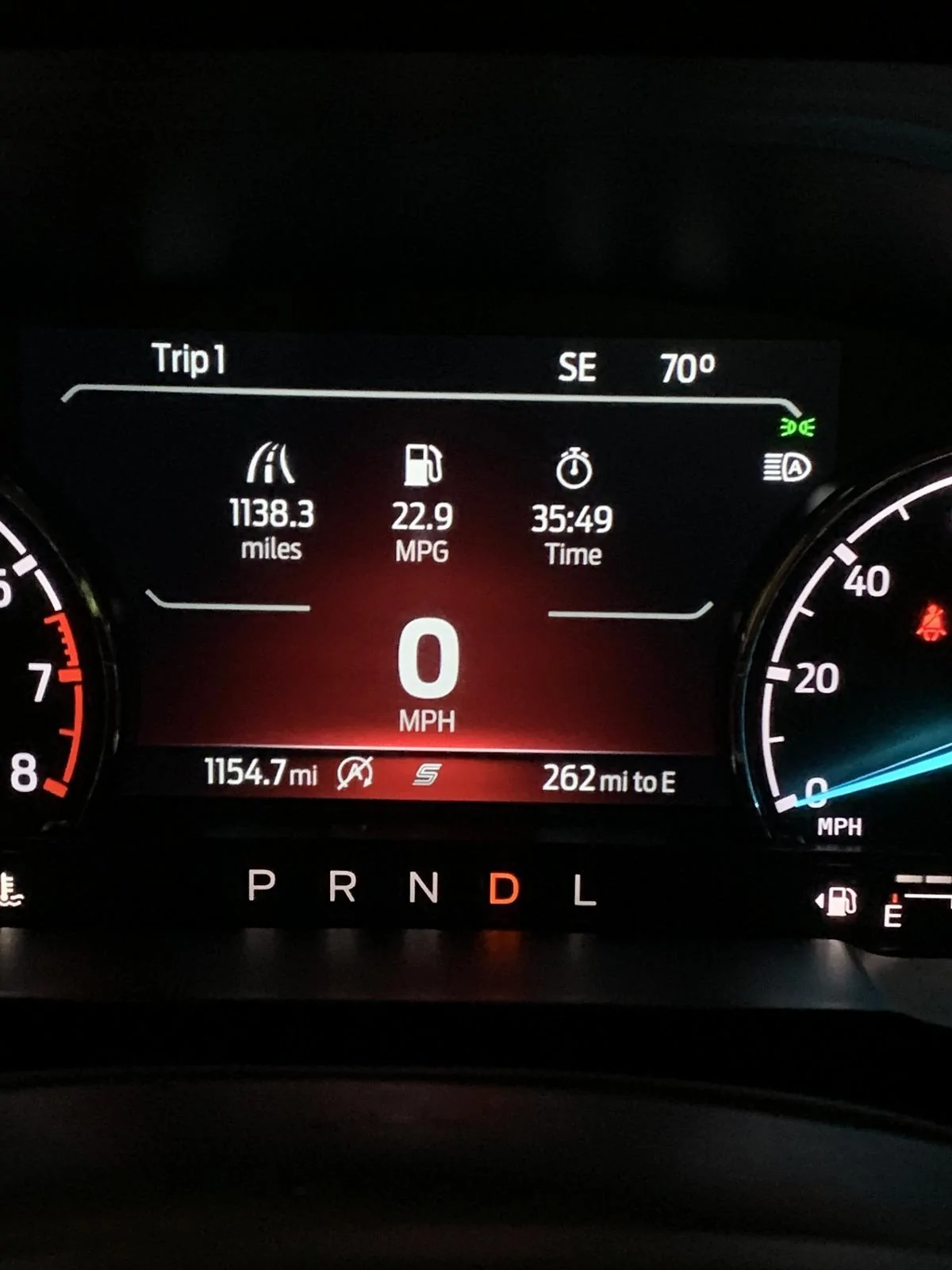

This would be default or automatic shifting with no gear number indicator
Ford Maverick For those who have added paddle shifters, how do they work? thumbnail_IMG_5021
When paddle shifting is active it will display the gear you are in
Ford Maverick For those who have added paddle shifters, how do they work? thumbnail_IMG_5023

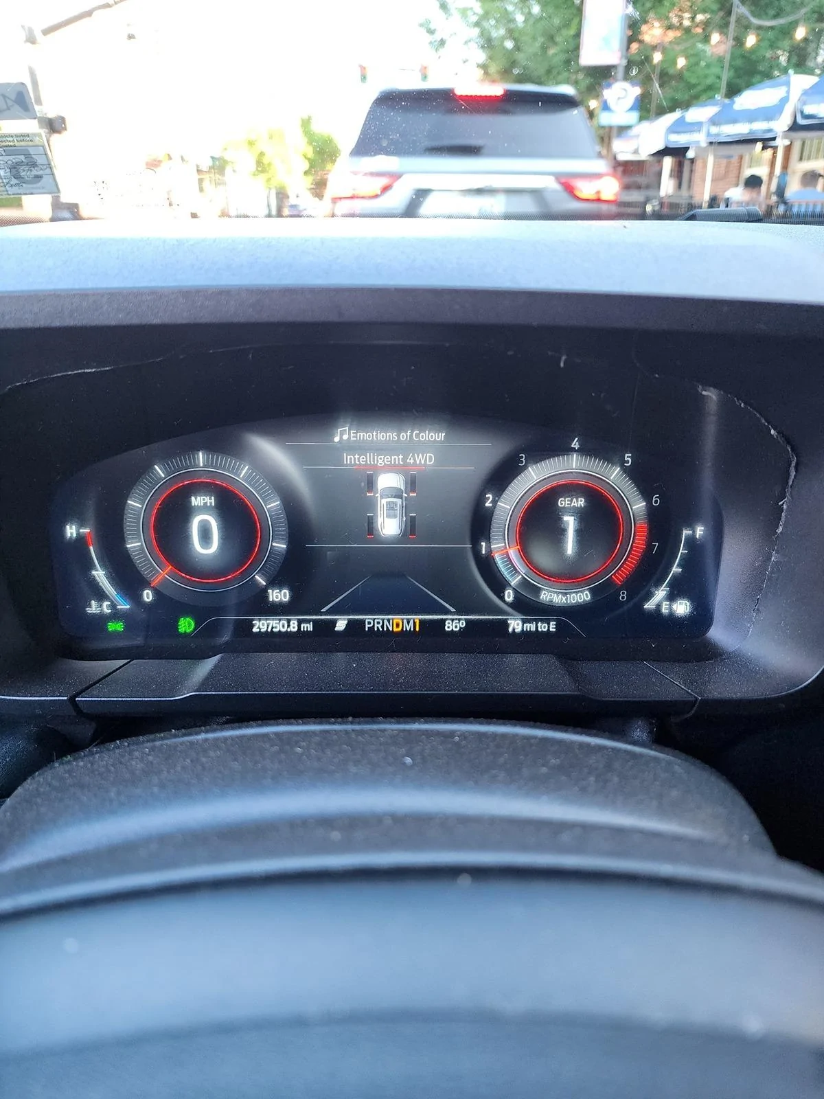

Well someone send me a preview of the Cobb tune with the paddles enable it's shows them on the instrument cluster permanently but I don't know they feel weird. Compared to by old setup with the sct tunner . But when they do enable it count me in I will happy to provide everyone feedback on it.
Ford Maverick For those who have added paddle shifters, how do they work? 20240606_185615
