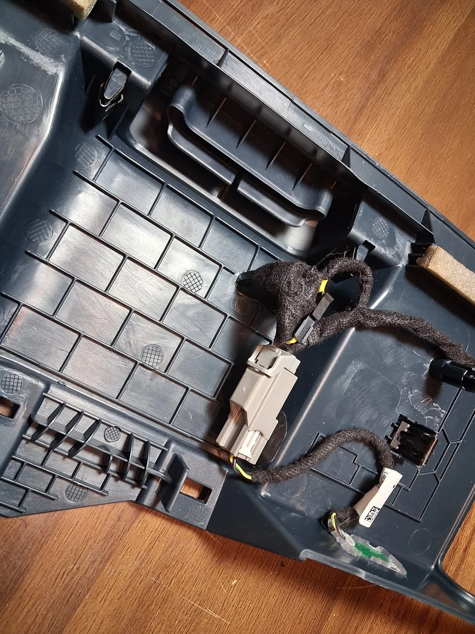

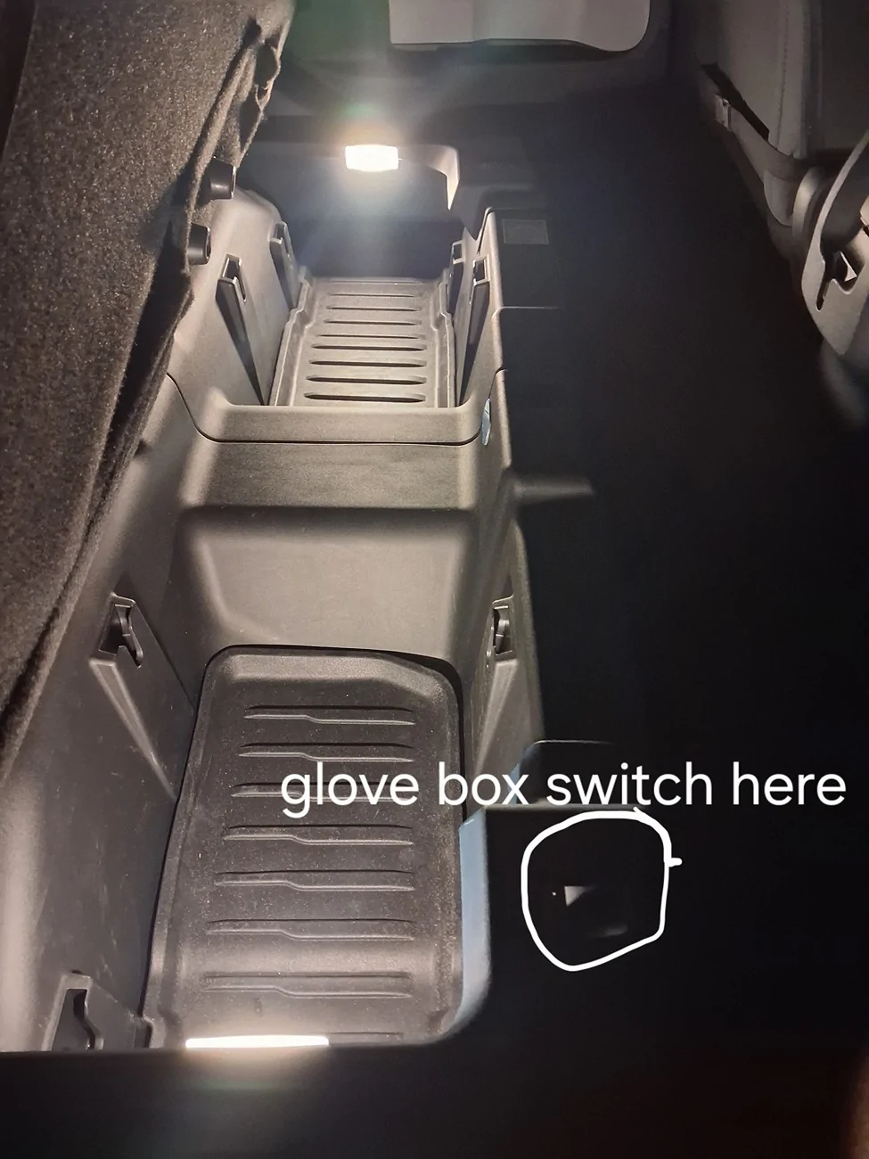

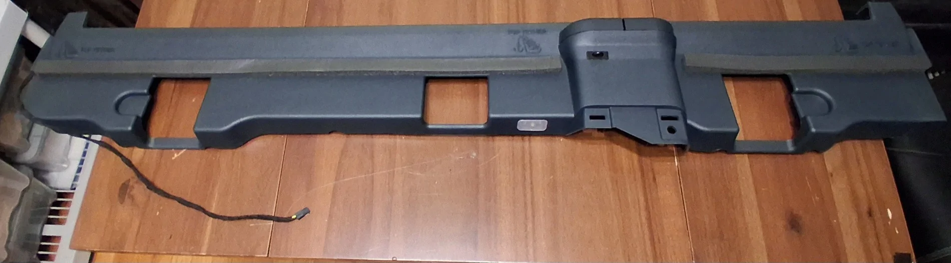

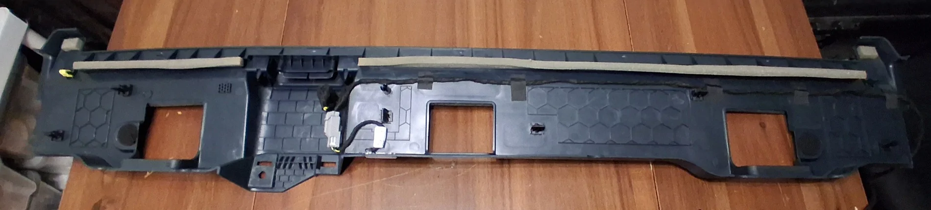

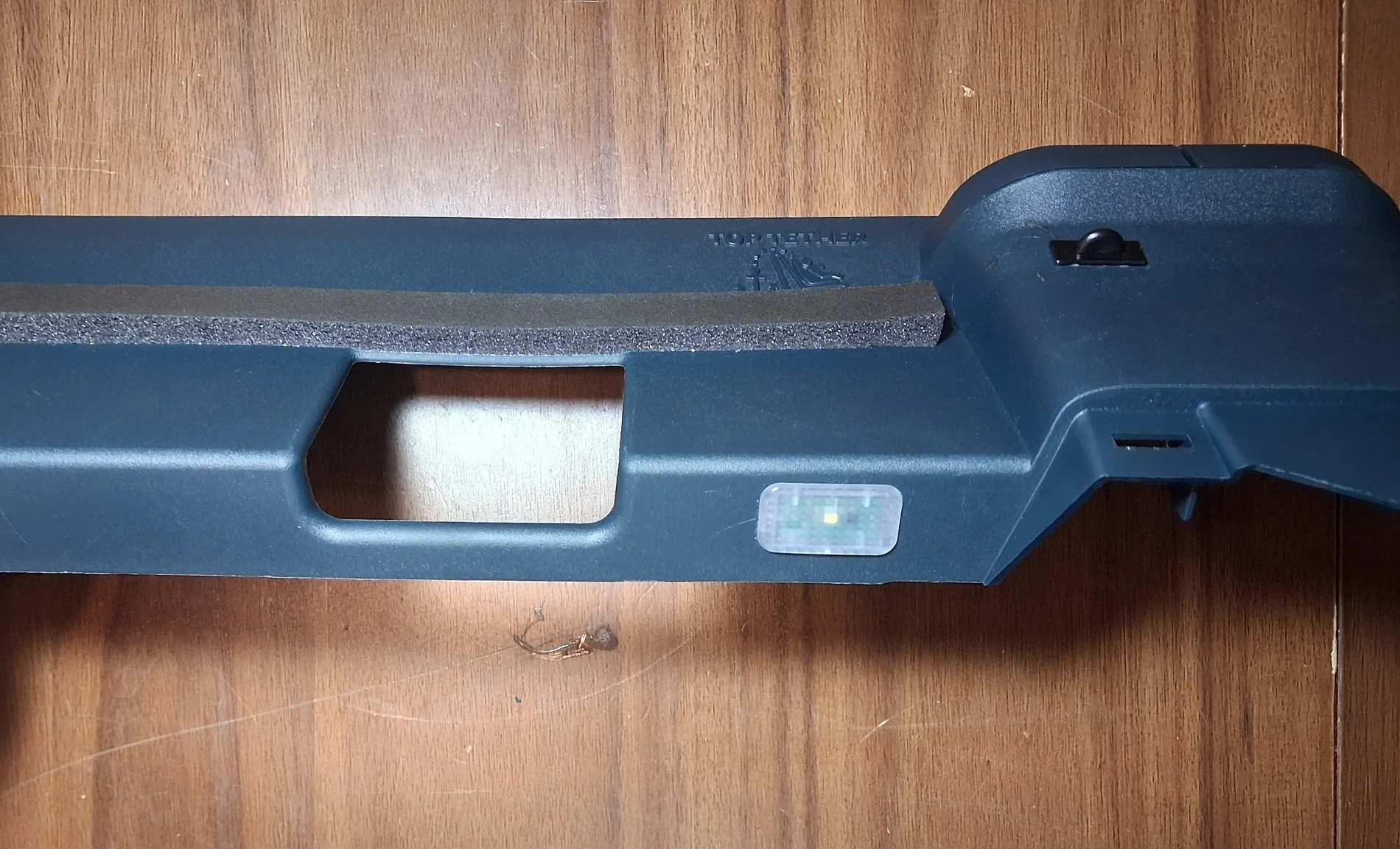

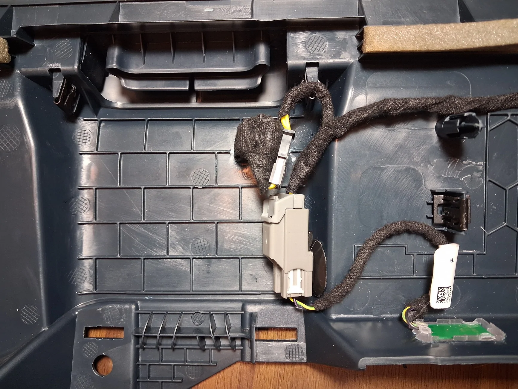

I am the type of person that likes to keep the very bright overhead interior lights off as much as possible. Just because I find they ruin ones night vision just before exiting the vehicle. Because of that I have been adding less bright lighting in critical areas using the DIY glove box light as a blueprint.

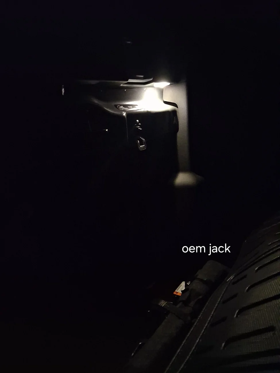

The light output is better than it appears in the picture. It would be sufficient to remove the jack in the dark on the side of the road without ruining my night vision.
I also added underseat storage lights using the KIA/Hyundai switch and Ford Expedition cargo lights. I can provide more pictures and part #s if anyone is interested.
