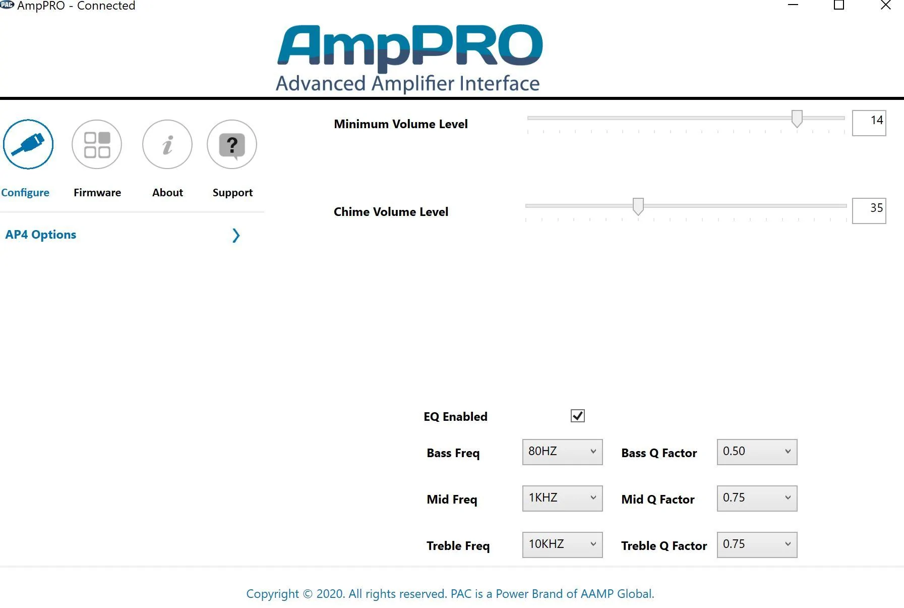

I haven't seen anyone post that has the B&O and got the PAC Amp Pro kit to flatten the curve and keep all the OEM bells and whistles. I had enough amazon points to buy it and just had an install done. This is the configuration screen on the Amp Pro. There isn't a ton you can change, but you can adjust the factory EQ frequency for bass, mid, and treble, along with Q factor. Screenshot of what you get:
Thanks for posting Aaron! I've always been curious about those kits, even though I don't have the B&O system. It looks like it basically changes the bass/midd/high settings to a 3 band parametric EQ. That Chime volume level is a handy thing to have!
I don't know that the kit changes it, it just gives you the option to modify the factory default controls, and the flat signal coming out from front, rear, and sub output. I definitely did use the chime control to turn that down.

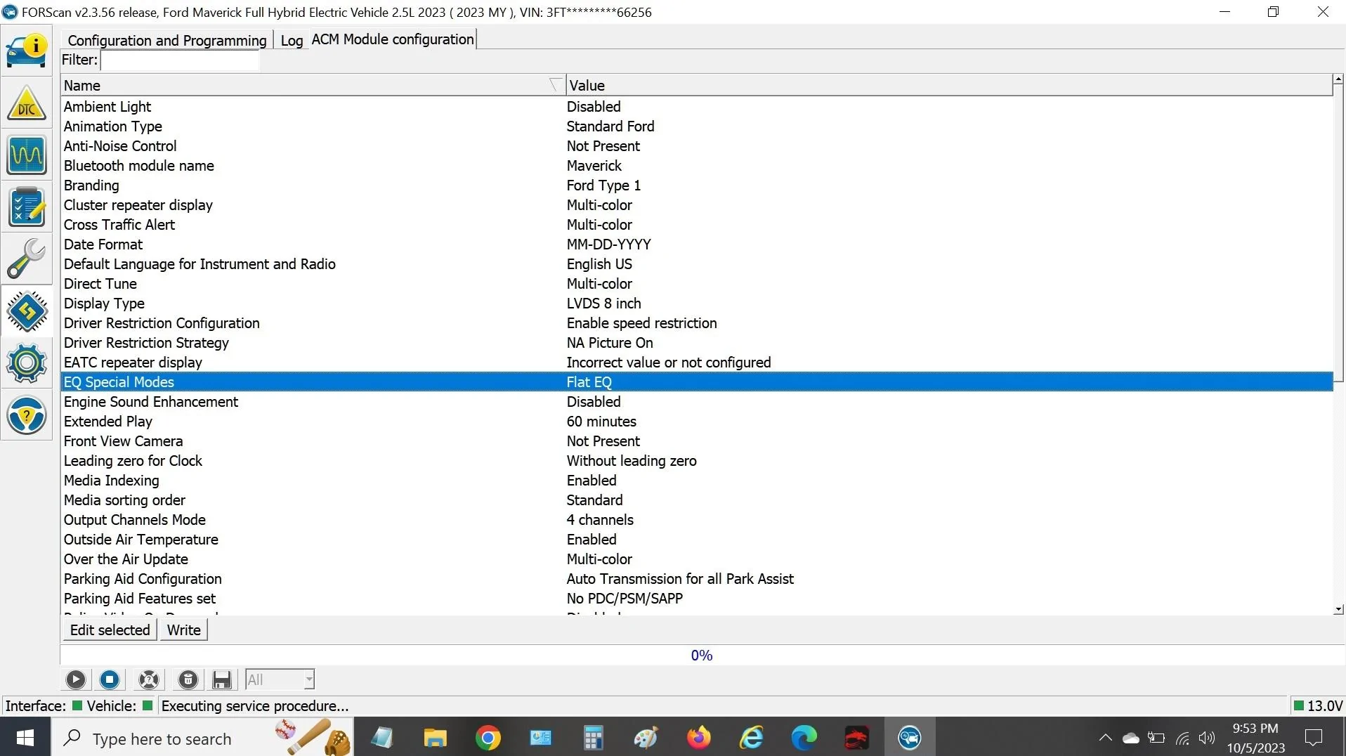

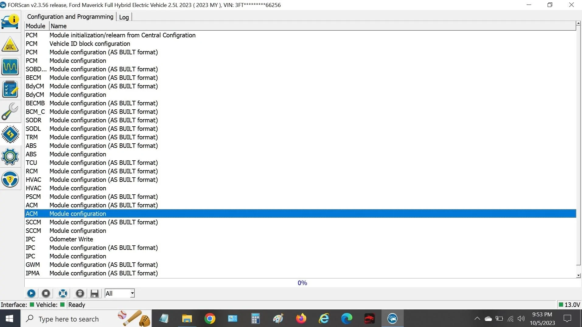

I had a chance to get into Forscan, and there's a EQ mode setting in the easy format without going into the "as built"! I attached pics. Anyway, I can definitely tell the low bass is back and the bass overall sounds normal now!! I ran test tones down to 15hz(for science) and the factory head unit is no longer killing the low stuff. Before, I couldn't even get the slightest sound(or sub movement) from a 20hz test tone, and now I feel it in my chest:devilish: No, it's not crazy loud, but there's only so much a single 10 in a small enclosure can do. The sub is definitely hitting the note though.
I can't speak on if it actually flattened the entire signal or what that signal even looks like now, but it did restore bass to normal. When I have more time, I'll try and compare to my previous settings after I get things dialed back in. I have my DSP getting it's sub signal from the front inputs. I didn't have time to monkey around with the speaker size settings and all that stuff to see if it would give a full spectrum signal to the rears or not. I feel like it would though. I'm using the rear outs from the head unit, but I have them crossed over at 120hz for the 4" rears I have. Now I need a few days of drive time to truly get a feel for the sound, because I don't like to crank it at my house. I try to be respectful to my neighbors.

From my initial listening tests, I don't think it fully flattened the factory EQ settings, but did give me back the low end bass. The reason you want to flatten the factory EQ settings is because Ford basically applies EQ adjustments to the signal going to your speakers(or aftermarket setup), and these are outside of the bass/mid/high settings that are user adjustable. It makes it very hard to get really good sound when installing aftermarket setups. A DSP in your aftermarket system is a must in my opinion. Be it with kicker key options or a dedicated separate DSP that lets you adjust the sound.
