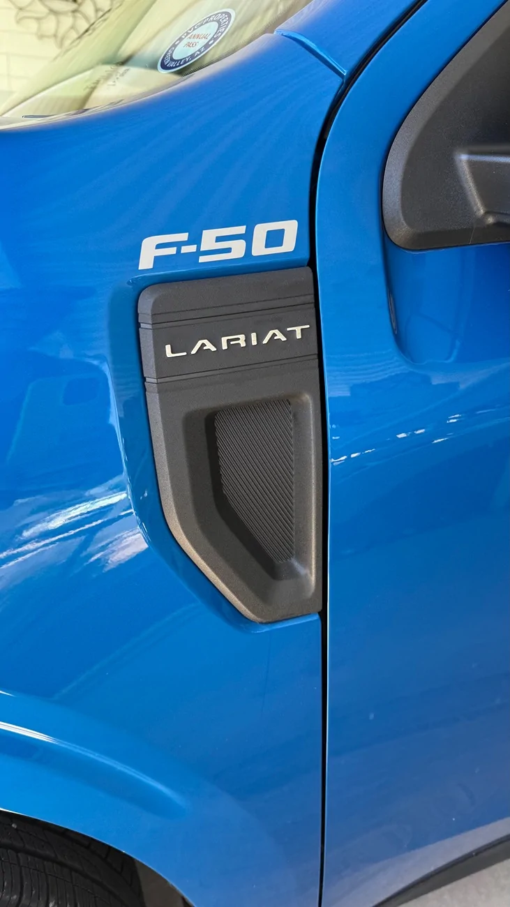

I now have a challenge with making phone calls using my iPhone and SIRI in my truck (2022 Lariat) when plugged into USB, now it's telling me I need to install an additional app, yet I can pick up my phone and make the call and it goes through the Radio like it did in the past. Any suggestions???
Ford F-50? 🤣
