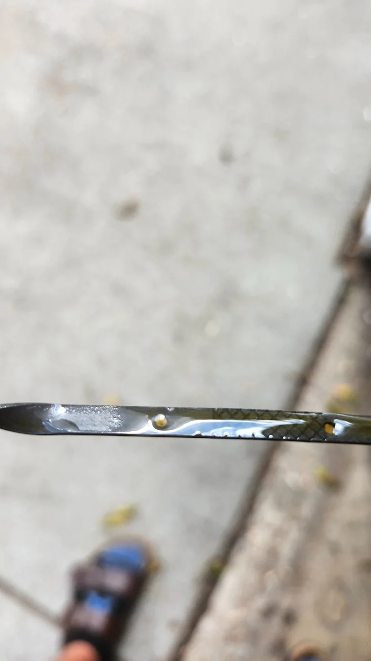

the interior of my Mav Saturday. Afterwards I pulled into the garage until Monday. I decided to check the oil after a recent oil change. I had taken it to a neighborhood shop that I have been a customer of for 9 years.

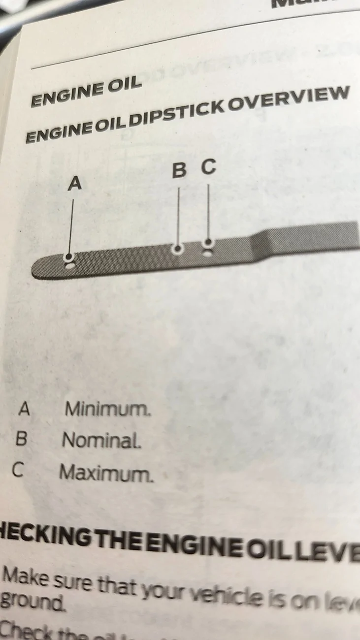

As you can see the oil reads a bit above the maximun level. Every other time I've checked the oil, fresh oil change or not, it has been at the top of the cross hatched, nominal, area of the dipstick.

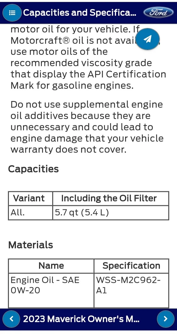

Is this concerning or should I forget about it and be happy for another 9725 miles?

I can't see the top of where the oil goes to in your picture - as in how overfilled is it.
A bit isn't awful, assuming above comment is correct - engineers knew and accounted for potential overfill.
If you've ever heard the sound of badly overfilled while engine running - you could listen for that.
Difficulty for hybrid is someone in drivers seat getting the Go pedal to 65% to kick off the ICE and keep it on so you can listen.

The oil level is above the hole in the dipstick on the left. That hole indicates the max oil level. It shows in the manual, it is above the maximun level marker. 🤷

Your crankshaft should not make contact with the oil level in your oil pan. If it does - it could froth the oil which is not good.
Check your oil again. Wipe it off on a rag. Keep repeating this until the oil level goes down. 200 times? Use the oily rag to wipe down any garden or shop tools:)
Ya, already got that point from 1st post.
2 posts on the point though.
How overfilled potentially?
Really doesn't appear like much.
It's less than the distance from the Nominal to the Max.
Likely fine.

The oil isn't frothy and it has been driven 300 miles or so since the oil change.

I’ve been driving cars and changing oil for over 50 years. Most times when changing oil there’s always some residual oil left in the crankcase/cams/cylinder walls. I just fill to the recommended level. If I go over a little, no worries. I have never blown a head gasket or had any issues. Don’t sweat it.
