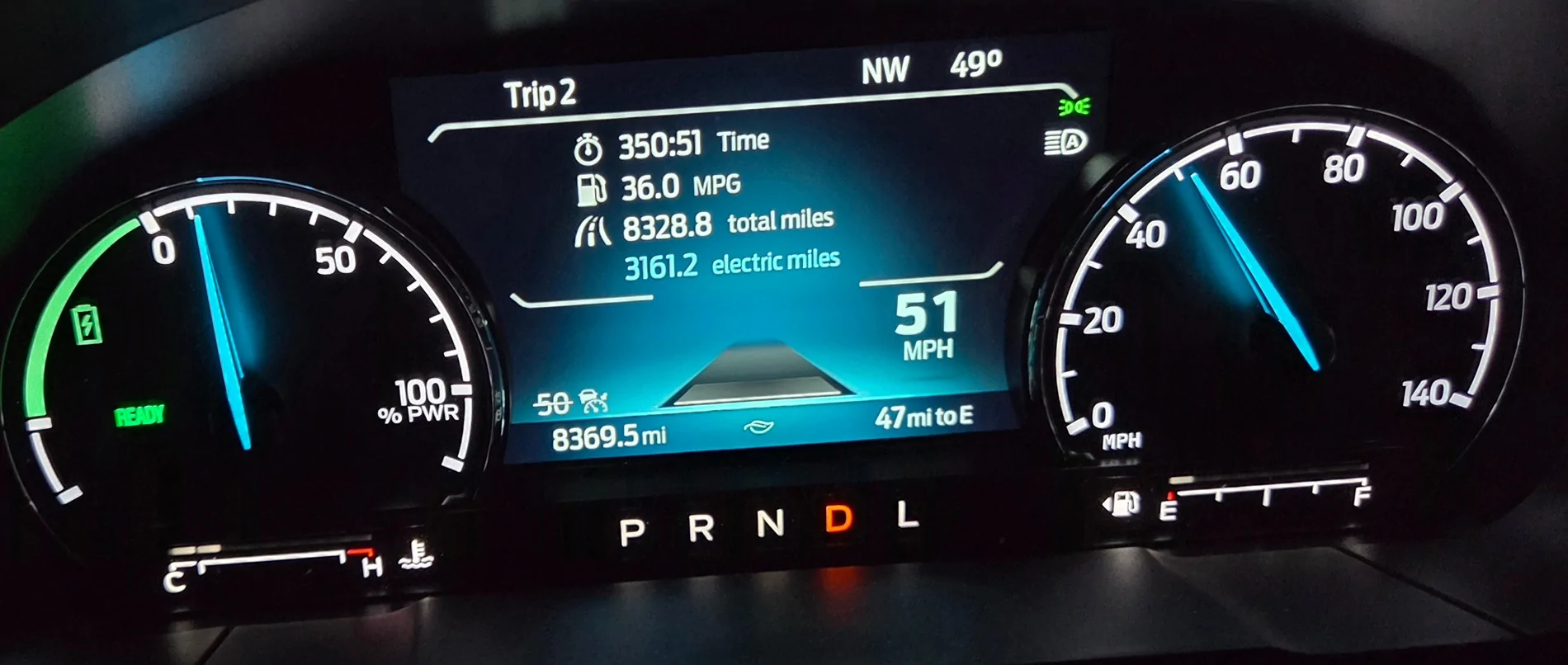

Interestingly enough, I've had a trip meter going since the day I brought it home. I'm attaching some pics here I took a couple of weeks ago while driving to work at 5:30 am. PIC1 (Trip 2) is the trip counter started 40 miles after the truck rolled off.
Ford Maverick OTA Updates causing mileage reductions? 1768763630343-nc

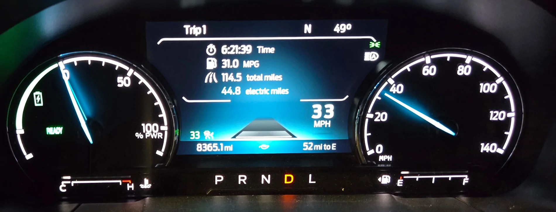

PIC2 (Trip 1) is the trip counter I started a couple of weeks ago.
Ford Maverick OTA Updates causing mileage reductions? 1768763876408-j4

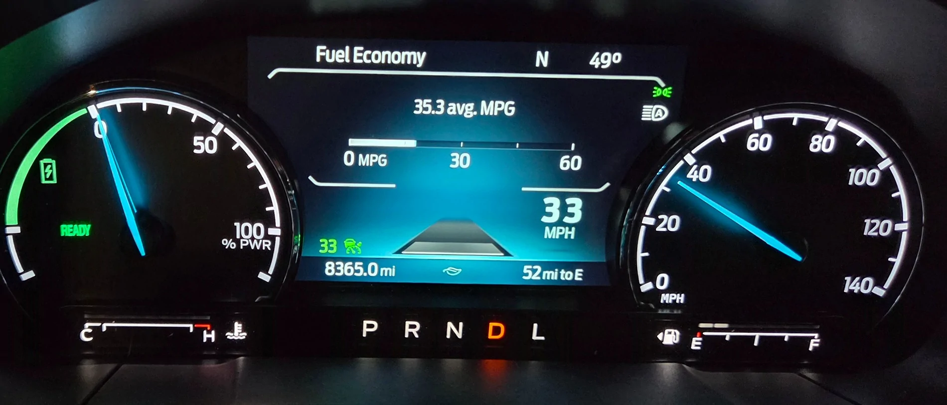

PIC3 is the real time drive. Notice the power consumption (0%) and the MPG slider at 16 mpg, and the overall avg mpg at 35.3. I started noticing the reduction in mpg starting at 37.7 avg mpg on this real time drive screen.
Ford Maverick OTA Updates causing mileage reductions? 1768764124992-av
This is after replacing the engine and cabin air filters.
Keeping an eye on it.

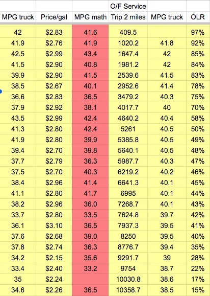

Was searching for the threads where it seemed someone knew how many past miles was used in the calc of the live screen. There was a figure, it wasn't really lifetime.
Memory tad fuzzy if the same applied to a Trip reading that started getting long.
Here's my Avg readings at fillup's (math'd in red) and what the Trip 2 mileage since last oil change is doing. Trip 2 seems to change as expected per Trip 1 readings. (XLT - so no lifetime screen like you have)
I think you can tell heavy highway use and moving into winter, same effect. (2nd to last figures contained in last figures)
Curious on your tad over 5k miles on the ICE - where is your OLM % sitting?
Have you had an oil/filter change yet?
