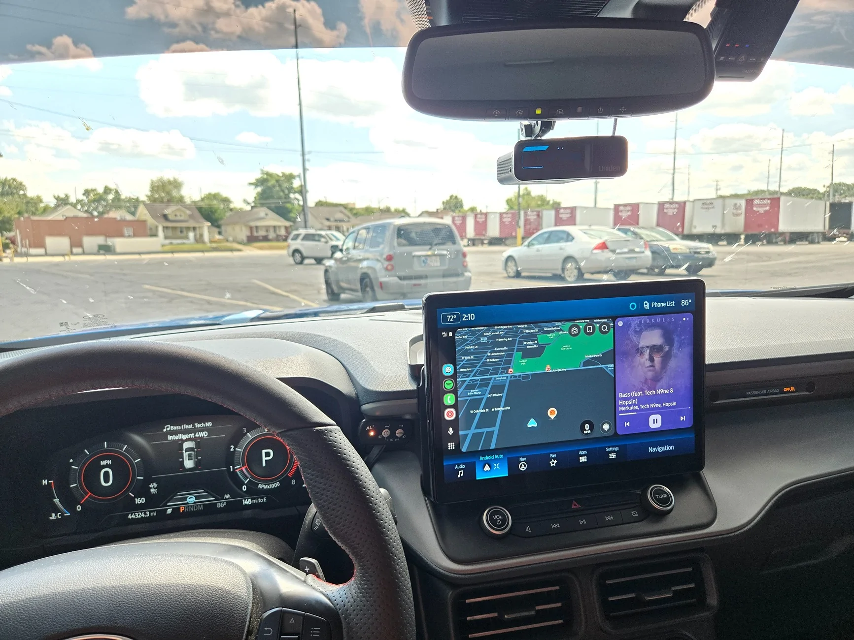

The install only took about 45 minutes but I've had everything apart to swap in a sync 4 apim and then swapped back to sync 3 before. The hardest part on the install is getting the connectors on the apim unplugged. I folded in the legs on the apim bracket to give me some more room to unplug them and then you can pull it out to unplug the apim from the bracket.
The kit itself was pretty good, for the current price though I'd probably look into seeing if itd be cheaper to buy the screen and apim on your own and just get the wire harness and screen adapter from OEMPlus. The cable that goes from the apim to the screen has 2 clips to secure it to the dash but one was the wrong type, so I'm just using 1 of them but they're just a couple inches apart so it's probably ok.
It looks like they do the programming for an XL/XLT. I have a Lariat so I had to use forscan to change a few things, like the screen to change the door keypad code was missing, it didnt show the passenger side temperature, and the HD radio tuner wasn't enabled(still not sure that it's working even after enabling it). I'm still working on the programming to try and get the cards that show fuel mileage and stuff to work but as far as I can tell everything is working like stock now.

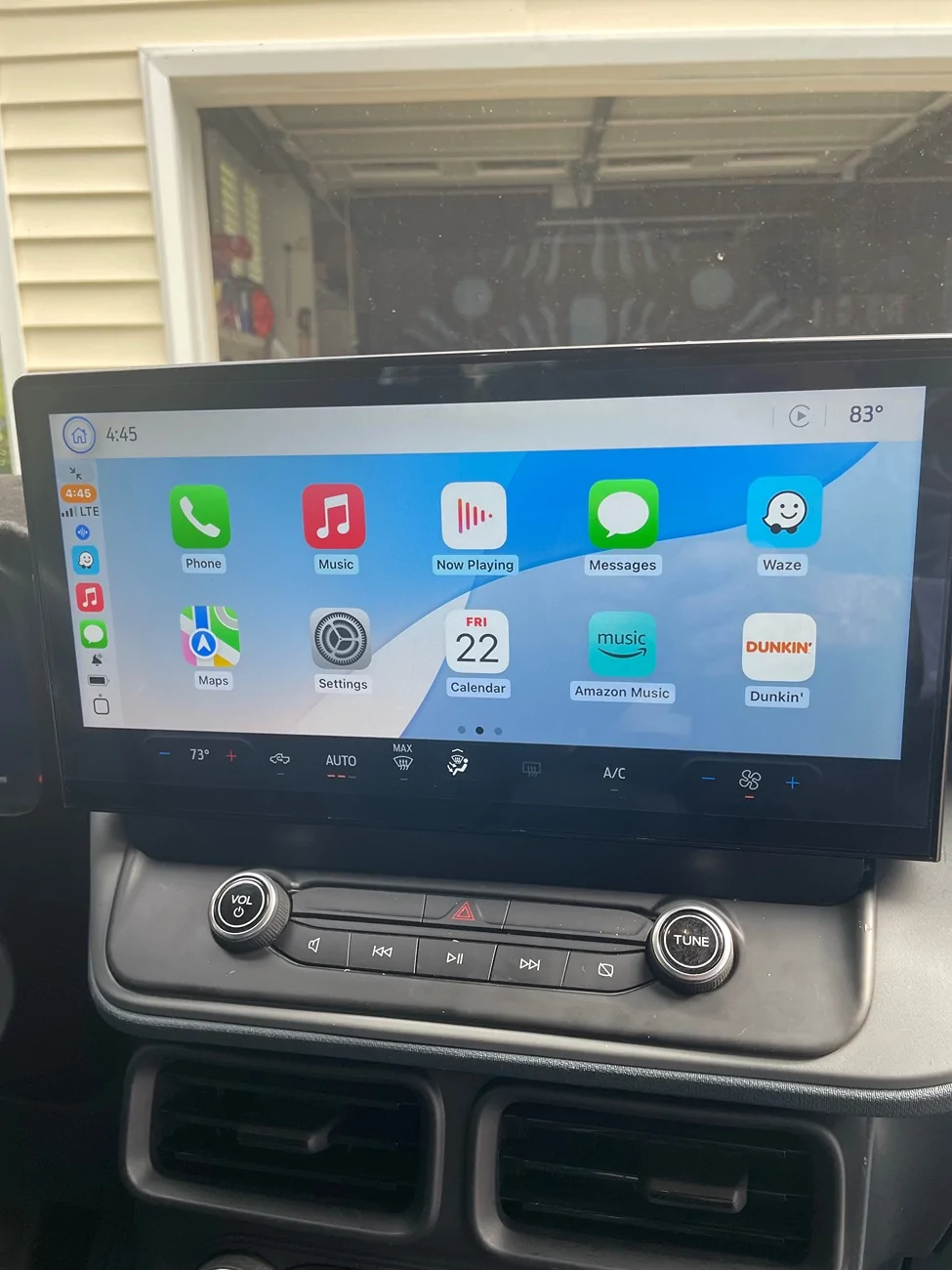

Well update time. Ordered June30th, 2025. Arrived October 24th, 2025. Installed it the morning of October 25th, What a good bit of work removing the old stuff especially the old APIM and installed all the new stuff and......Nothing worked. Just a blank dead screen. So frustrating to wait all this time, spend hours putting it in and to just have to take it all back out again because none of it worked. Looked forward to it for so long made me sick to my stomach. I guess I will have to ship it back and wait who knows how many more months again to get a working unit. Just wanted to let you all know that was following this.
The same thing happened to me took it apart again and re pluged in power cord the plug that has the little lever on it and that worked for me it must have not been pushed down all the way.After that worked great sync 4 is worth the upgrade.Good luck with it but i think youll find thats the issue.

I had that same sick feeling and it was quite a job but way faster the second time yoj can test it before putting it all back together.I was sure i did it right the first time but the plug just was not pushed down all the way. The biggest plug on the APIM.

Wanted to give everyone an update. My kit finally arrived on 10-24-25. Had several things not working which I previously mentioned. Panda concluded it was possibly a bad APIM and sent me a replacement. I installed the screen and new APIM this morning and all previous problems fixed. Everything is working as it should and I am very happy. Panda made good and getting things fixed and getting it worked very pleased to do business with them.
Side not I don't have the passenger side climate temp displaying, there is a box where it should be but no number. Has anyone else had this issue and now to fix/enable that. I feel it is probably a simple FORSCAN fix and I thought I ready someone post they had this minor issue and fixed it with FORSCAN.
