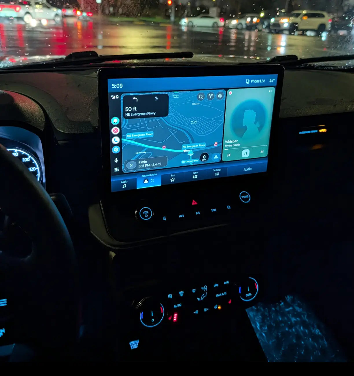

Yup but I went from lariat lux 8" to 12". Love it. It significantly improved the wireless connection speed over dongles.

How was the install process?
It was super easy until dealing with the APIM. It has 4 different wiring harnesses. The first one you have to do has an incredibly short leash on it. You essentially have to do it blind. I took photos and videos of it and found a video of the same connector online to see how it releases. It has a hinged design. Once that one is done it gives you some slack to see the other 3 harnesses. You will want needle nose pliers for one of them.
