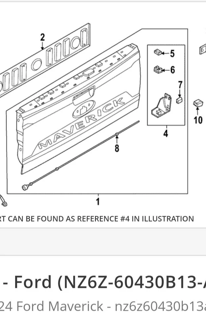

The safety bracket on the passenger side of the tailgate. This is a diagram showing it, got it from another thread. I could probably bend it back into shape by hand but I might end up breaking it entirely.

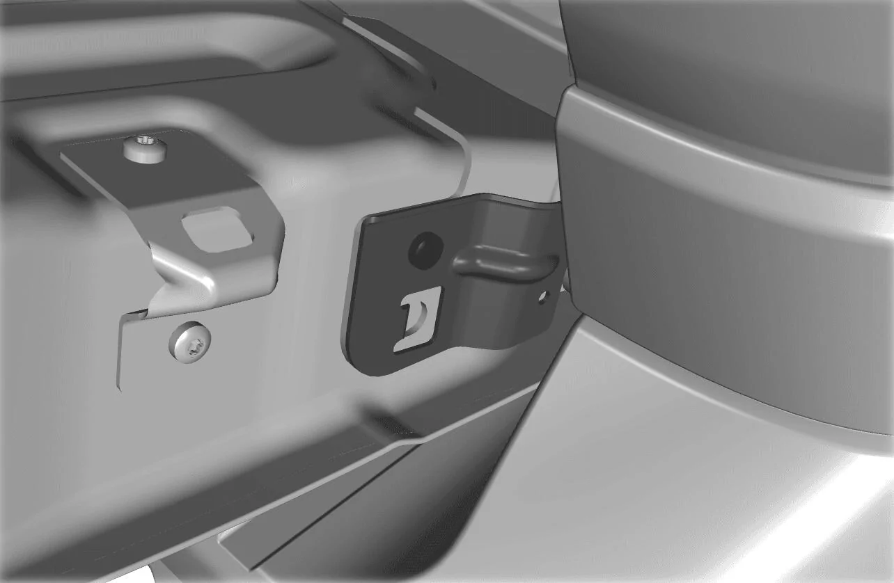

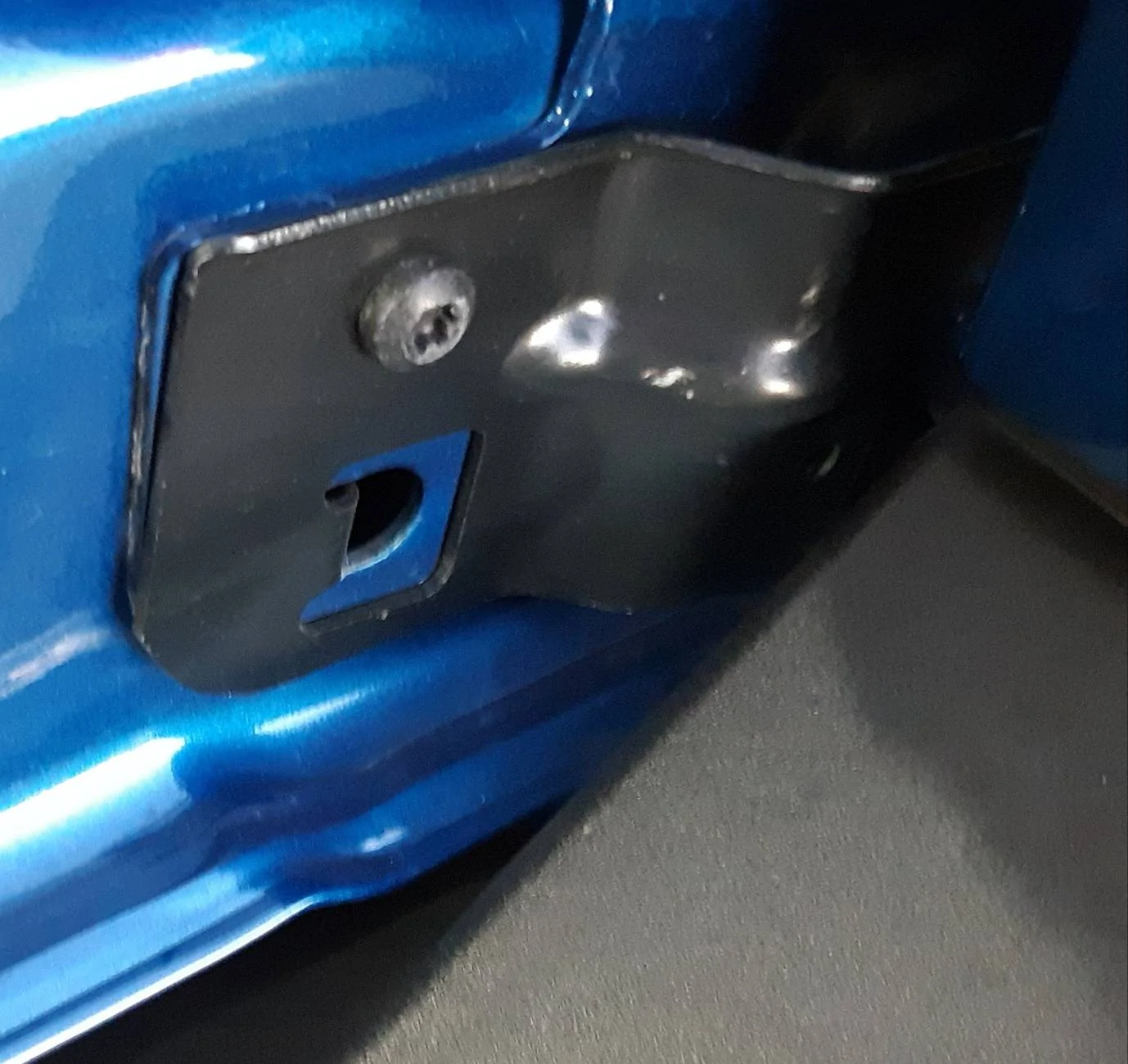

Maybe ?
Could that be the bracket contained in #4 ??

That is not what this bracket is. You're describing the optional tailgate lock.
It is the safety bracket that prevents the tailgate from lifting out. It has to be removed to install the anti theft tailgate lock. The safety bracket can be replaced/ augmented with the anti theft tailgate lock or with a hose clamp. The anti theft tailgate lock is just harder and takes longer to remove than the safety bracket which is solely there to prevent tailgate from bouncing out. Either or both can be used. Depending on bend in safety bracket it might be straightened enough to work.

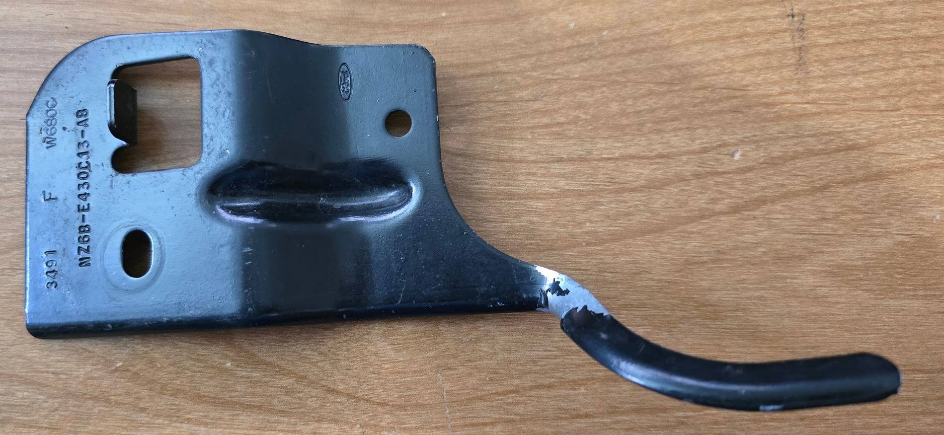

I suppose if the tailgate was cabled in the "mid" position and unloaded you could bounce it out of the socket with a rough ride. Hammer it out the best you can til it can be replaced, you're not going to destroy it. They generally don't make stamped steel parts from brittle metal.

I may just leave it off entirely. Definitely leaving it off for now. But it's...bent.

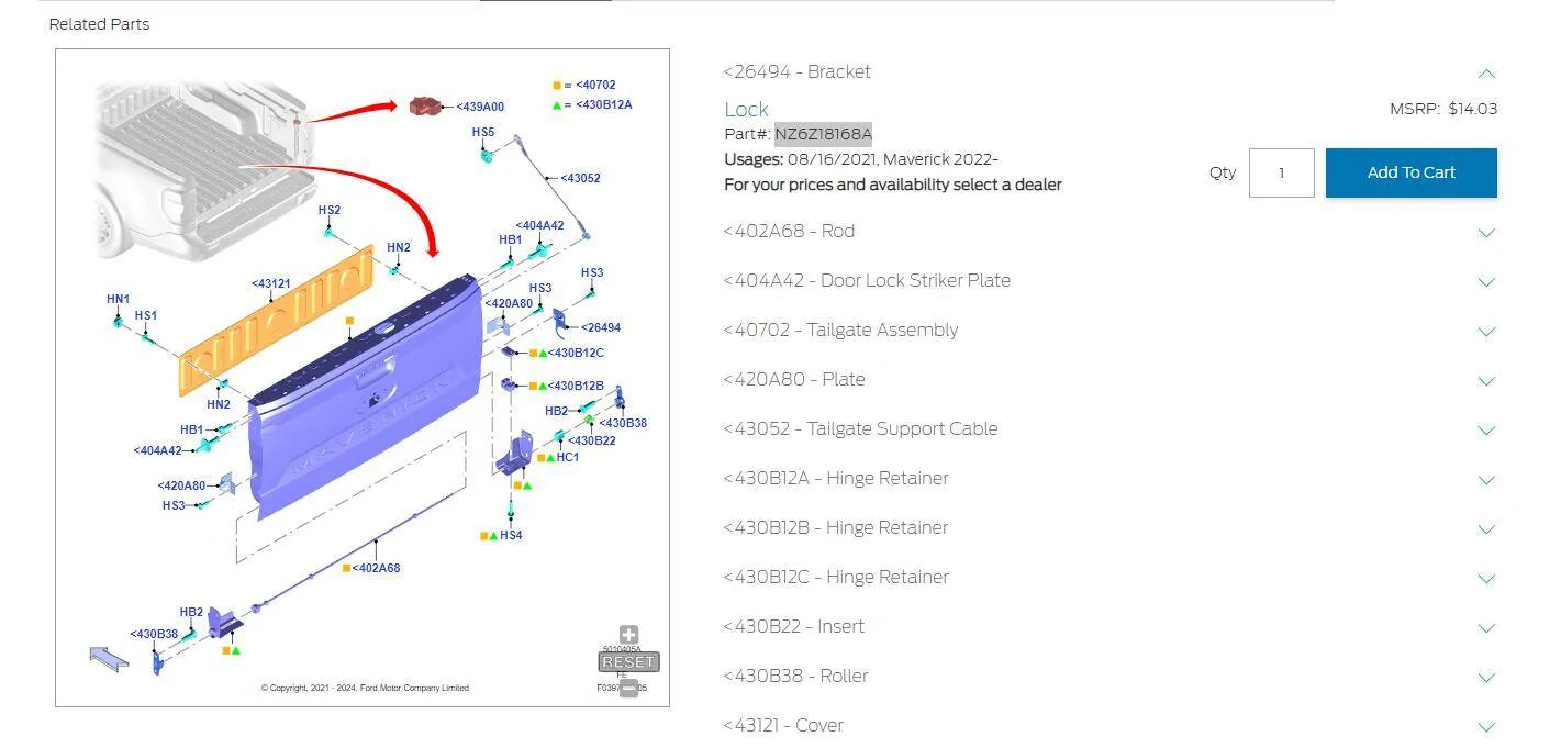

the number on it does no good, but pretty sure this is it:
Ford Maverick (Not very) Safety bracket for tailgate 1729016317363-rj
dealer should be able to get it for you for less than I could mail mine.
