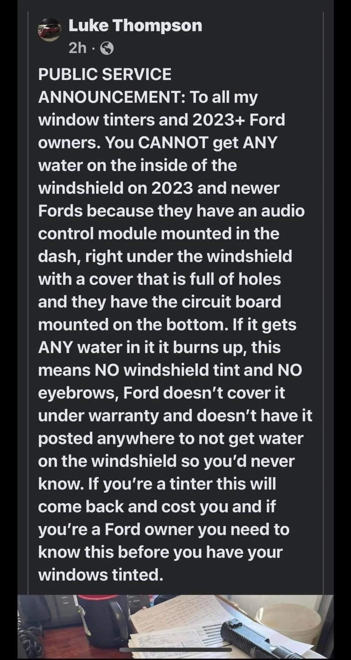

I was planning to get clear ceramic tinting all around for heat & UV rejection.
Dropped off the truck this morning and just got this update from the shop.
Anyone know if ther is a workaround for this?
I live in a desert and the heat & UV rejection is something I direly need
Ford Maverick NO WINDSHIELD TINTING 23+ Ford models IMG_20230413_104055

For what its worth, I also did the windshield on my Maverick. I doubt there is actually any difference in module location on my 22 vs a 23 model.

Why cant they just put something over the dash to catch any water...seems easy enough

Had mine tinted, no issues.

My '23 is tinted, and we tint a lot of other Ford windshields in our shop. We use the soak rope at the bottom to catch the solution and we are good to go. Find another window tinter if they won't do it.

I have a 2023 Lariat and had the windshield ceramic tinted and also had the eyebrow done. No issue so far and was never told not to.

That’s probably a CYA move by Ford

I'm going to steal that Facebook post/image and put it in one of the Facebook wrap/tint groups. They are going to get a kick out of it. It might already be in there.
"OMG........water cant touch the dash......there is literally NO WAY for us to tint a windshield under those conditions!!!!!!!!"

Am I to believe that a major auto manufacturer is going to void warranties on every tinted vehicle for EVERY model for EVERY year going forward?
