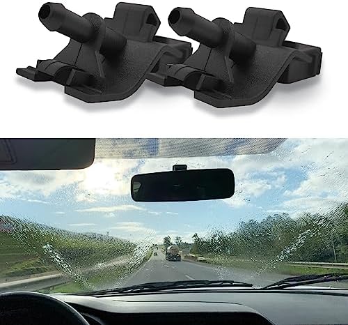

So Our Mavs dont have the nice quick disconnects (At least my 2024 Lariat doesn't) THey seem to be shrink sealed to the nozzles. I for the life of me cannot get them to disconnect from the hoses.
I guess I will have to cut them off and buy new hoses and redo the lines.

I was just being dumb. THe nozzle is not shrinked to the tube. It was easily removed. Thank you for the information!!!!!! Fixed my issue. Thank you again!
Turn the little black band and they release then put new one into hose and turn the band back to lock it together.

getting the nozzles back into the hood is a bear. Maybe I'm doing it wrong, but I've yet to see any instructions or video of how to put them back. Mine are clogged, and I've ordered new FORD OEM parts to replace them. I did remove the old one to attempt to blow them out, but issue of just tiny output persists.
Any advice on how to get the nozzle back into place in the hood appreciated.
