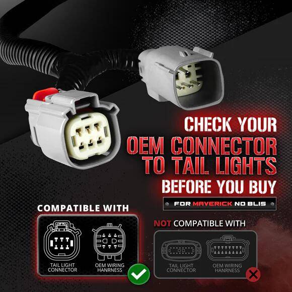

It is going to be a different type of plug because of the CoPilot 2.0 in the Lariat from my understanding. The CoPlilot 2.0 is going to have the longer ones with the red X as shown in the image.
I agree DJ once OPT7 told me their solution wouldn’t work on my 2025 Maverick because of the reasons you listed I decided to stand down unfortunately 🤷🏼‍♂️
