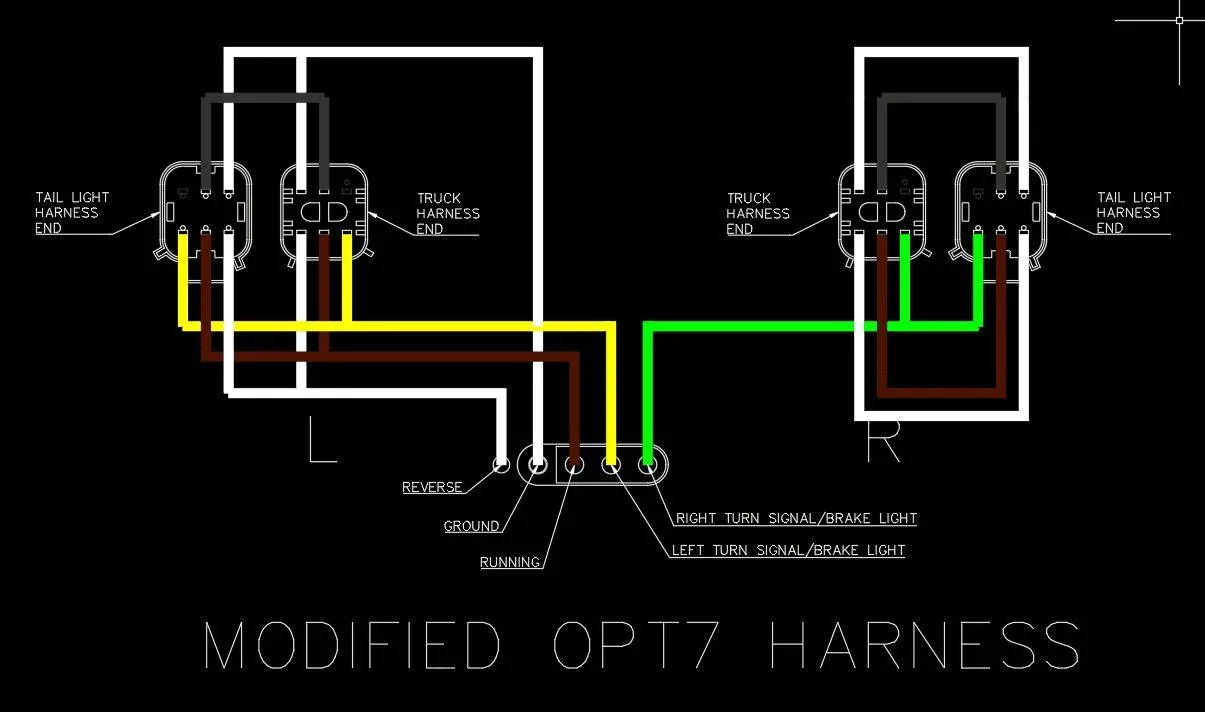

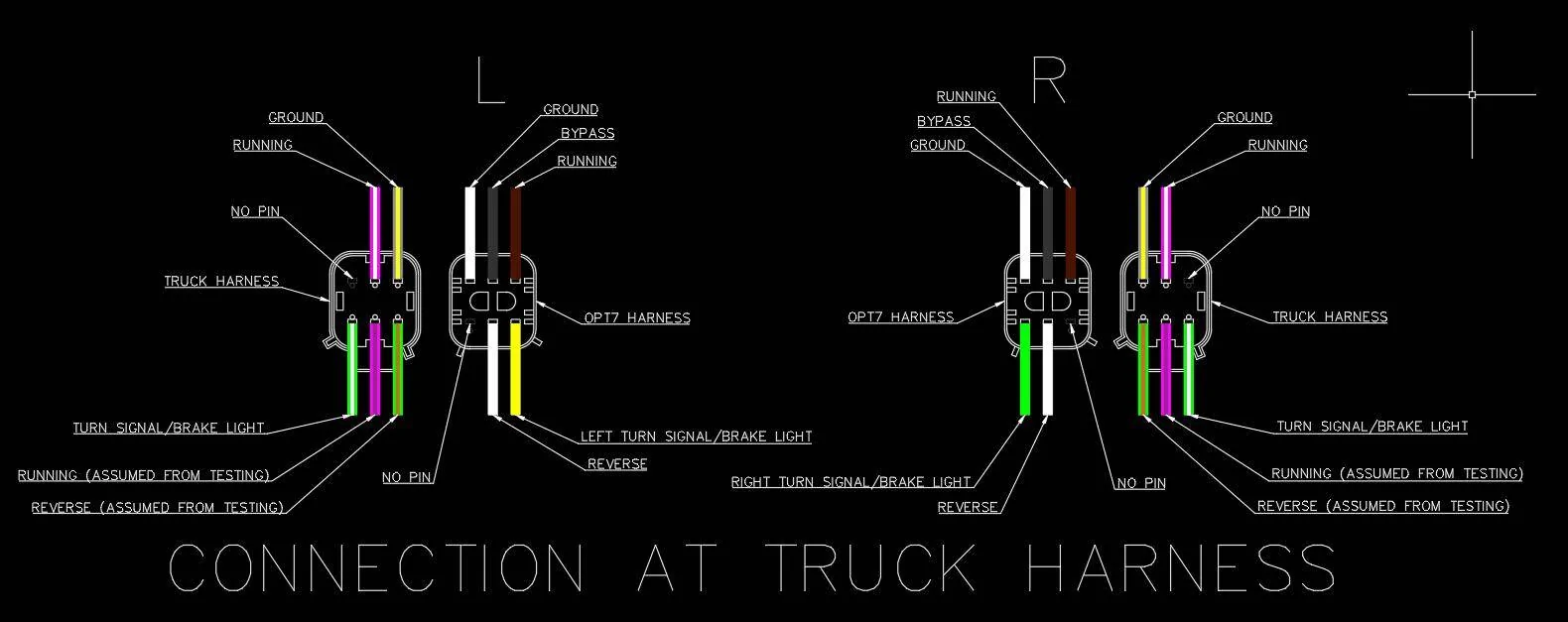

OPT7 Harness looks like what the F150 harness Dmat used that now has the correct pin wiring for the Maverick:
Ford Maverick Nilight plugged in to hitch receiver 2025 Maverick Modified OPT7 - Dmat
Ford Maverick Nilight plugged in to hitch receiver 2025 Maverick Maverick Truck Connections - Dmat

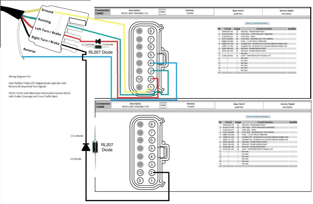

I'd wondered if the OPT7 harness had diodes in it like some F150 owners had to add to try not disable BLIS features, but doesn't look like it does:
Ford Maverick Nilight plugged in to hitch receiver 2025 Maverick 1745791684375-0

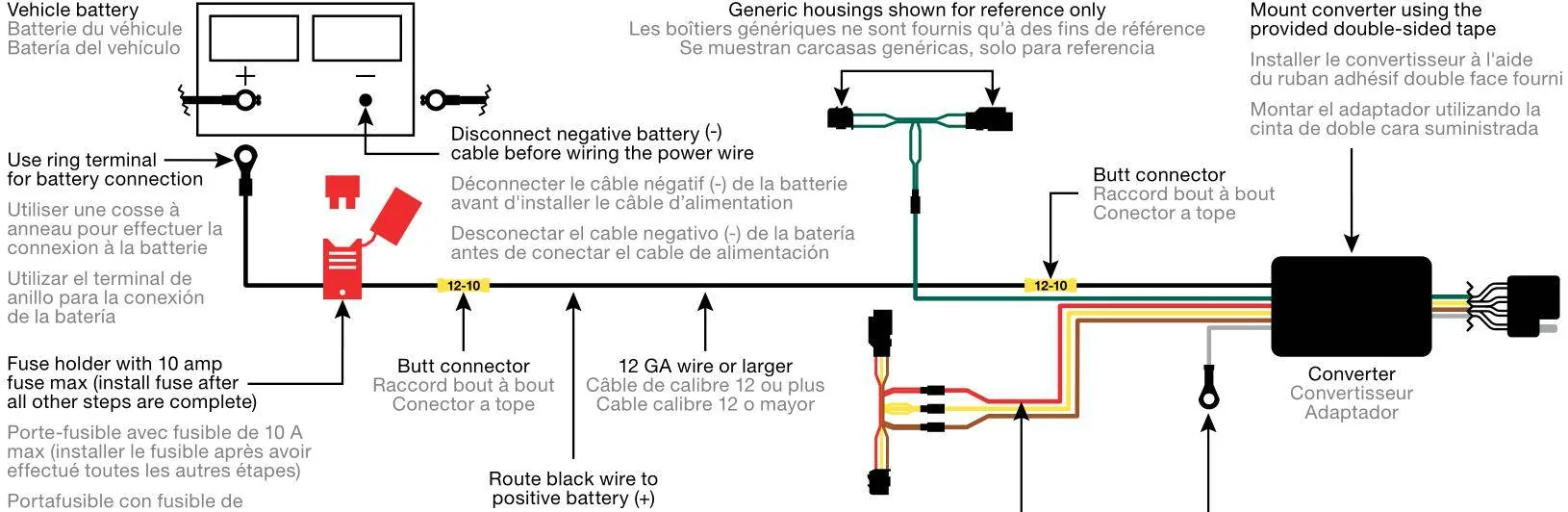

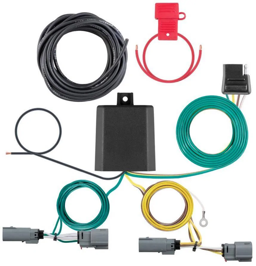

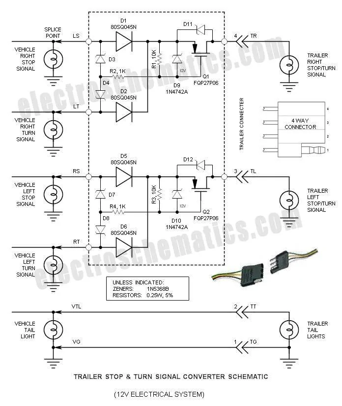

The Curt 56577 Powered Trailer Adapter looks to use MOSFETs to drive the Lights w/o loading down the BCM tailight outputs.
Probably Curt's circuit is something like:
Ford Maverick Nilight plugged in to hitch receiver 2025 Maverick Trailer-Stop-Turn-Converter-Schematic-2

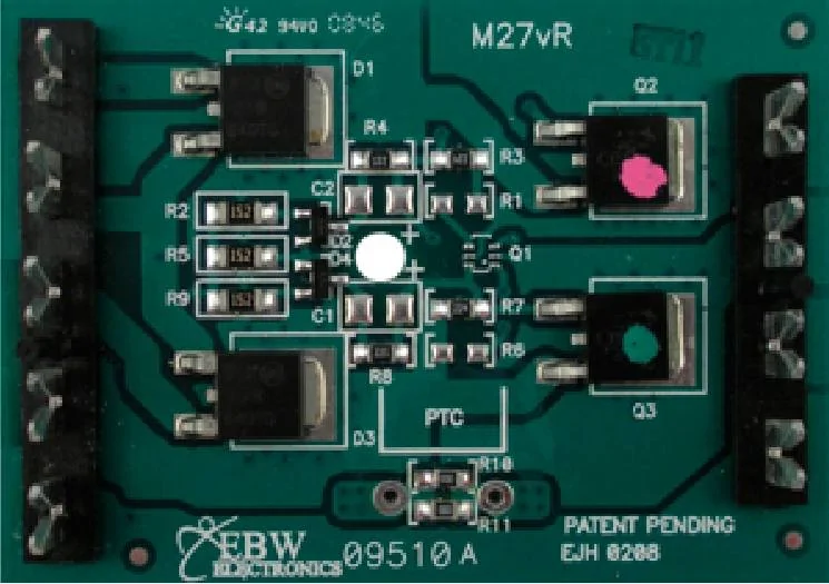

Curt Trailer Adapter Printed Circuit Board example:
Ford Maverick Nilight plugged in to hitch receiver 2025 Maverick Curt Trailer Adapter - Printed Circuit Board
Curt 56477:
Ford Maverick Nilight plugged in to hitch receiver 2025 Maverick 1745791891679-9i
Ford Maverick Nilight plugged in to hitch receiver 2025 Maverick 1745791943255-z2

How do I defeat the automatic sensing to realize the enhanced safety of additional brake and turn signal lighting?
You have to add an independent trailer wiring hookup, so the OEM socket is not involved.
https://www.curtmfg.com/part/56477
