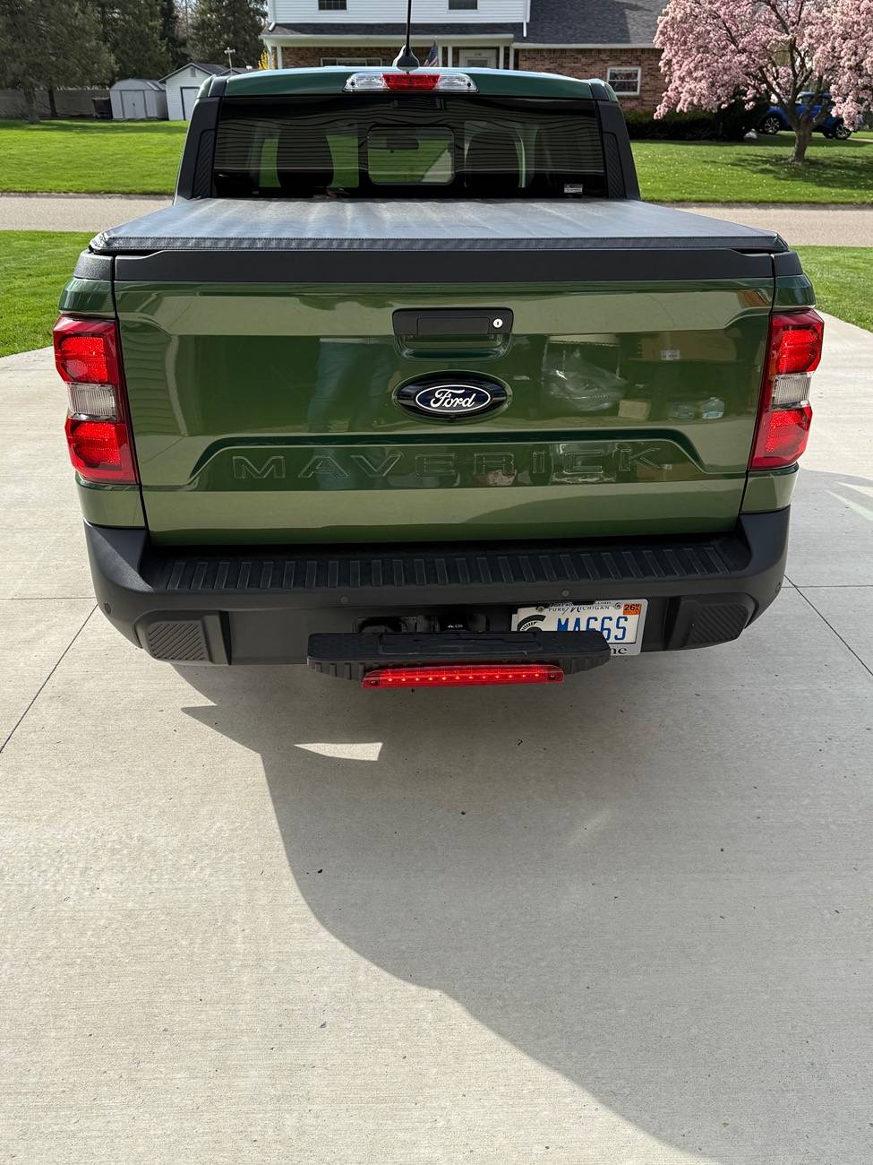

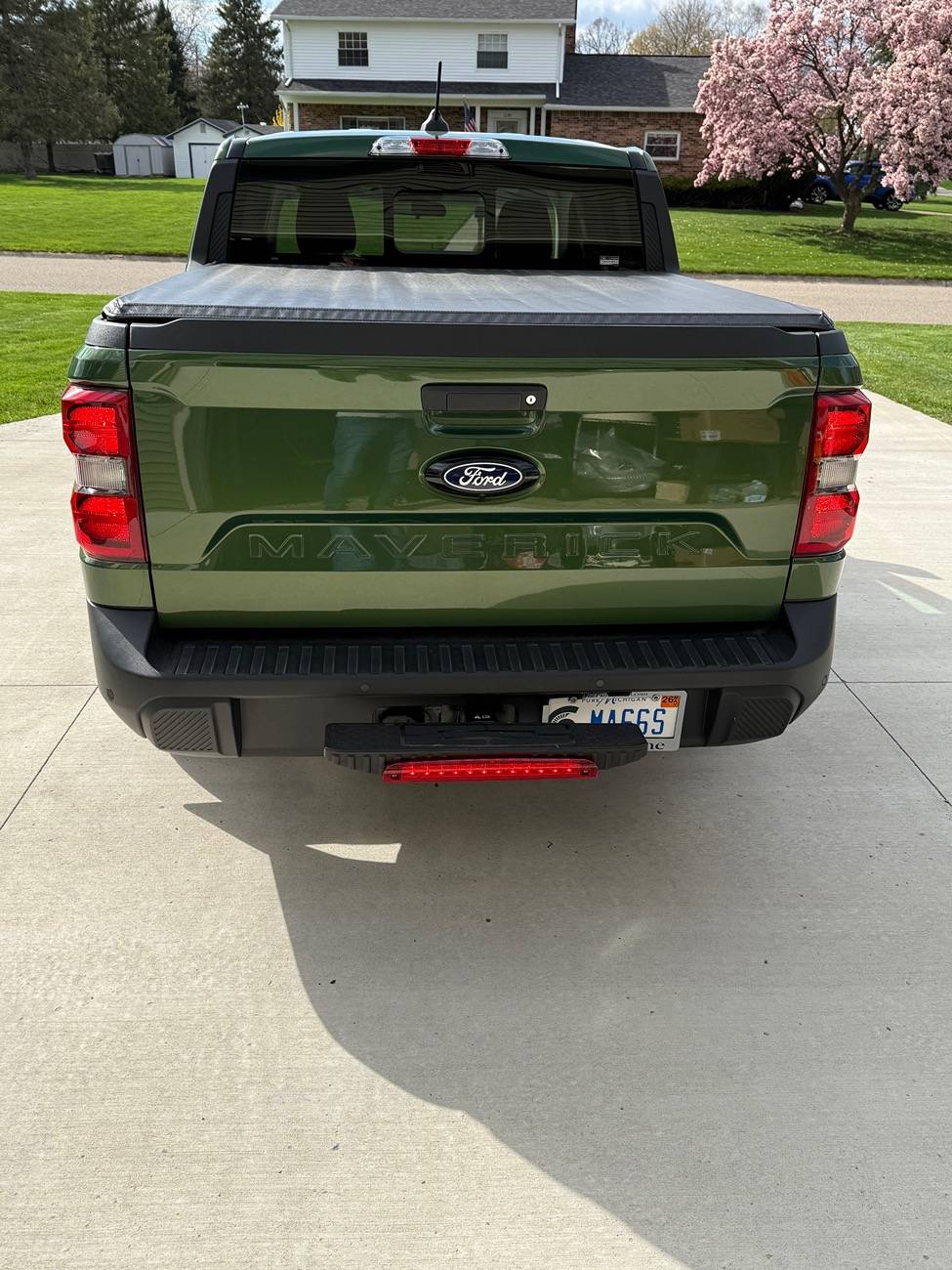

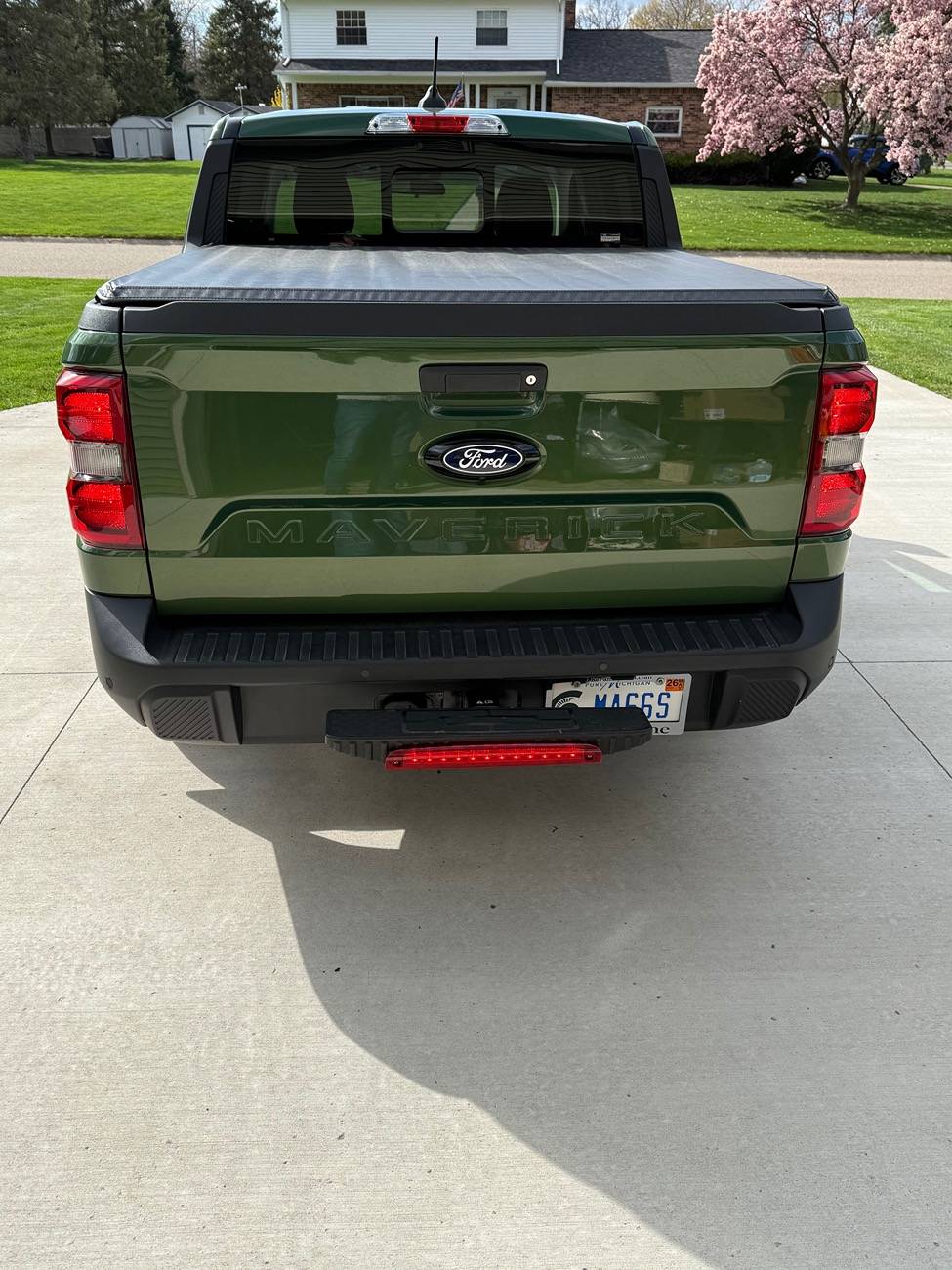

Plugging it in did defeat the safety systems, but here are pix of what I did.

Good solution but my concern would be it partially blocks the license plate which may require a drop down receiver extension…
