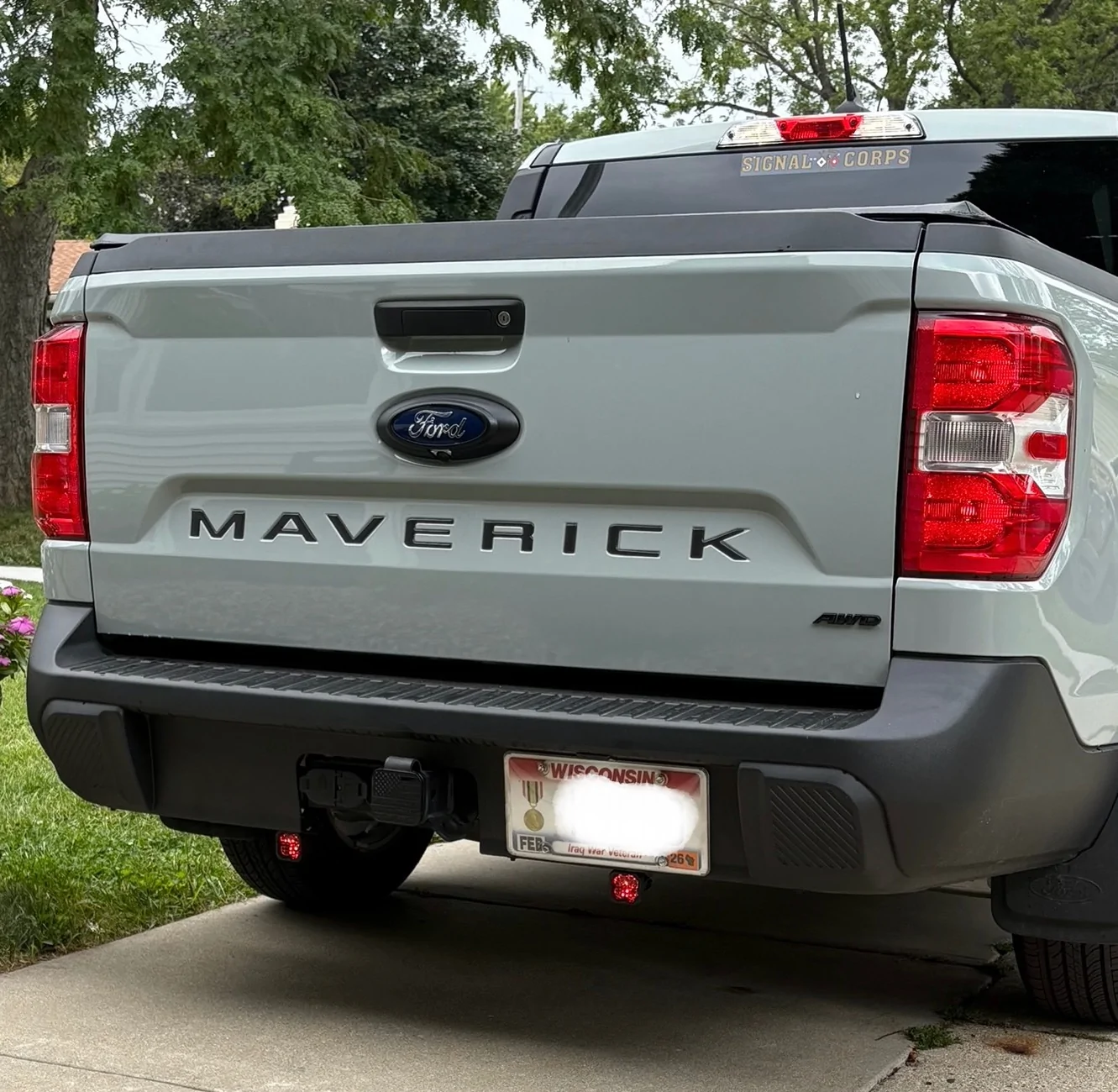

K9EMD
Jul 4, 2025
56
Wisconsin
2024 Maverick XLT
I added the reverse light kit, it bolts below the bumper. Super simple install remove driver OR passenger tail light plug in harness run cable. Drop spare tire gives you more easier access to hide and secure the harness for the lights.

I installed the single unit in the hitch receiver with supplied plug and play harness on my ‘24 XLT. Fifteen minutes start to finish. Nice unit.
What is single unit?
