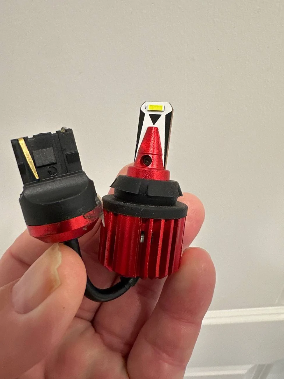

I tried 3156 and 3157, they do not work for me .
The bulb 'tongue" is too thin and too narrow. Any idea.

That's strange. The Sylvania/OSRAM 3156 and 3157 work perfectly with the tabs ground off, like they were made for it. I had no reason to believe those codes wouldn't work for other brands, and from what I understand the 2025 taillights are no different than earlier years. Can you take a picture of the LED modules you're trying to fit and post it? If you can, take a picture of the original bulbs as well.

I looked in the manual but I was not able to find the list. I shall look again.

It's on page 363 of your manual..wt21w. Good luck.
