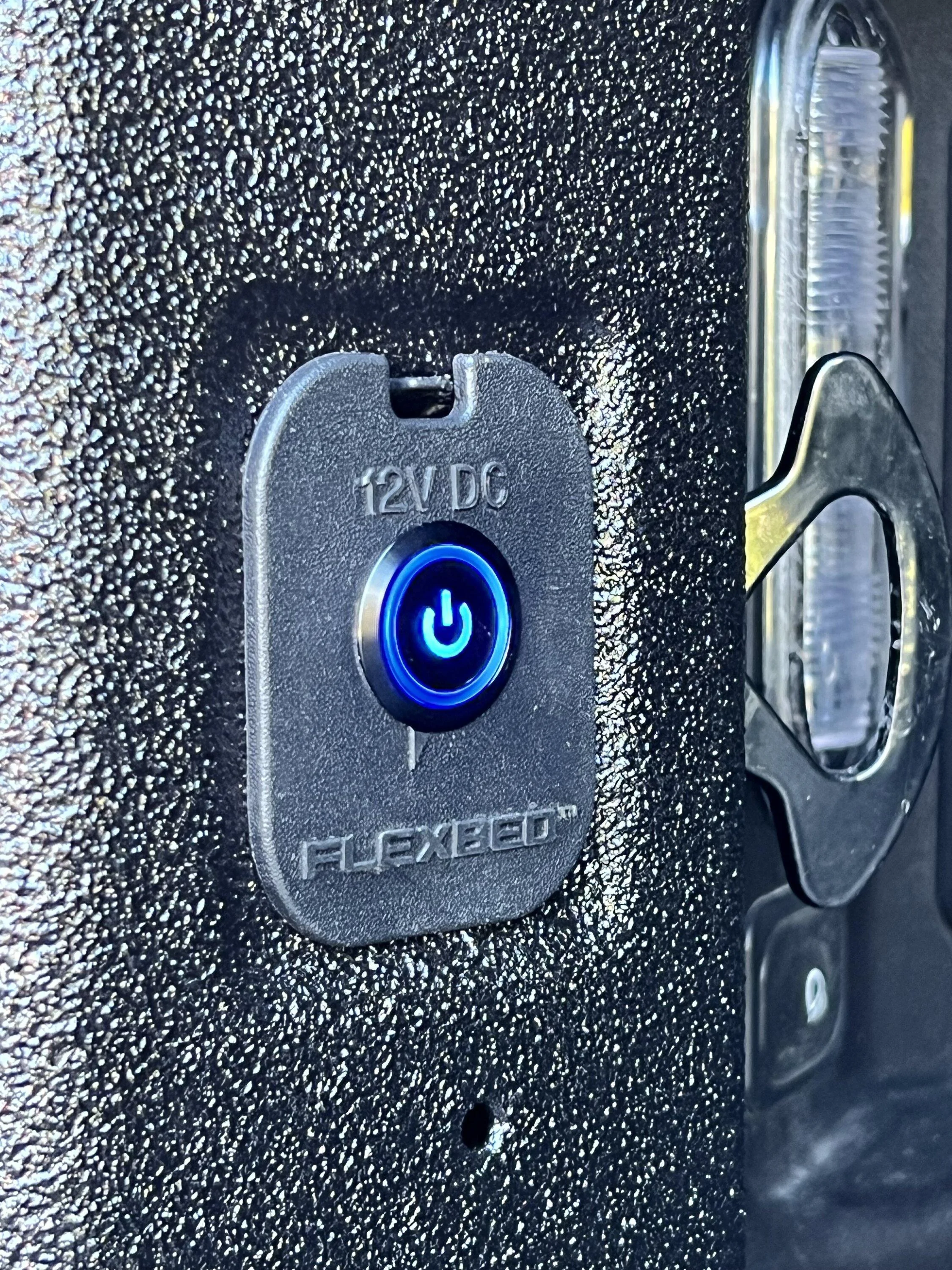

I did the same button in the same spot as well. I centred my magnetic switch by the hole middle and below the bed and fed the wires out of sight through the hole.

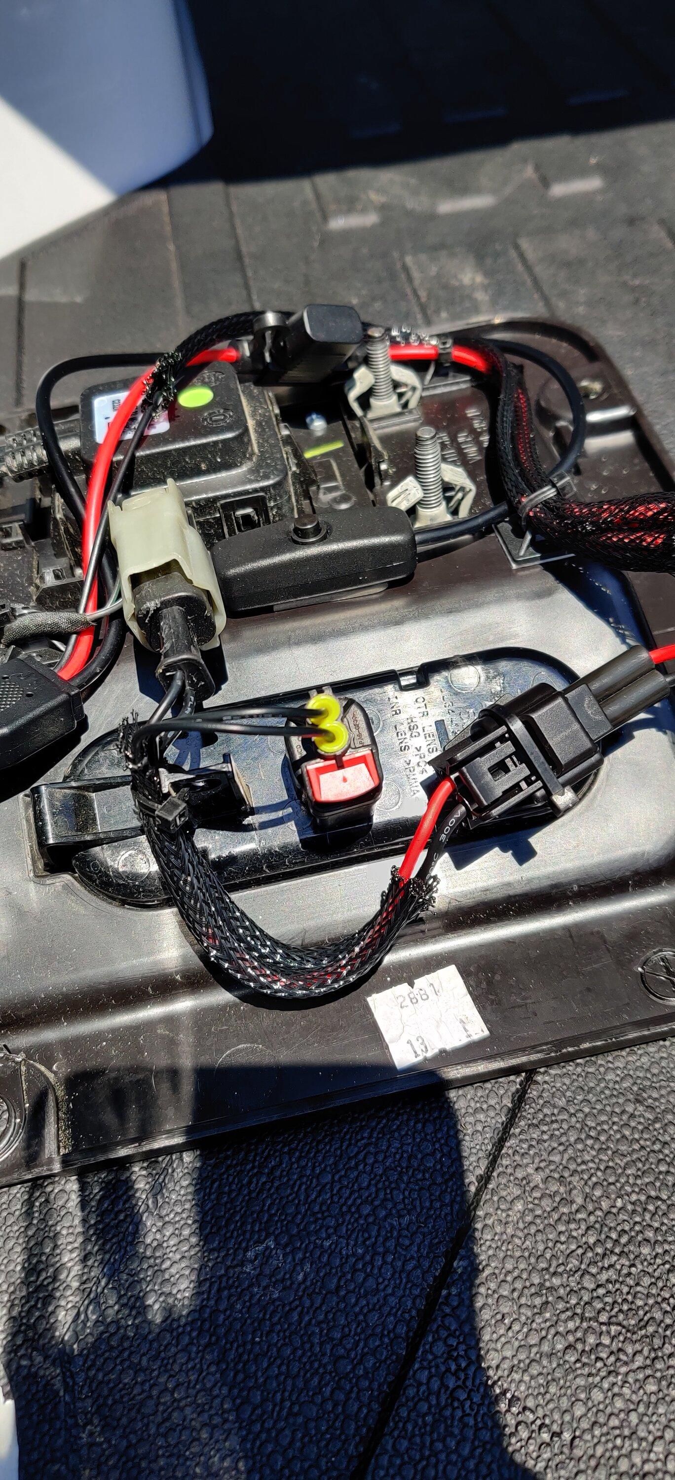

Do you have some photos of this pigtail you made? (Not trying to hijack the thread.)
The oem gray plug used to insert into the light. I just made a Y plug and play pigtail so I didn't splice into factory harness.

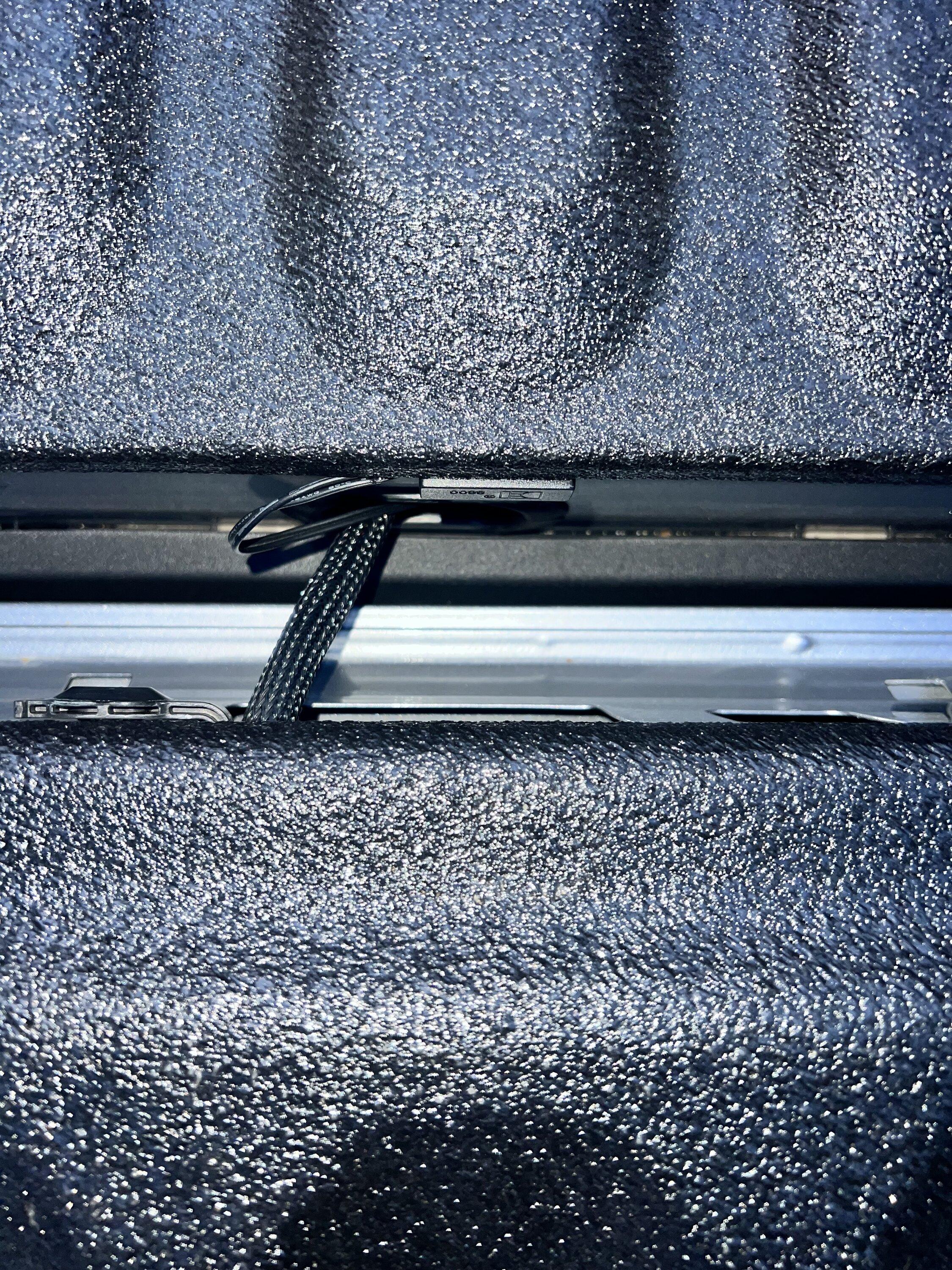

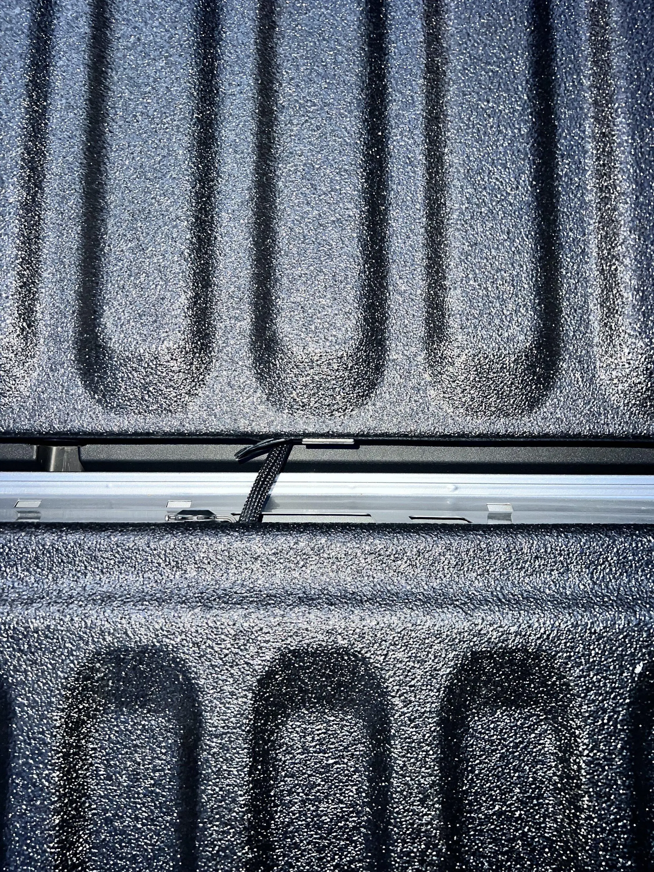

In the picture of the tailgate with the magnet switch you can see a rectangular opening.
I placed one of the magnets pictured inside lined up with the switch. No screws required.
Neosmuk Cup Magnets,130 lbs Holding Power https://a.co/d/5ynCxBA
Magnets ordered through Amazon Canada but I’m sure you can find them on Amazon USA.
Great design, thanks for sharing. I would love to copy it but the bed rug might get in the way.
Also how did you install the button? Did you just cut the wire for the Nilight button and rewire?
The magnet is very strong and should pull through the bed rug. I went this route as the other half of the magnet switch wasn’t strong enough.
As for the switch I left it intact and tucked it inside the 12 Volt access.

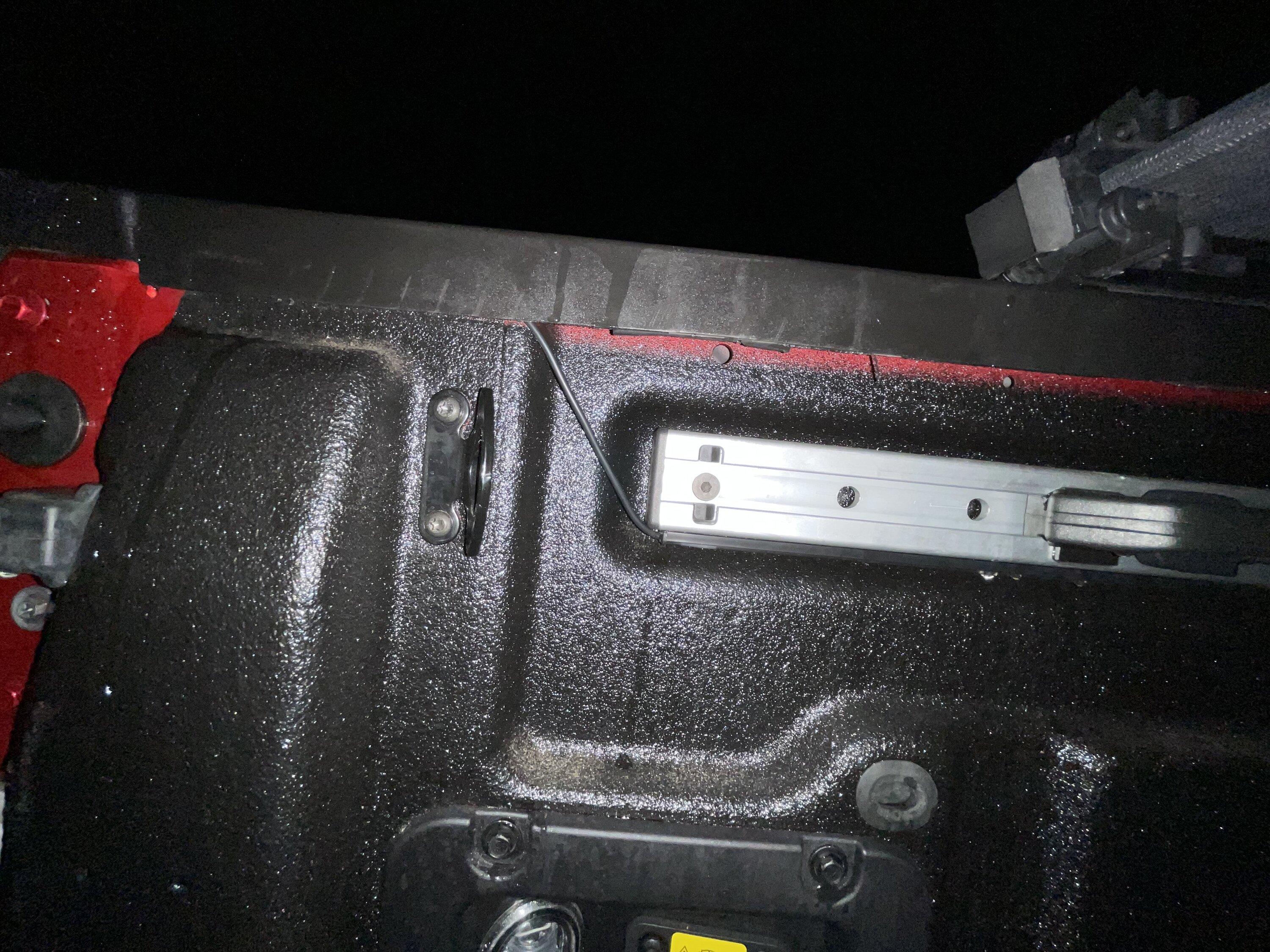

Where would you put the switch that comes with the nilight itself? Some people have said at the 12v plastic entry in the bed, but I feel like that is going to stick out and get in the way if I put a lot of things in the bed. Maybe on the driver's side near the top? Amy ideas would be helpful. Thank you
I tucked away inside the top channel of the bed on the driver’s side.
So, on the driver's side, there's a small area at the top of the truck bed that leads into the brake light area. Is that where you fed it to become accessible to the truck bed?
Yes it is.
