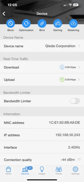

When I couldn't get the update to work with my standard setup in my home (my wireless access point is just on the other side of the window from my truck - about 10 feet away), I moved one of my mesh nodes to my driveway to get a better signal. (My truck shows up as "Qisda" on my network and I confirmed this by matching my IP address in my mesh system to what displayed in my truck.) At this point I was getting a very good wireless signal of -44dB:
Ford Maverick New software update? IMG_2317
At the point I got all of this rigged up. I tested the download to see if it would work and it said, "Downloading 0%" for several minutes. Looking back at my mesh system, while it was supposedly downloading, it continued to say that my truck was downloading at 0.0 Kbps. I also tried updating on my work wifi and my hotspot on my phone, with the same results.
For those of you who are experiencing frustration updating your truck, my recommendation as an IT expert would be to wait a few days. Either there is a problem with the code related to updating in our truck or Ford doesn't have infrastructure that is optimized properly for their update process. I was really looking forward to updating before a big trip tomorrow because I was hoping to avoid any bugginess the sometimes plagues my trips.

It seems to me that the update issues have nothing to do with poor wifi speeds for many people.
