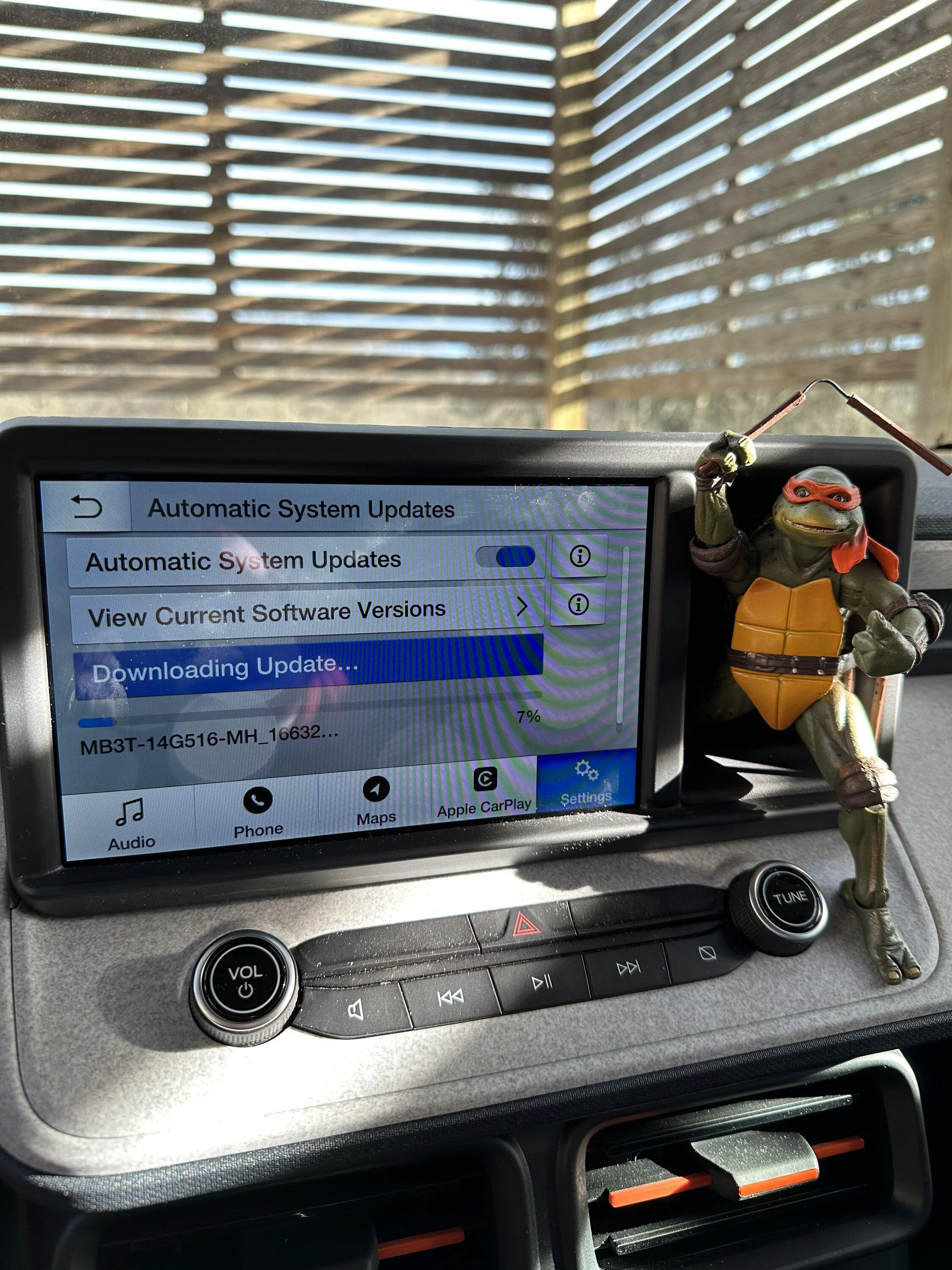

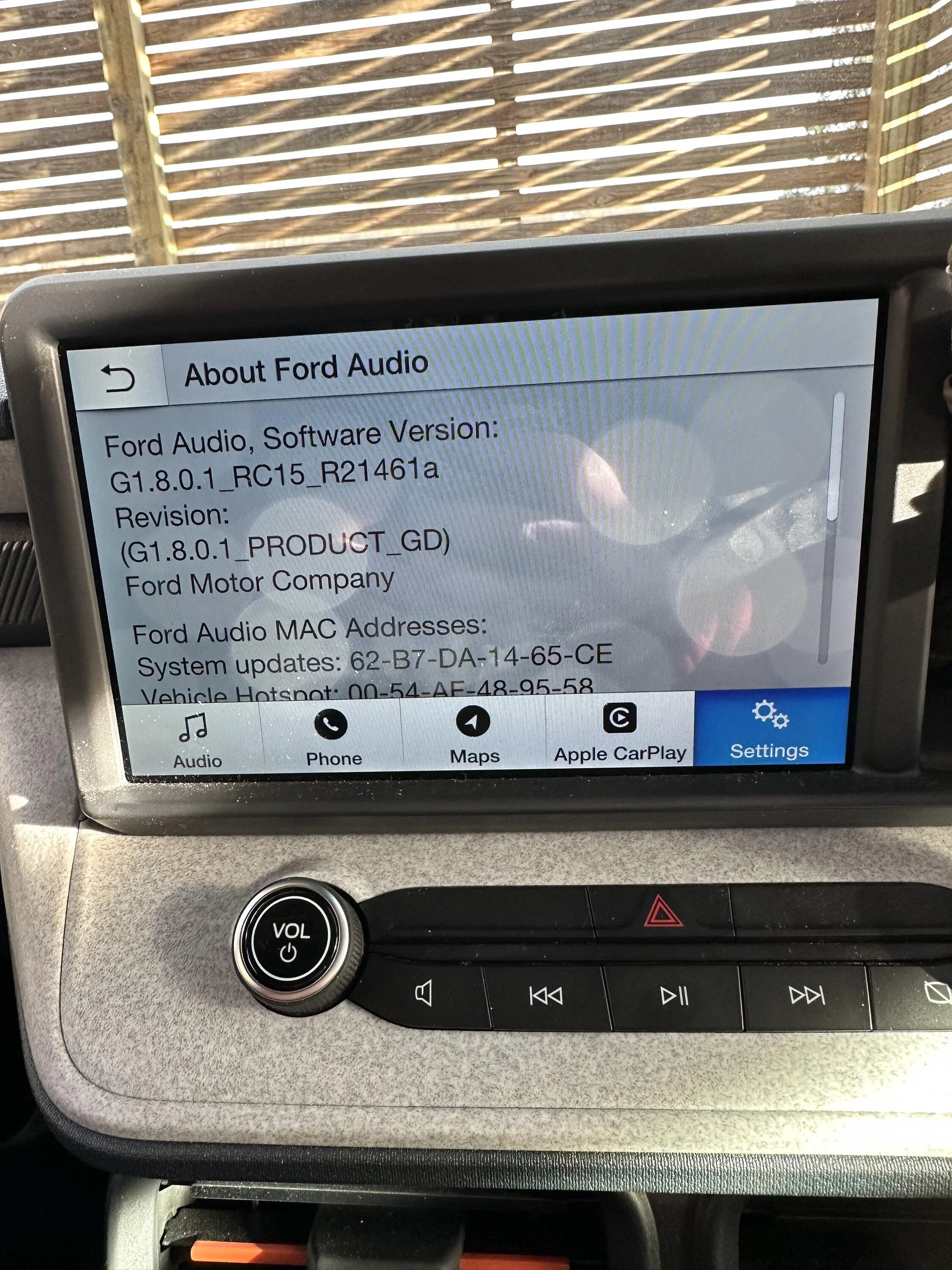

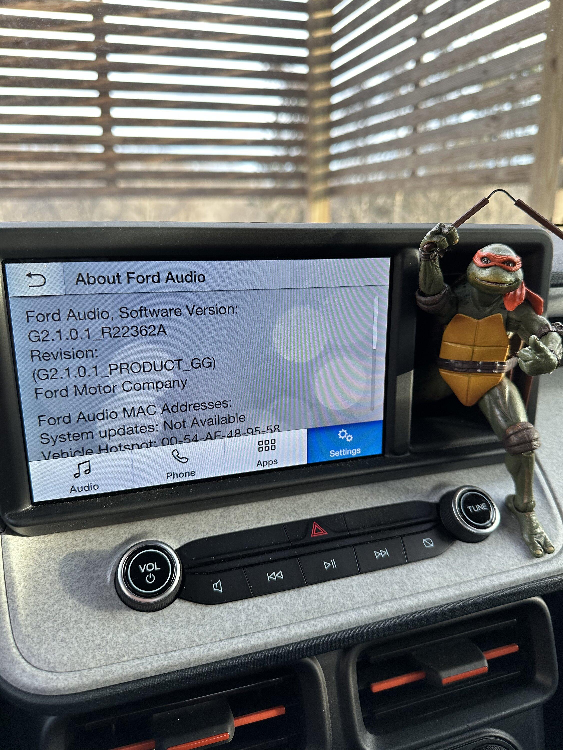

The update worked finally after a month of trying, I did a master reset and immediately checked for an update before connecting to ford pass, the first search always fails to find anything and the second usually finds one and stays at zero. This time the first failed and the second started right away took about 20 min, my radio is performing way better and I also noticed the chime changed when putting it into park! I also had to do a soft reset before it would go thru fully! This was all done on a hotspot thru my phone.
This is my problem - 1.8 and stuck there on 0% - so annoying and I just gave up. I will try the master reset, I haven't tried that. Thanks for this post bud.
