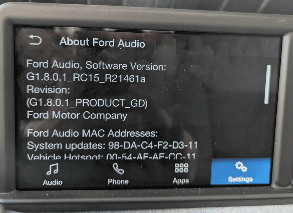

I have a Lariat. This is what mine shows.

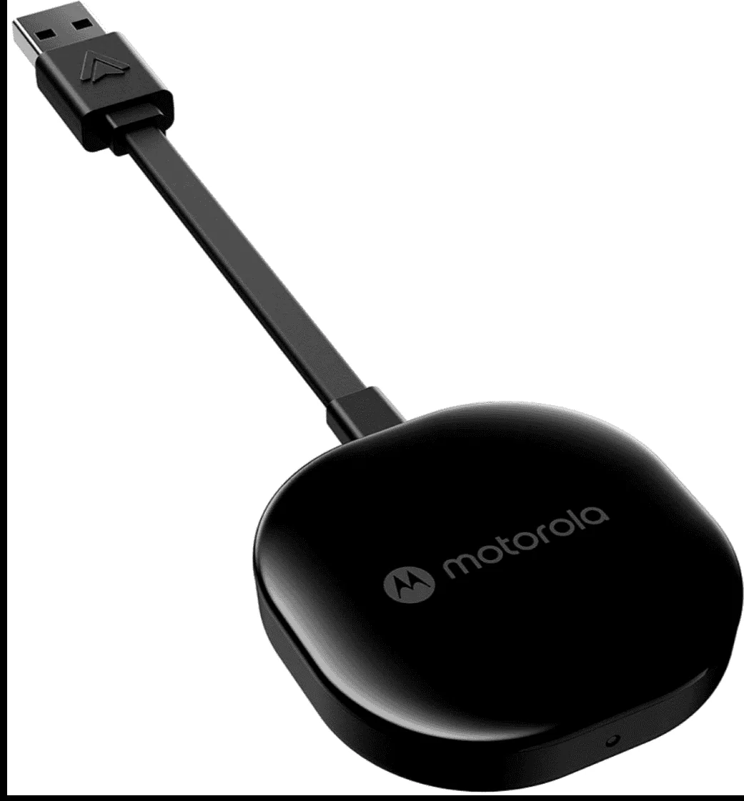

I love my Motorola MA1 I never have problems with having to disconnect it. I get in the truck. Started it up My phone Bluetooth connects to it and my YouTube music starts playing. I would tell everybody with a Maverick get it!
XL & XLT use a completely different infotainment system, screen and buttons are the same, rest of the hardware isn't. SYNC 3 can be updated via WiFi, by the dealer, or USB flash. XL/XLTs use something similar to SYNC 2.5, which most of the features of SYNC is stripped in favour of using Apple CarPlay/Android Auto.
Unfortunately, for us with SYNC lite, we can only update via WiFi. Downloading the update can be a pain if your WiFi signal is weak. Any hiccups require you to restart from 0%.
I'd love to do that, but, I'd have to run two cables.
One for the dongle for Wireless AA and charging the phone. The cubby is full as is for receipts and knick-knacks lol.

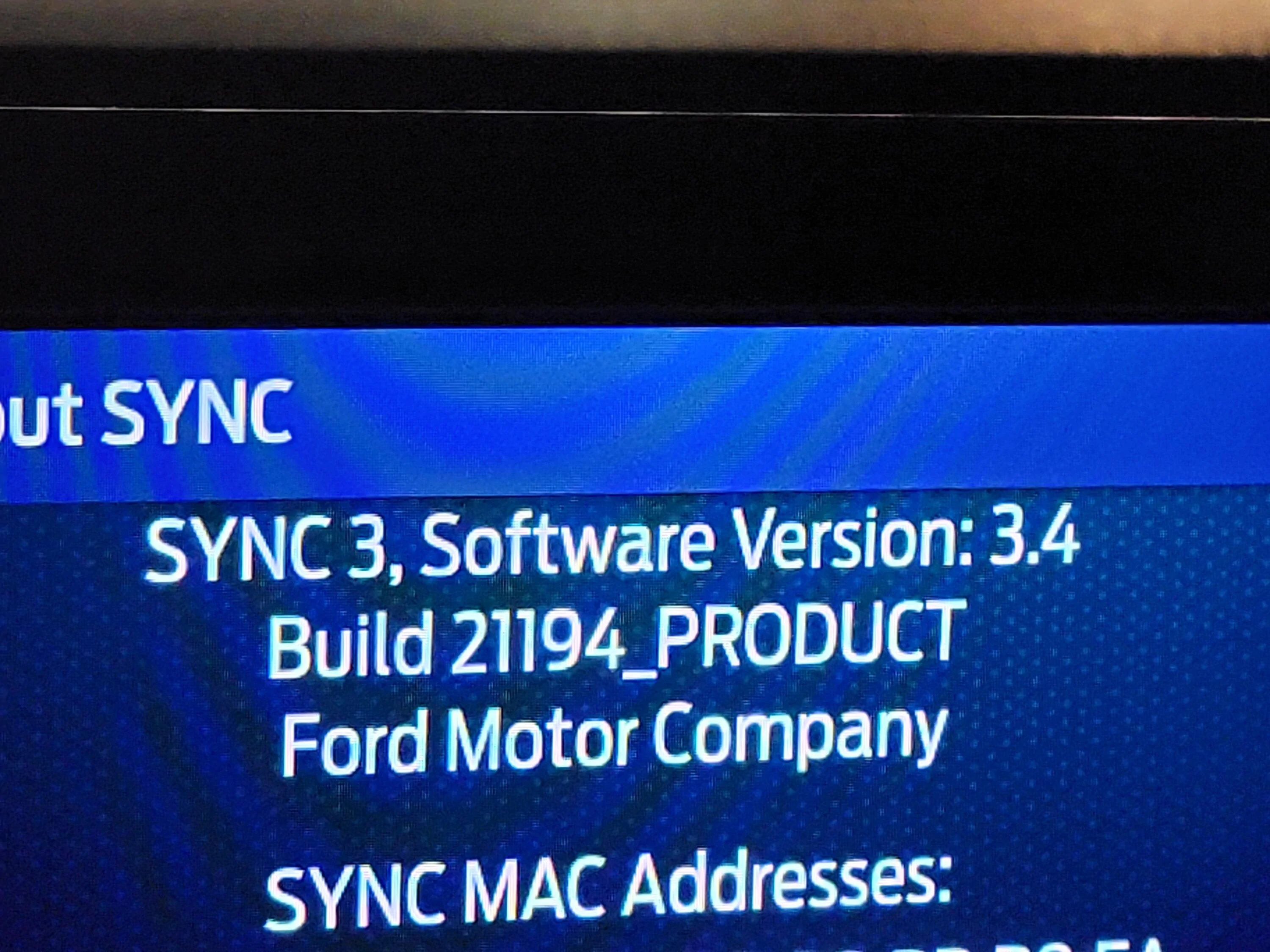

In the settings for the truck. The is a option to check for updates... It's best to be connected to a wifi
Funny, I just checked mine. And even though I've got it set for auto updates, I did a manual scan. I've got a different (and apparently older) version than yours, and got no update.
I know there was an update earlier in the year... Maybe you need to give yours a couple of days for the update to settle in and then try again for the latest. Mine was set for auto update too but never has. That might have to do with the connection.
I don't think auto-update works correctly. The system never reconnects to WiFi from my experience except after the update.
Starting the truck in the morning or coming back, the WiFi icon after the update shows the WiFi signal with an I. Not connected, but WiFi available.
Try using your Mobile Hotspot to see if there's an update. Though, I warn ya the update is 500Mb.
Ford's infotainment systems are picky when it comes to WiFi signals and slow speeds.
