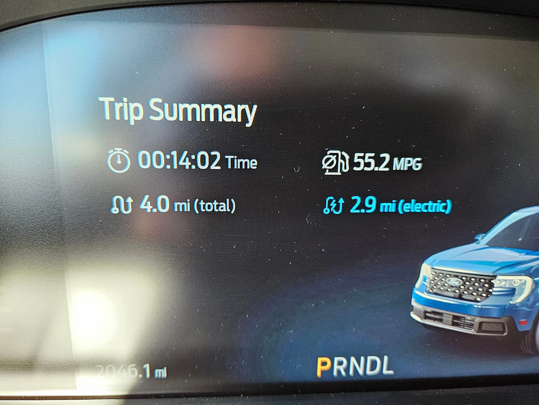

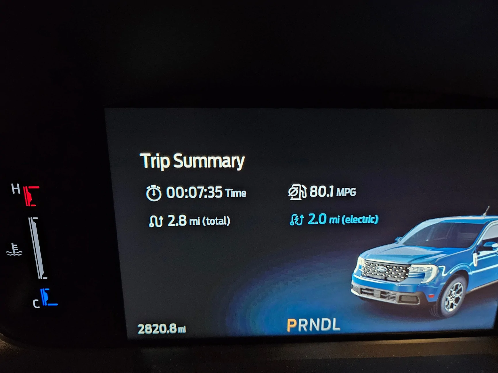

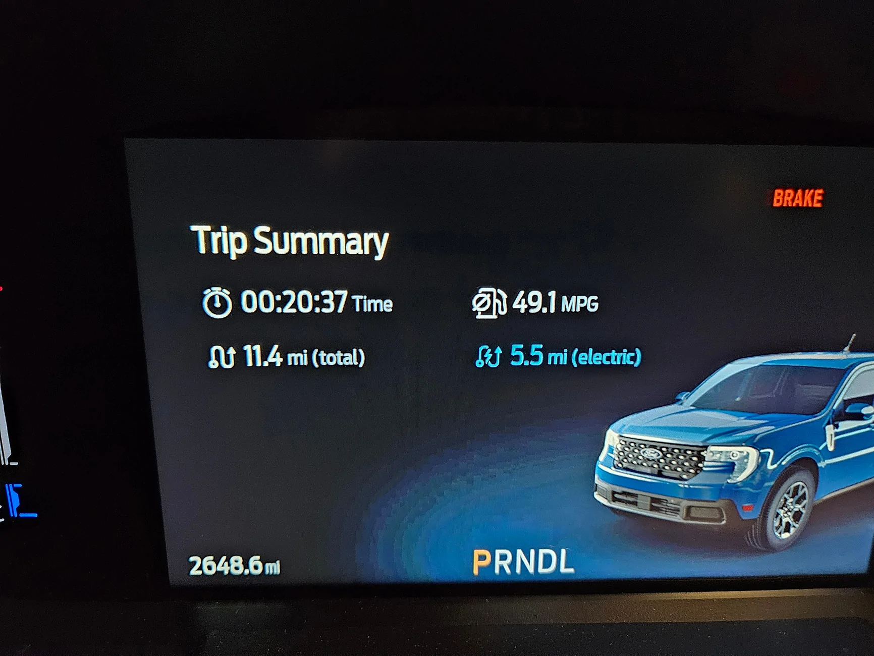

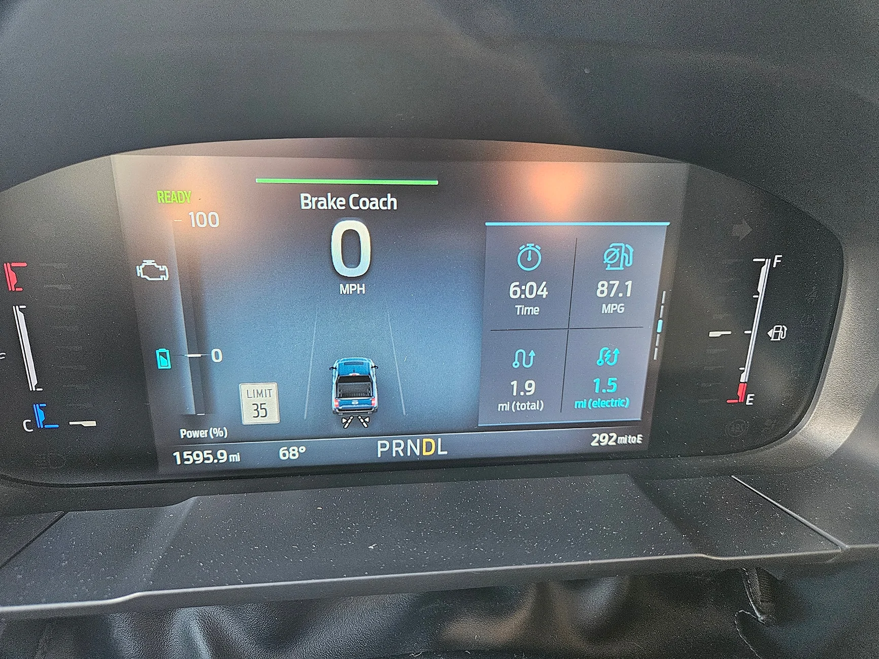

Remote start it so the battery is charged in cooler weather, the ICE will run for heat anyway so might as well let it idle first and get into a warm truck. Get up to speed on the ICE engine and then let off the throttle for a just a moment and ease back on to kick it into EV mode. Turn on the EV coach so you can see what's going on. Make sure you stay inside the regenerative braking threshold so you don't waste energy using the brake pads unnecessarily. On good days you will see 50-60mpg in town.
