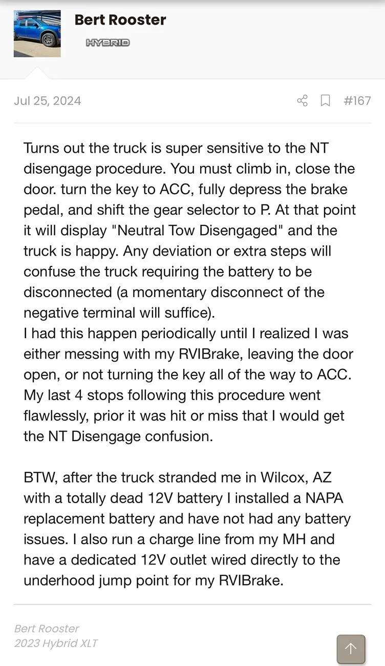

Turns out the truck is super sensitive to the NT disengage procedure. You must climb in, close the door. turn the key to ACC, fully depress the brake pedal, and shift the gear selector to P. At that point it will display "Neutral Tow Disengaged" and the truck is happy. Any deviation or extra steps will confuse the truck requiring the battery to be disconnected (a momentary disconnect of the negative terminal will suffice).
I had this happen periodically until I realized I was either messing with my RVIBrake, leaving the door open, or not turning the key all of the way to ACC. My last 4 stops following this procedure went flawlessly, prior it was hit or miss that I would get the NT Disengage confusion.
BTW, after the truck stranded me in Wilcox, AZ with a totally dead 12V battery I installed a NAPA replacement battery and have not had any battery issues. I also run a charge line from my MH and have a dedicated 12V outlet wired directly to the underhood jump point for my RVIBrake.

Yes. Door open and follow procedure = error, close door (it's about 2000 degrees in there after towing several hundred miles in eastern Oregon,) follow procedure = happy truck. Also removing RVIBrake with door open caused the error, seems contrary since RVIBrake depresses the brake pedal during normal operation. Apparently NT requires the door to be closed for braking or disengagement.
We'll be traveling again soon and I will get a chance to verify my new procedure.

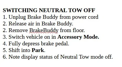

Disconnect the battery for at least 10 minutes. Hopefully, that will take it out. And the instructions are HIGHLY specific and easy to miss something. I always use a "cheater card" and have had no issues.
Ford Maverick Neutral tow mode - HELP! towcard page 1 revised
Ford Maverick Neutral tow mode - HELP! Towcard page 2 revised
