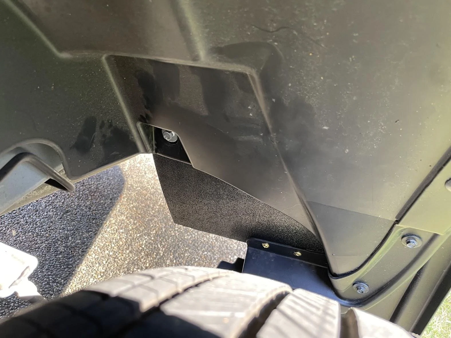

My solution for the flap gap on the left rear mudflap. I bought a 12x12 piece of kydex on Amazon, .080 thick. Link: https://www.amazon.com/Plastics-2000-KYDEX-Sheet-0-080/dp/B077S64M76/ref=sr_1_3?crid=380J4RA9SAKZZ&dib=eyJ2IjoiMSJ9.HyHC5vA9nuVrHTkgUQChz153XKZv9BcRbWIk7Mho9c4NNCNenJvqrC9e56kT86cIG3U_uQNg2V5cJlg3llkHT_W2EFF2X-Os1ToUvBPpDesZKbRvIvDGvjcnnX-gLOf2ySbKpPxOqg68XHnuzu7xOoPjAWXJLdKAQNtOukc_sed87Aw5Wt7WIq-ELWNab0r9m5KaZiFodpiv_FlGelkHJtXFkr3uyCb_m_frJ09njY4.Qi2DqYiyheTUjKDIG-wQlMvCbjnc8mfOk_aoCsxM1UY&dib_tag=se&keywords=12x12+piece+of+Kydex&qid=1719768191&sprefix=12x12+piece+of+kydex,aps,129&sr=8-3
Had to cut about 1 inch off the side . Removed one upper plastic clip, and slid the piece of kydex up so it looks like the mirror image of the right side area behind the right flap.
Used a stainless 1/4 inch bolt and washers and a self locking nut to hold the top, and drilled 2 holes in the bottom and held with the extra clips from the mabett flap install.
I hope these pics show up, my computer skills are lacking. I got the install done quicker than trying to post this thread.:sadface:

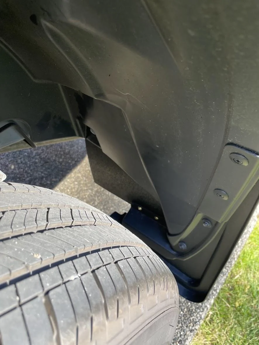

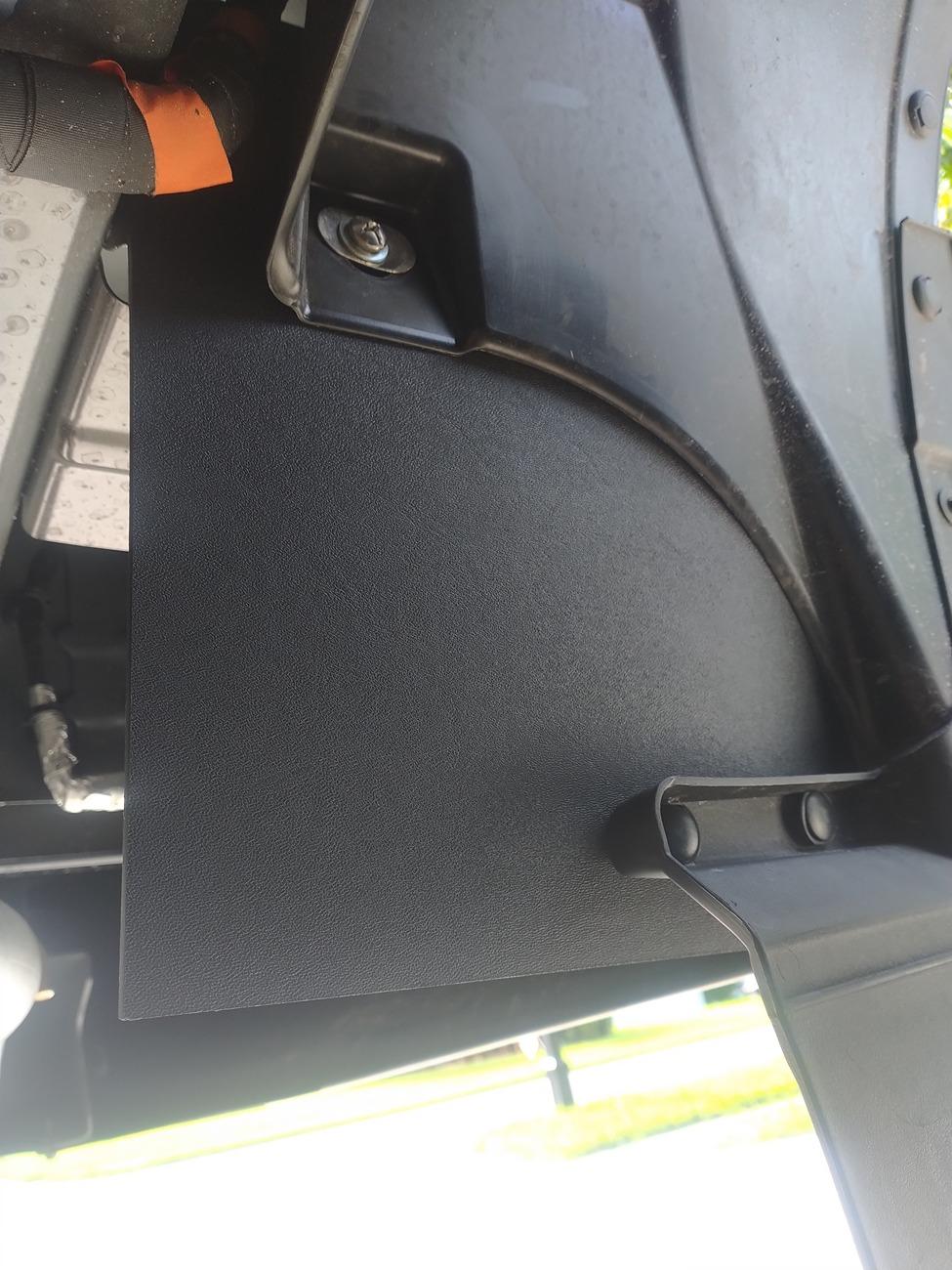

I just did this - thanks for the inspiration!
Ford Maverick My mudflap gap fix using kydex thermoplastic sheet mav-wheel-well-gap-cover-1
Ford Maverick My mudflap gap fix using kydex thermoplastic sheet mav-wheel-well-gap-cover-2
This is what I bought on Amazon:
https://a.co/d/0f7IaCCz
I attached it using a bolt up high, and a couple of screws down low with lock washers.
If I had to do it again, I would use an 8x12 piece of plastic that is 1/16" thick instead, like this:
https://a.co/d/04H5VpkR
And I started with the screws on the lower part, but I realize it would have been a lot easier to start with the upper part - that was a bit of a pain :)
I'm glad I did it - that big gap is no longer jumping out at me every time I walk by it.
