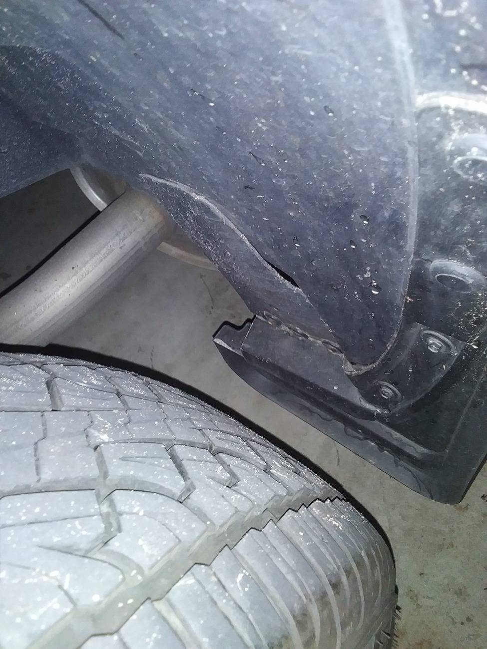

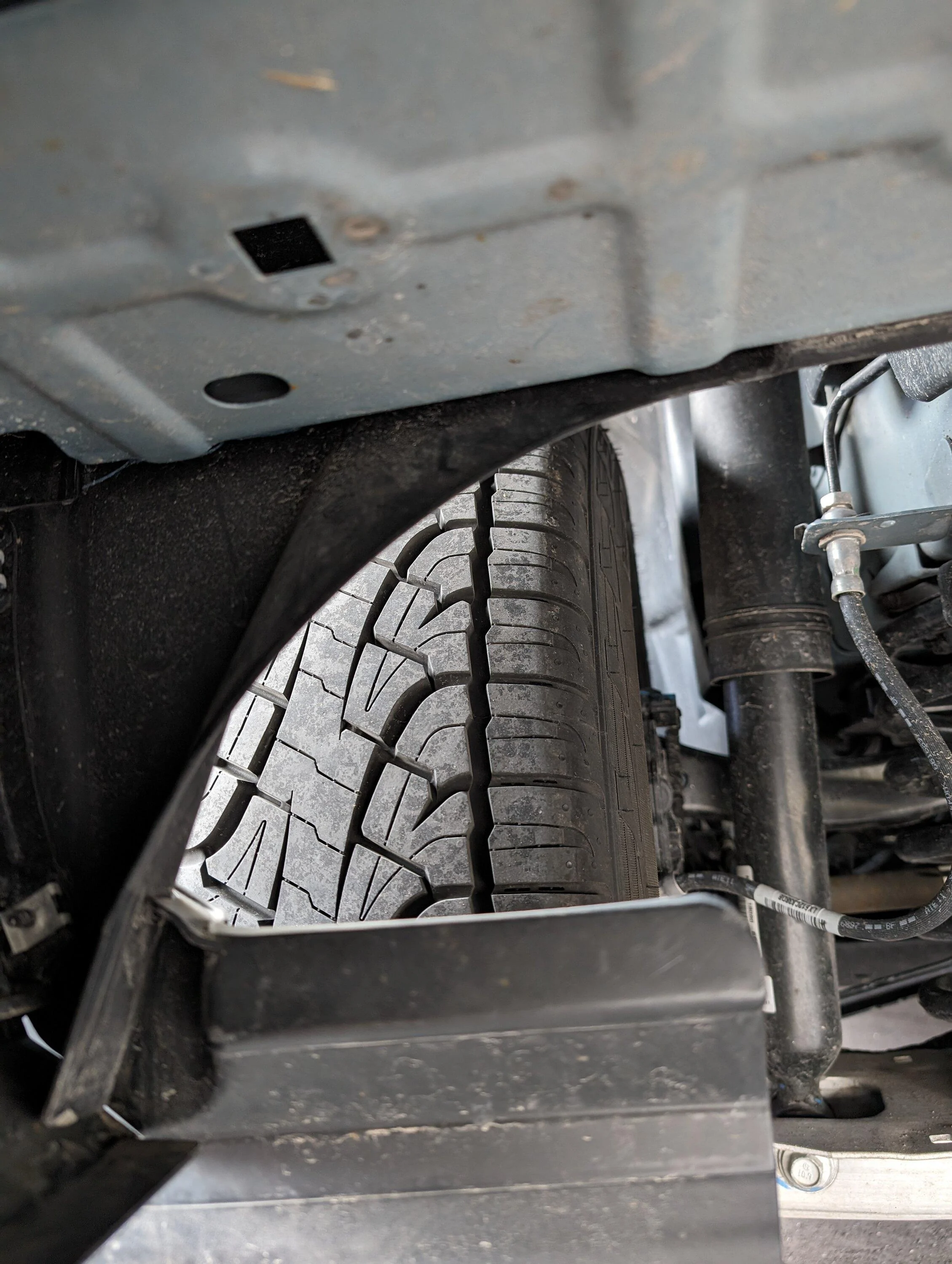

So I just picked up my XLT on Thursday and have been looking into Mudflaps. So just to clarify are you saying I can install the pickup bed cubby on the drivers side and it will cover up that gaping hole everyone is talking about? And if so would I still need to mudflaps?
Yea . I also have mudflaps with extension ( left side only) that were put on prior to cubby . my extension is made out of old flat mudflaps that were cut to fit and away from exhaust pipes . So I have double protection for that area . bought my mudflaps on Amazon for about $40 .

Thanks for the pic. My XLT has Lux Pkg so I guess there is an LED light and inverter in there where the driver side cubby would go so not sure if I want to mess around trying to relocate those or not.

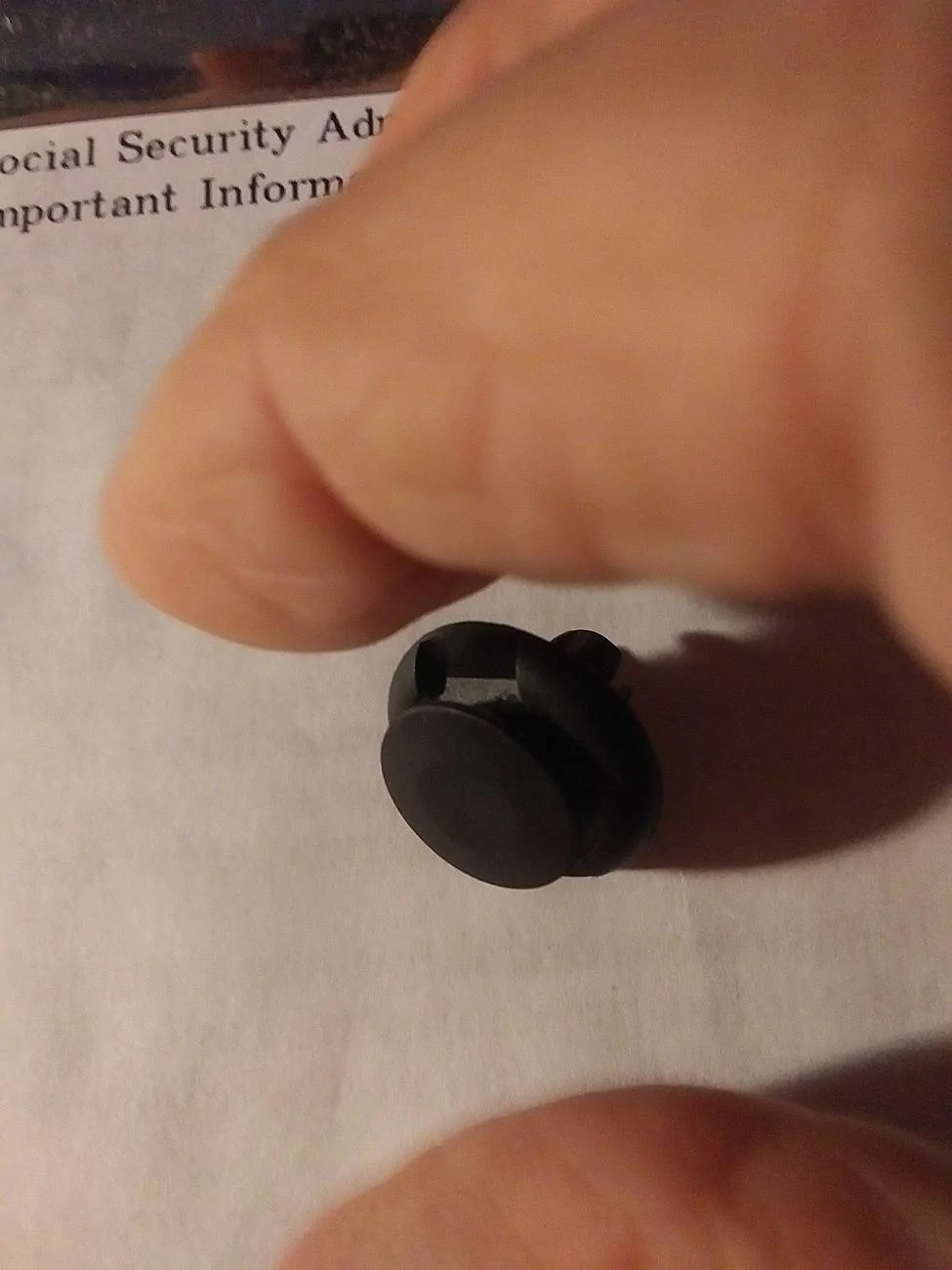

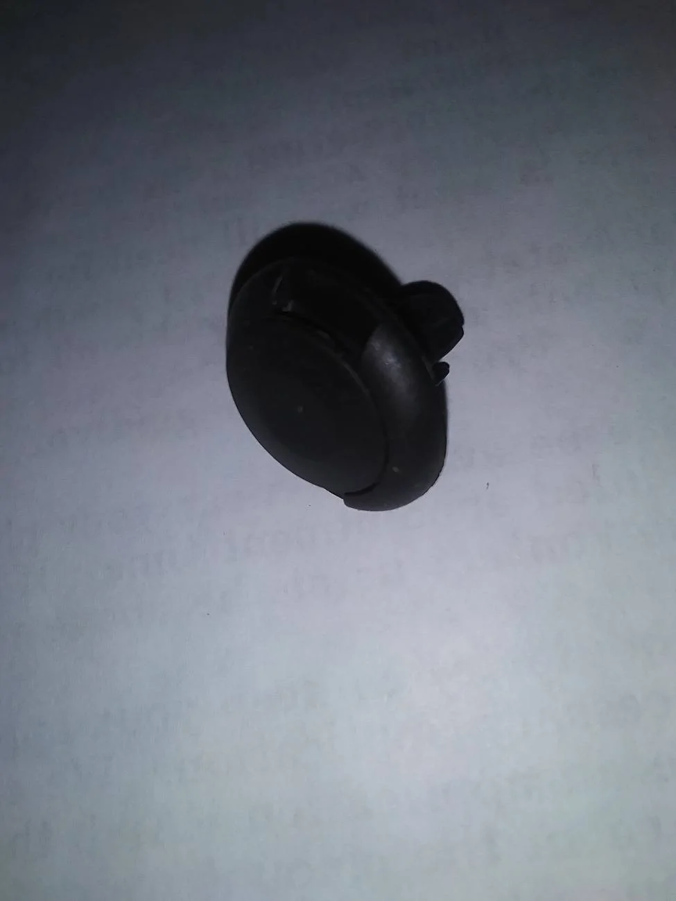

Does anyone know what the tool is called to remove the screws or maybe rivets to install the Maxzina mud flaps. I know someone mentioned a tool of some sort to remove some existing hardware that won't ruin the existing hardware. Does anyone know what this tool is and have a link? I can't find the post I read yesterday that mentioned it. I don't think the tool is required to install the Maxzina mud flaps but I'm curious what it is.

I used a small flat screw driver ( or something similar) to remove grommets . if you look closely at center of grommet there is usally a small slot that you push under to pop center piece up on that will release the grommet so it can be pulled out . grommet shown not ford but all are similar . 7 mm socket / wrench for two bolts .

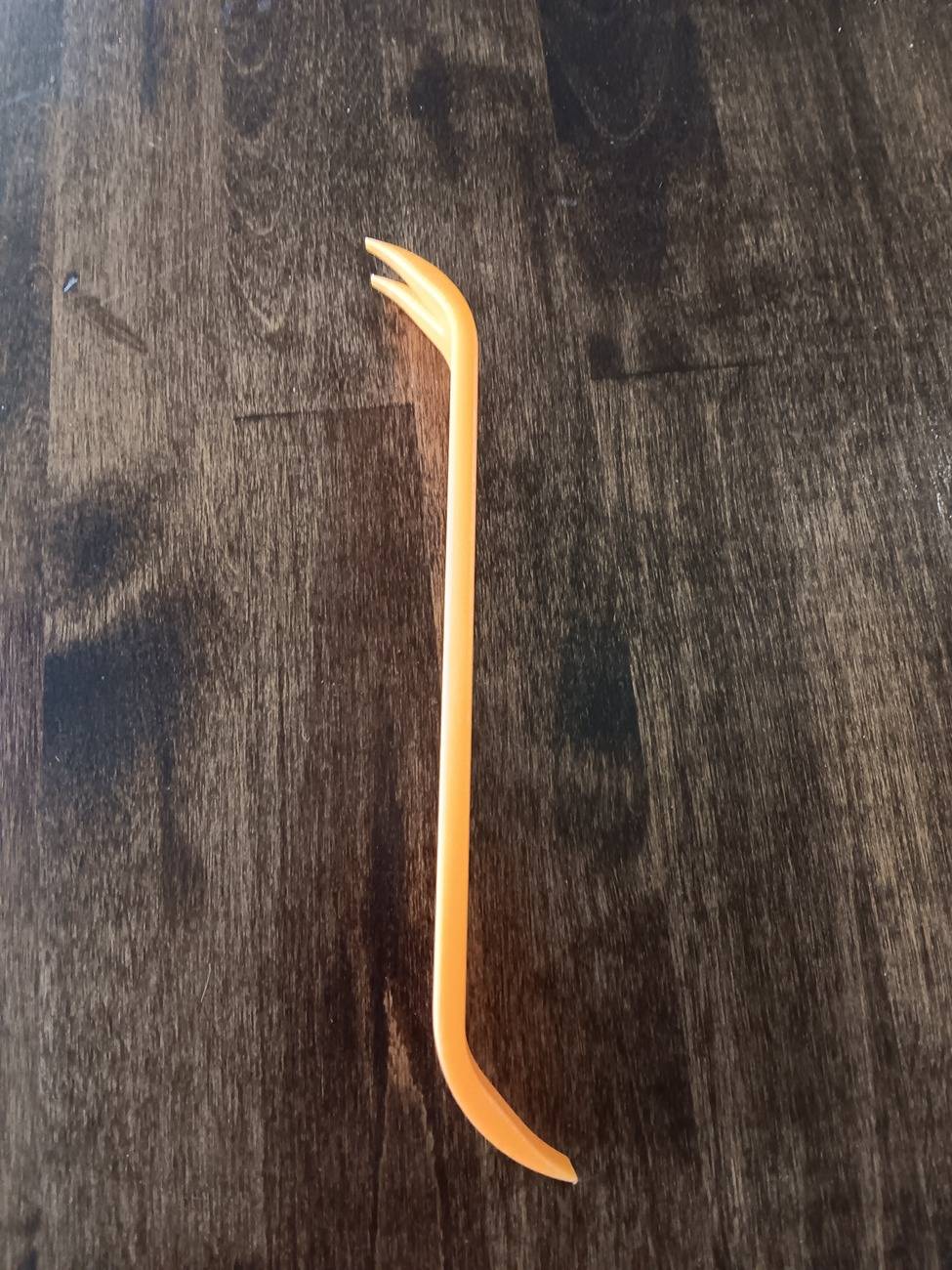

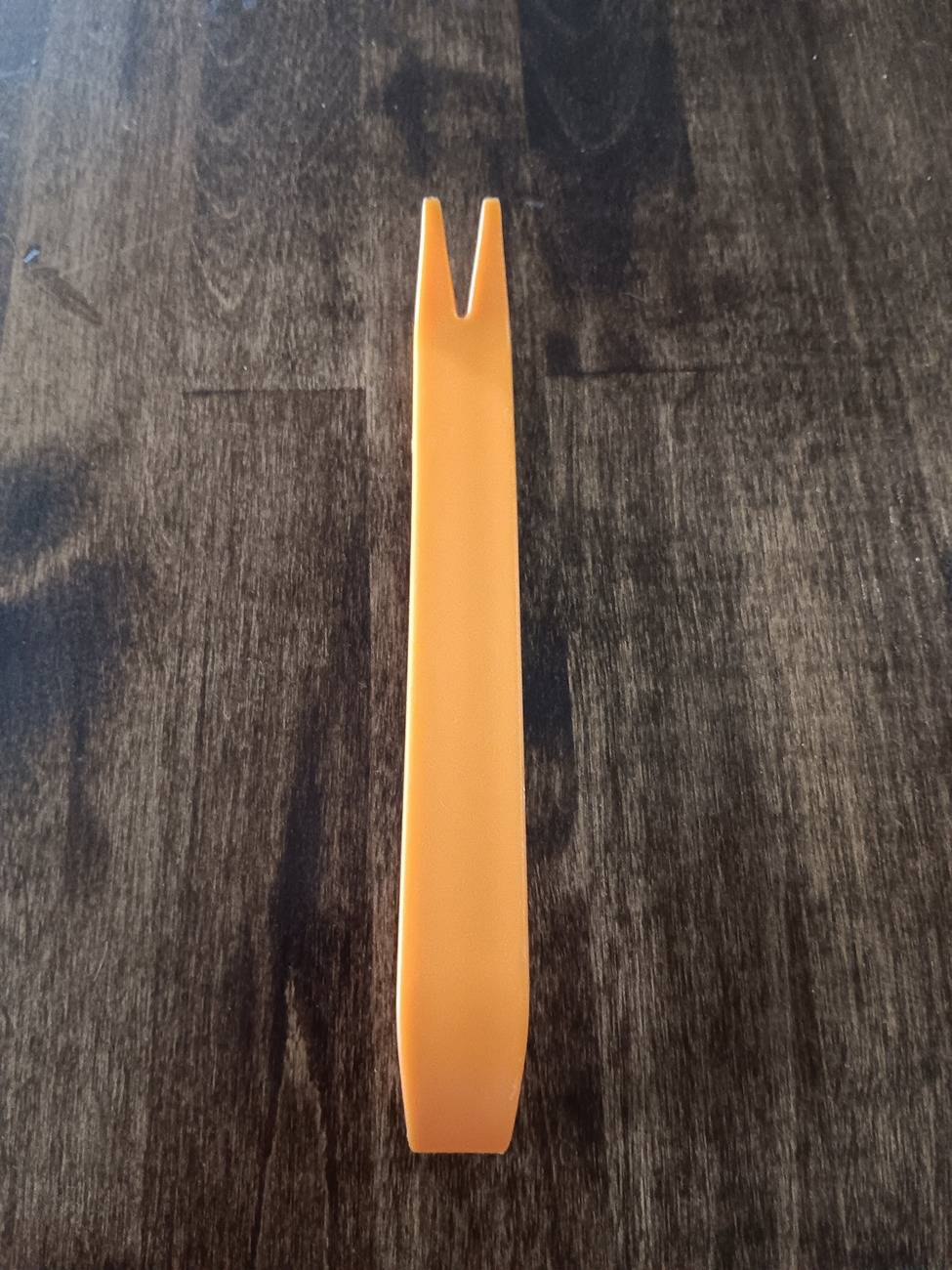

The mabett mud flaps come with this plastic pry bar which is very useful. I also used a flat head screwdriver to pop the pin first like @Jah. described. Then the pry bar to get it completely out. You can turn the pins so that the slot to put your screwdriver is at a better angle to pry. The tool is generally called an auto pin fastener removal tool on Amazon. If you were closer I'd give you mine. This is a set that has one on Amazon....
https://a.co/d/aQXVenk

Thanks for the info. I'm actually looking into buying the Maxzina flaps but I'll have to see if they come with that tool at all - and any replacement hardware for that matter. I'll also check on Amazon to see how much those tools run. Might be handy to have on hand anyway.
