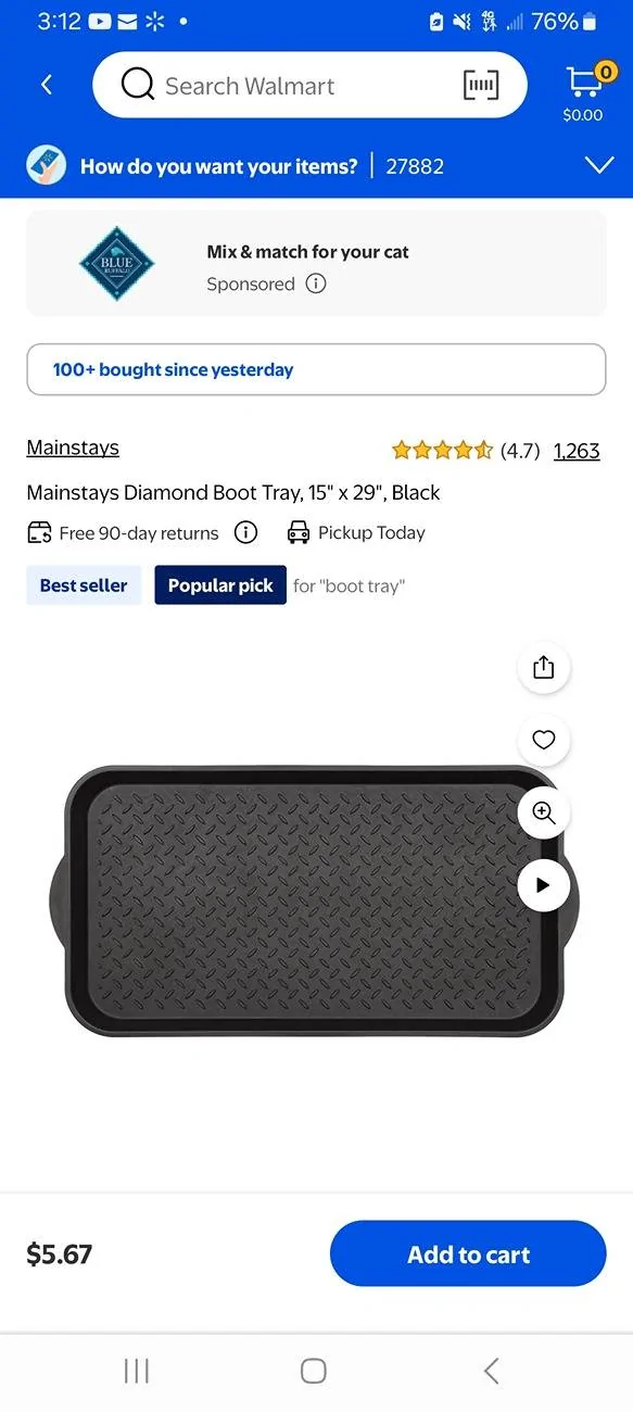

Agreed... shoulda, coulda, woulda! For those that didn't buy the maxzima mud flaps and don't want to spend money on new ones, I found this at Walmart. You can cut them with a good pair of scissors, they're diamond plated, and the same color and flexible material as most mud flaps.
https://www.walmart.com/ip/15734493?sid=6f865af9-8d38-41b3-a3a2-abb1859c676e
I think I corrected the gap before Maxina was even offering a Maverick flap. I really like my Mabetts. I had a neighbor who had some scrap commercial roofing sheeting that I cut to fit over a year ago. Still working fine. Cost me nothing and allowed me to be creative, very satisfying job. The Walmart tray is a perfect type of material for this job.
Cool, good solution as well. I have no complaints about the mabett mud flaps but the gap got to the best of my ocd. They way I look at it, my add on is just another customization unique to my Maverick.
