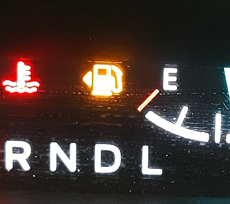

The little arrow beside the fuel gauge on the display that tells you which side of the vehicle the gas cap is on. It's blinking.

There is nothing in the manual that suggests that the gas cap side indicator arrow should blink. There would be a CEL if what you indicated was true. I'm talking about the little arrow that tells you what side cas cap is on for when you pull into a gas station

I can try but it’s not consistent blinks like a turn signal. It’s random. And, while I’m driving.

Is it possible the appearance of it blinking is just glare from sunlight coming in at the right angle?

yes. At first, I thought it was a light reflection, but it happens occasionally in low light as well. And it's more of a steady blink while it lasts and not random flickering. Weird.

Just the arrow blinks?
That shouldn't be what his fuel gauge looks like with a Lariat Ecoboost.
All of the "white" text and symbols outside of the LCD display are illuminated from behind when the truck is on, regardless of headlight status. Sounds like you have a failing LED or a short in the instrument cluster circuit board.
