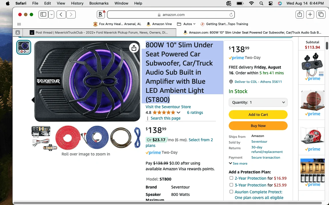

I said this was my first time., but still I feel foolish for having to ask. I’m completing the installation of my ST800 subwoofer and amp combo by Seventour. All I have left is securing the wires coming from where I tapped into the rear speaker wires on both sides to the unit itself (high-level install). I am using paired 16ga strand wire for those runs. I had assumed that the stripped ends of the wire would be pushed in to the appropriate slot on the unit’s plastic junction box and probably secured by some type of spring clip. That seems not to be the case. What am I missing? Should I be using a smaller gage wire? Help!

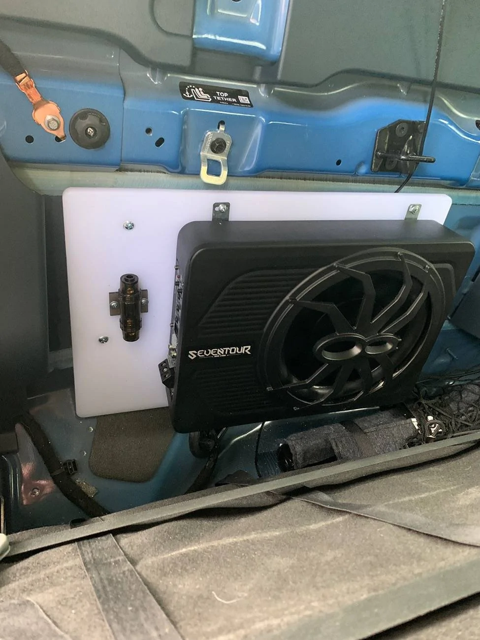

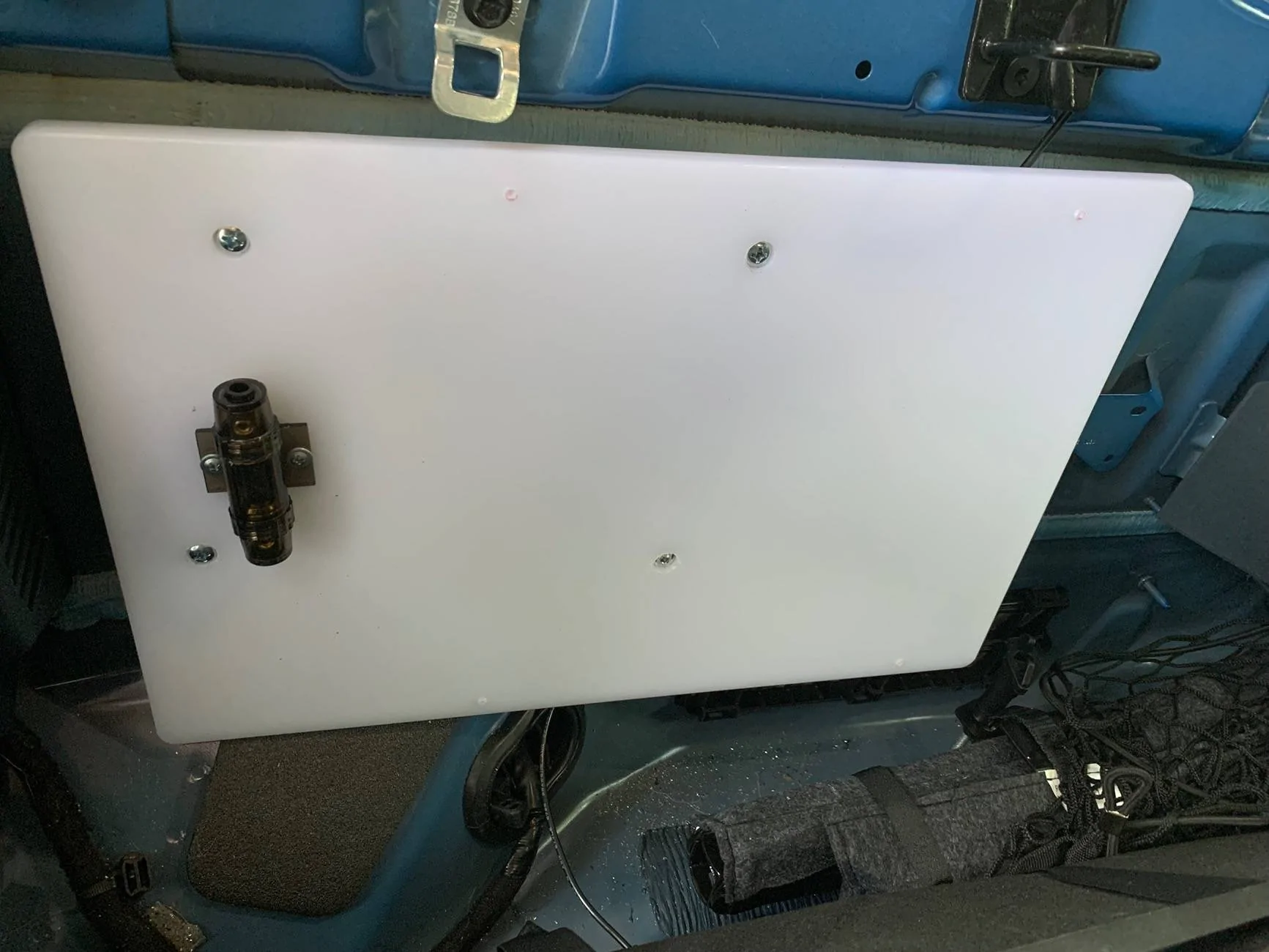

I’m told the second time will be easier. This evening, I completed the last of the wiring tasks associated with installing my subwoofer and amplifier combo. All I have left is to clean up the wiring at my mounting board and under the rear seat. As this was my first, I’m not sure what to expect from the unit. Clearly the available volume is significantly louder than without. I found I have to turn the independent bass volume remote controller toward max to hear the bass boom-boom I was expecting. I still need to take it out of the highway for a trial over road noise.
I wired the unit to an accessory fused circuit at the rear of the center console. Everything lights up at the turn of the ignition key. When I turn the key to off the ambient light surrounding the speaker goes out immediately. A single LED spot marked as the power indicator remains on. First thing in the morning, I’ll see if it starts up, or if I was draining the battery overnight. If so, a switch will be in order. More to follow. My thanks to all with answering my nob questions and especially DrNoobNStein whose post on installing a subwoofer using the rear speakers motivated me to take on the challenge. Photos to follow tomorrow.
