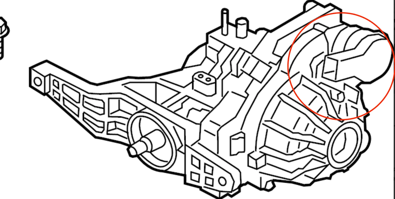

Update: The dealership believes they have narrowed it down to the rear differential. They also warned that this might not resolve the issue. They ordered the part but it's on backorder and they don't have an ETA yet. My corporate contact called yesterday too and said if this doesn't resolve the issue they'll be sending a tech to the dealership to continue to troubleshoot. Overall, I'm really impressed with how seriously they're tackling the problem but I just want my truck back....
More specifically, they said something in the red circle is what they think is causing the issue.

@Johnkn was right. It was a speed sensor. The cable was frayed. There is no way to tell if it was from the tire replacement, rocks, snow, etc. Ford corporate extended my warranty to 5 years/75,000 miles because it was at the dealer for so long. I was not expecting that but I appreciate the gesture.
