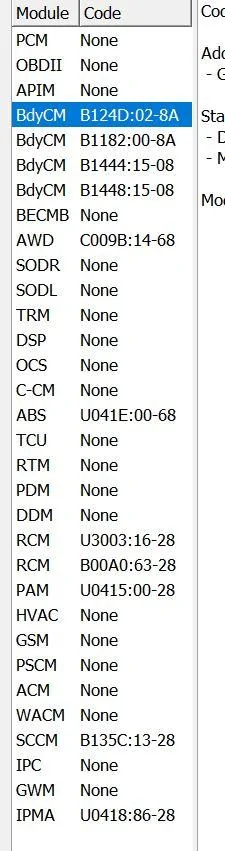

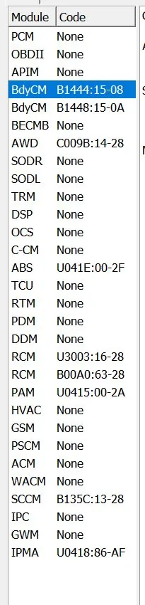

This is my first time reading codes in Forscan. I am not sure what to make of all of these.
Are you ready for your Christmas Present?
B124D:02 Tire Pressure Sensor general signal failure
B1182. TPMS
B1444:15 LR Stop Lamp short or open
B1448:15 RR Stop Lamp short or open
C009B:14 AWD rear actuator short or open
U041E:00 Invalid data from AWD module
U3003:16 ABS voltage below threshold
B00A0:63 Occupant Classification Protection circuit timeout
U0415:00 Invalid data from ABS module
B135C:13 Heated Steering Wheel element open circuit
U0418:86 Invalid signal from brake system control module.

That said; since you have LOW/NO VOLTAGE error codes, including stop lamps and heated steering wheel of all things, really sounds like a loose wire harness somewhere.

OP, I ripped a front wheel sensor cable off my Raptor and received virtually all your same codes. And like you experienced, initially they would clear temporarily upon shutdown the first time or 2, but then the failure became solid.
The wheel speed sensors are common to and provide input to all those failing systems.
The person changing your front tires was right next to those sensors.

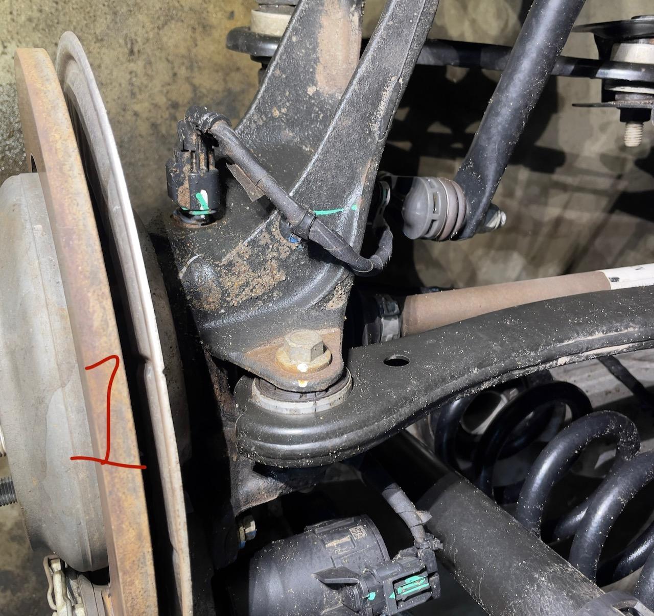

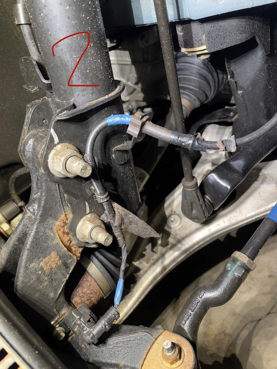

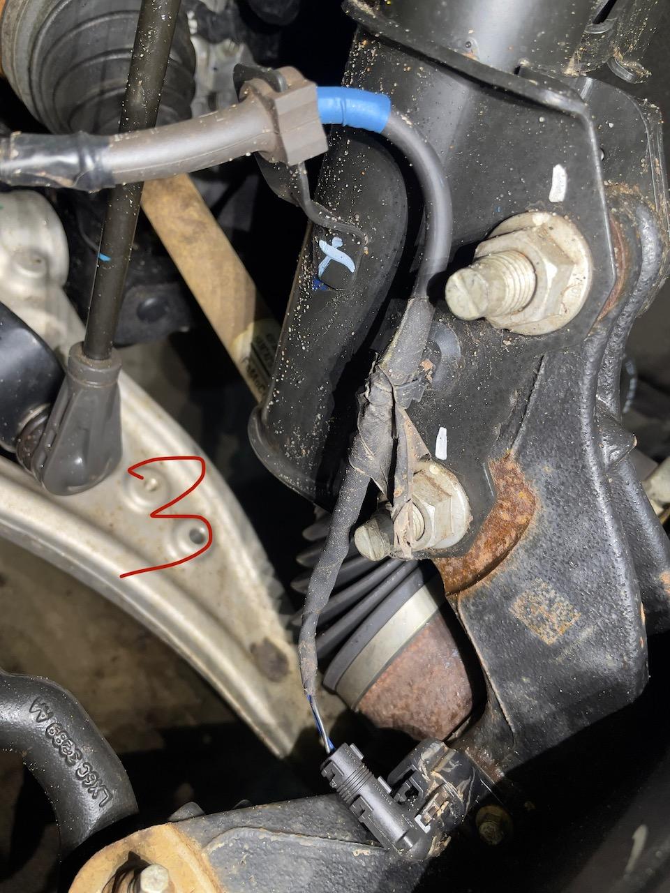

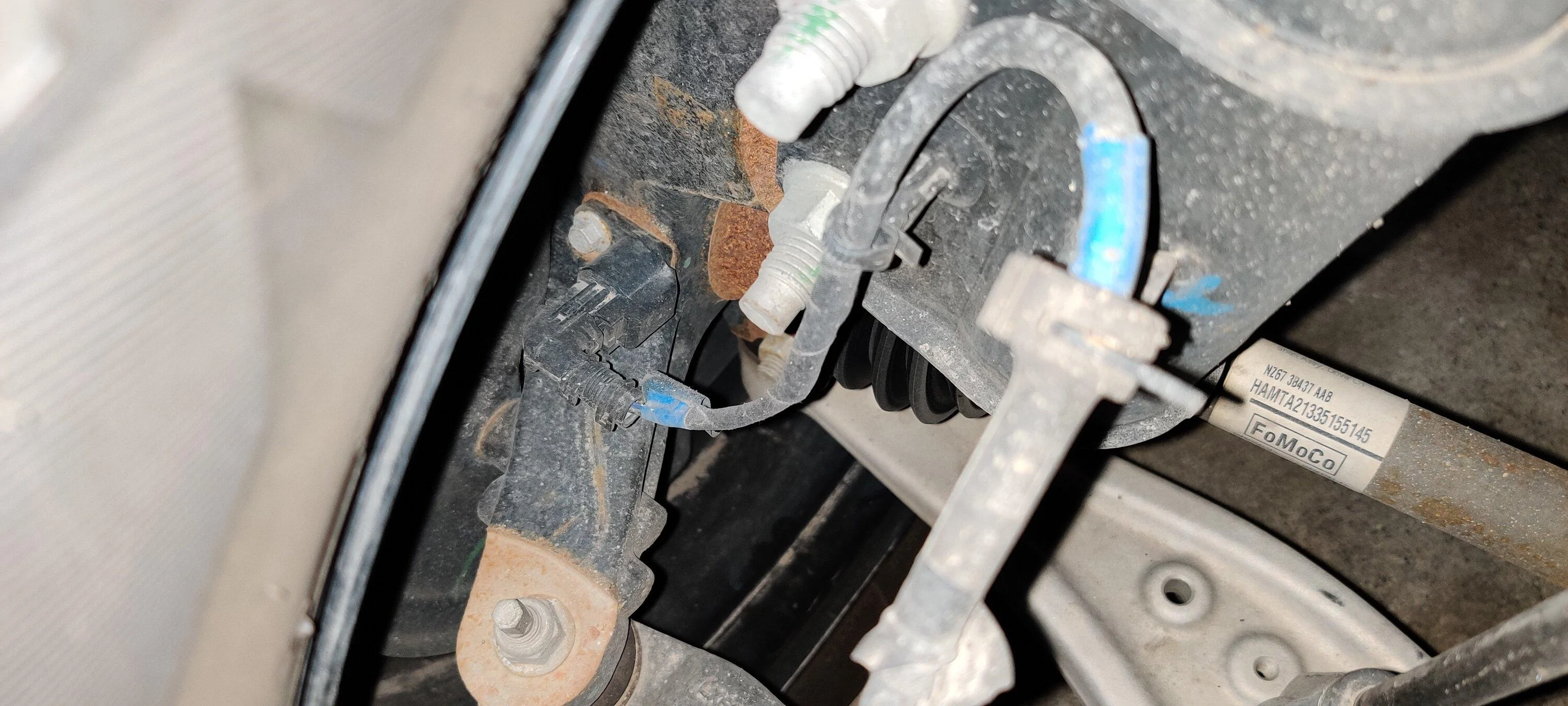

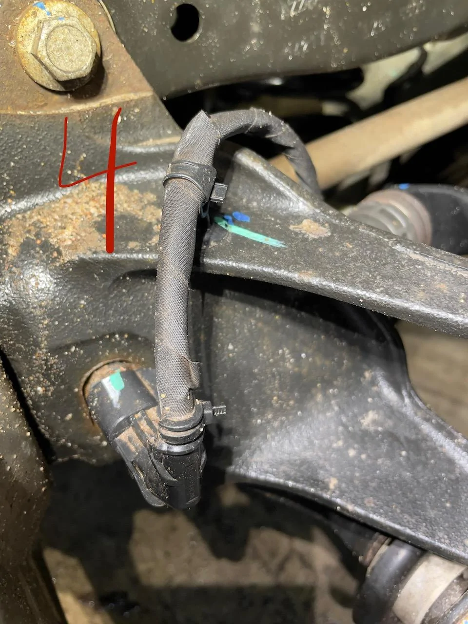

Thanks, all, for the help and advice so far. Below are the 4 sensors. To me, they don't appear to be clearly damaged but I could be wrong. Edit: I want to note that back sensors (1,4) are very well taped and the front two have visible wires (2,3)
No lights on when I started it today. Went for a short drive. After about 5 minutes the dash lit up again. Left it running and hooked up Forscan. I posted the codes below. Most appear the same but some are different.
My questions are:
How do I find which sensor is bad?
Should I be taking this to a Ford dealer?
**I know the answer might be obvious but could changes like different wheels, adding drive modes, or other Forscan mods cause this? Not saying I've done all of those but I'm trying to rule out my actions causing this and thus having the warranty denied.

Ford Maverick Multiple drivetrain faults after getting winter tires Codes2

Maybe nothing, but it appears that the 'tape' on wheels 2 and 3 has been rolled back from the connector, or at least altered somehow. Also, those two wheels have blue tape while the other two do not, and the blue tape is not placed consistently.
Having the wiring exposed like that does also not look like something from the factory.
Good luck and thanks for sharing your experience, that way we all learn.
Only the front wheels have blue tape and the sensors with visible wires are on the front wheels. Not sure what to make of that. Agree that it doesn't have a factory look. Does anyone else have blue tape on the front sensors? One important note is that the front wheels had never been removed before getting winter tires.
Agree that 2 & 3 look strange. The harness in that area should have some type of protection on the wire. Insulation does not protect against stones, etc. Blue tape is odd too - that's $0.10 in extra cost for no apparent reason.
Edit: mine looks the same.
