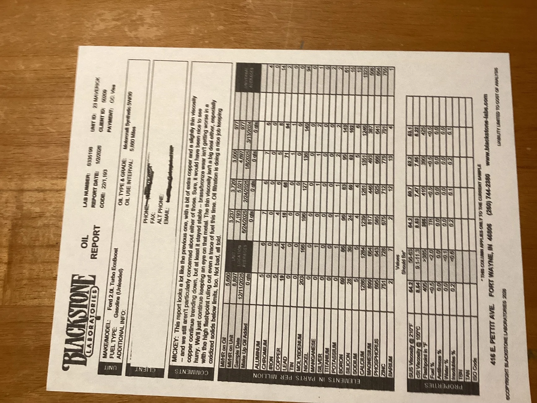

Copy of latest oil sample analysis of significant mileage of Motorcraft full synthetic oil. My focus is on oil viscosity values which historically has demonstrated low values, not within realm of the brand publicized specs. Be that the oil be blended or full syn. Also previous sample revealed shearing. This report not indicating shearing. Oh well…
Next oil change coming up soon. Have 6 qts of Quaker State full synthetic oil. The QS oil is Ford approved oil. Plan to run that next 1,000-1,500 miles, do sample see how that goes.
The 3 yrs warranty up in October. Truck not driven much, so mileage not a factor, time is. I might switch to 5W-40 syn to keep modest lubricatio.

So what caused the supposed shearing in the first oil analysis, and then just went away in the second?

Not sure. But I will ask!
I asked and Blackstone reply.
“Yep, there is evidence of shearing like before. Shearing just means the viscosity is a little lower than it should be for the grade, and it's a characteristic of some engines. It's looking like that's the case for your EcoBoost, and that's true for many other EcoBoost engines as well.
Other things can cause a low viscosity like fuel dilution or using/adding thinner oil so a low viscosity isn't always due to shearing, but when you're certain of the grade and the viscosity is low in analysis on a regular basis, it's usually due to shearing. As long as the engine wears well, a slightly low viscosity is just something to note, not a problem.”

An excellent reply from Blackstone as usual.
One reason of many why proclamations from on high regarding oil change intervals are often incorrect is touched on in their response:
"Shearing just means the viscosity is a little lower than it should be for the grade, and it's a characteristic of some engines. It's looking like that's the case for your EcoBoost, and that's true for many other EcoBoost engines as well."
