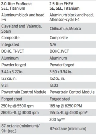

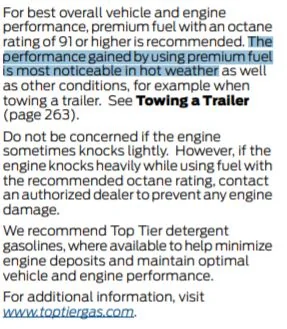

There are no modern vehicles that require premium fuel that I am aware of, knock sensors are so sensitive that any modern vehicle can adapt timing/boost/air-fuel ratios/etc, which means that MLowe05 believes that anything above 87 octane shouldn't exist and its some kind of worldwide conspiracy and that Ford is lying when they say that they recommend it and that it is required to achieve the advertised performance numbers, particularly when its hot or when under high load like towing.
The only valid defense made so far regarding my previous statement of the Ecoboost losing 25hp in the summer and 15hp otherwise is that Ford doesn't publish horsepower numbers for both 87 octane and 93 octane... turns out they did: https://www.fordescape.org/threads/2-0-ecoboost-245-horse-premium-and-231-horse-regular-fuel.103889/
The 2.0T Ecoboost in the 2018 Ford Fusion, the same generation engine used in the Maverick, made 245hp on 93 octane and 231hp on 87 octane per Ford specifications page, a 14hp difference. When hot, which is where octane really matters, its reasonably to expect that to grow at least 10hp, right on the mark of my claim. Source for that? The Ford Maverick Owner's manual:
https://www.ford.com/support/vehicle/Maverick/2022/owner-manuals/
There are plenty of modern engines that require premium, it is just extremely unlikely you're going to harm any modern engine with 87 octane.
Who was arguing that Ford is lying, or that you need premium fuel to get their advertised performance? Those are not in dispute. Both AAA and C&D tests showed improvements with premium fuel. My argument is now and has been this entire time that premium fuel has a poor ROI in both HP and MPG given the additional costs.
