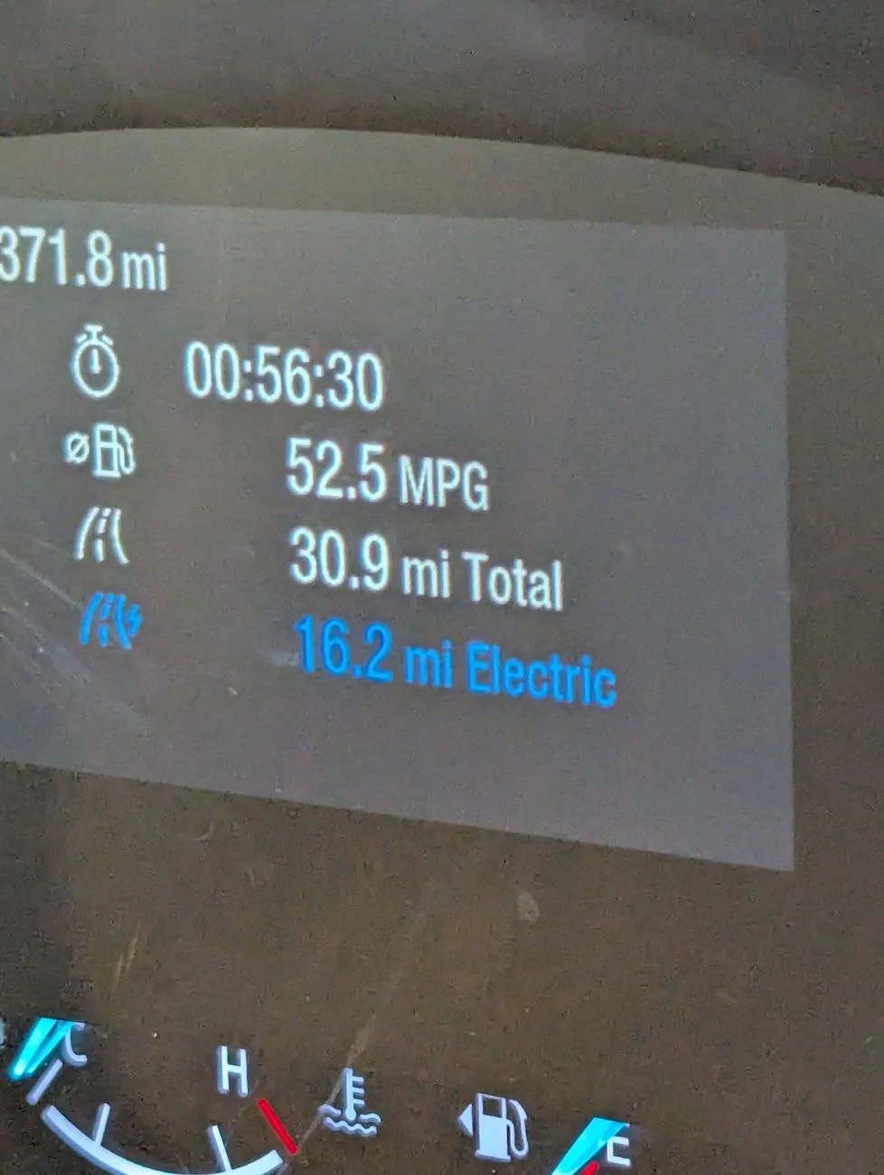

Today is a beautiful morning here in Phoenix. Very mild temperature with no wind. I was on time, and took it easy on my commute.
I use the ev coach mode on the display, in slippery mode.
It takes a while to get the hang of "pulse and glide" driving. What you do is pay close attention to the grade. I always use cruise control, and accelerate to 66 mph when going up hill, then decelerate to 64 mph when on flat or downhill grades, to kick in electric drive.
This won't work as well if the temperature is too high, or too low. Strong wind, rough roads and being late will always decrease mileage.
Ford Maverick Miles per gallon …. PXL_20250225_141440626
Forgot to add, it's a good idea to adjust mirrors so the big trucks that run 90 mph and tailgate, are out of sight out of mind.
I drive the speed limit or a few mph above or below, and don't give a sh*t if other drivers like it or not!
