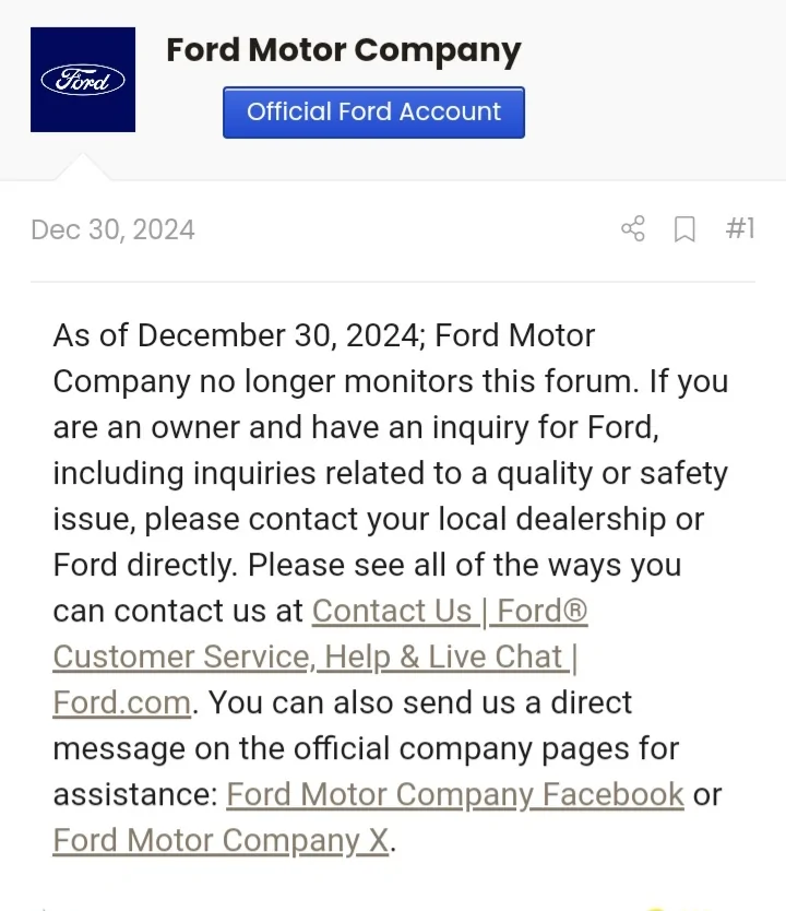

Supposedl, this site is no longer monitored per this release in 2024👇

I used it once and it worked for me.​
They forward my problem to the dealership. Some folks on the forum, mistakenly expected their problems would be addressed on the form through this contact.​

That account was useless, they would send a PM, and all they did was say, "please contact your Ford dealership for help".
