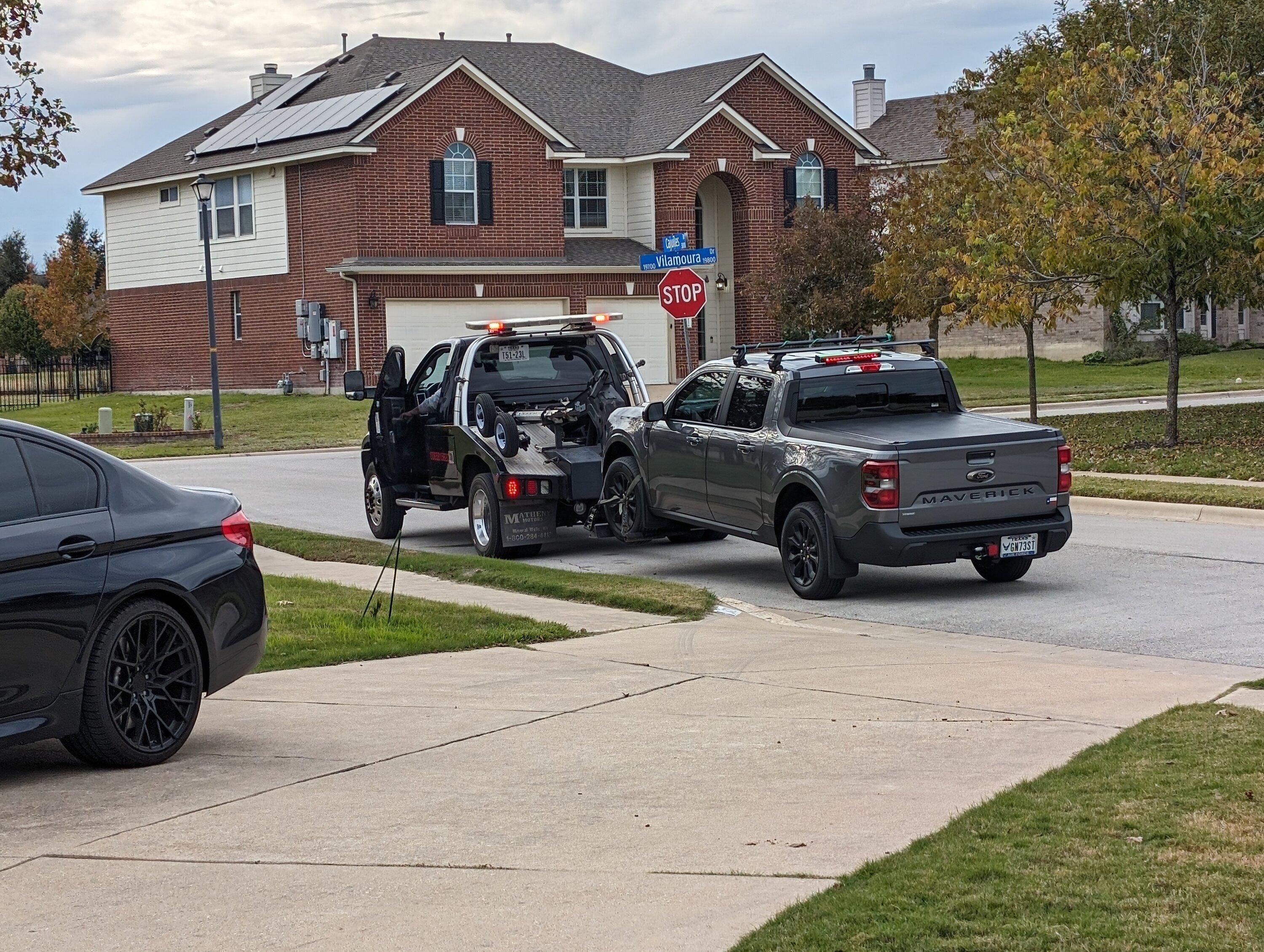

I continue to have 12 volt battery issues, rapid discharge if my Maverick is not driven daily. Voltage fluctuations and two instances of totally dead Maverick, had it towed to dealer who replaced the 12 volt battery and reset the PCM, but one week later it happened again. This time I jumped it and took it back to dealer for three day stay and the dealer reported no problems found. Opened a customer support case with Ford, so they are following the situation. I do not feel we should pay for our own replacement battery when under warranty, truck is only 6 months old 5000 miles. I am aware that there are many issues with 12 volt battery and recharge system with multiple manufacturers and both hybrid and electric vehicles. Just another sign that we are not ready to adopt electrified vehicles until manufacturers permanently address these problems.

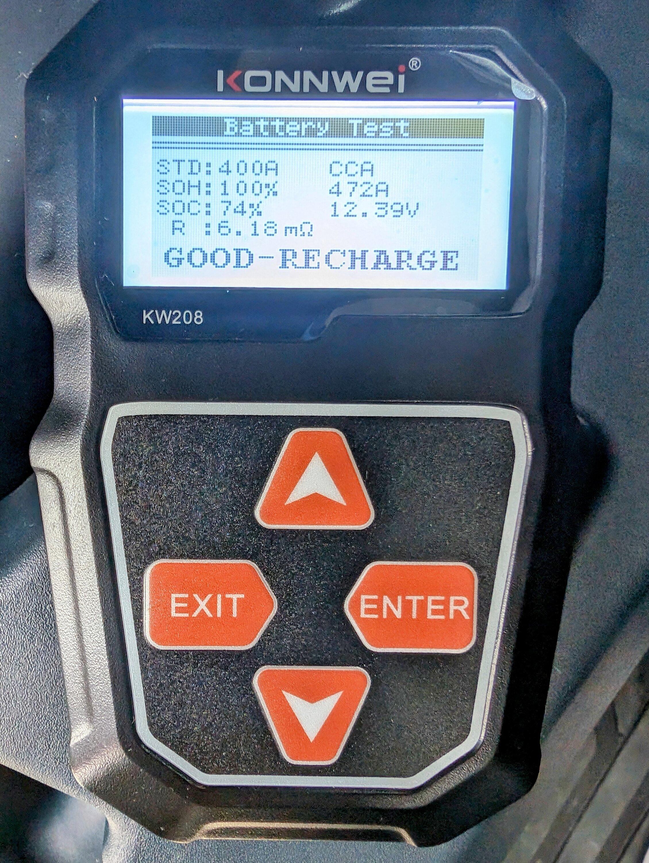

JDTexas, it is interesting your battery tester shows 447 CCA for your battery and it is rated at 400 CCA. I have the same battery tester and it also shows the actual CCA higher than the battery is rated. I am wondering why...battery tester issue?
Darnon
Jul 4, 2021
5,762
7,298
WNY
I had similar results when I tested mine. Tests good, higher than rated CCA even, but the main issue is the voltage just drops precipitously with the key off load.
