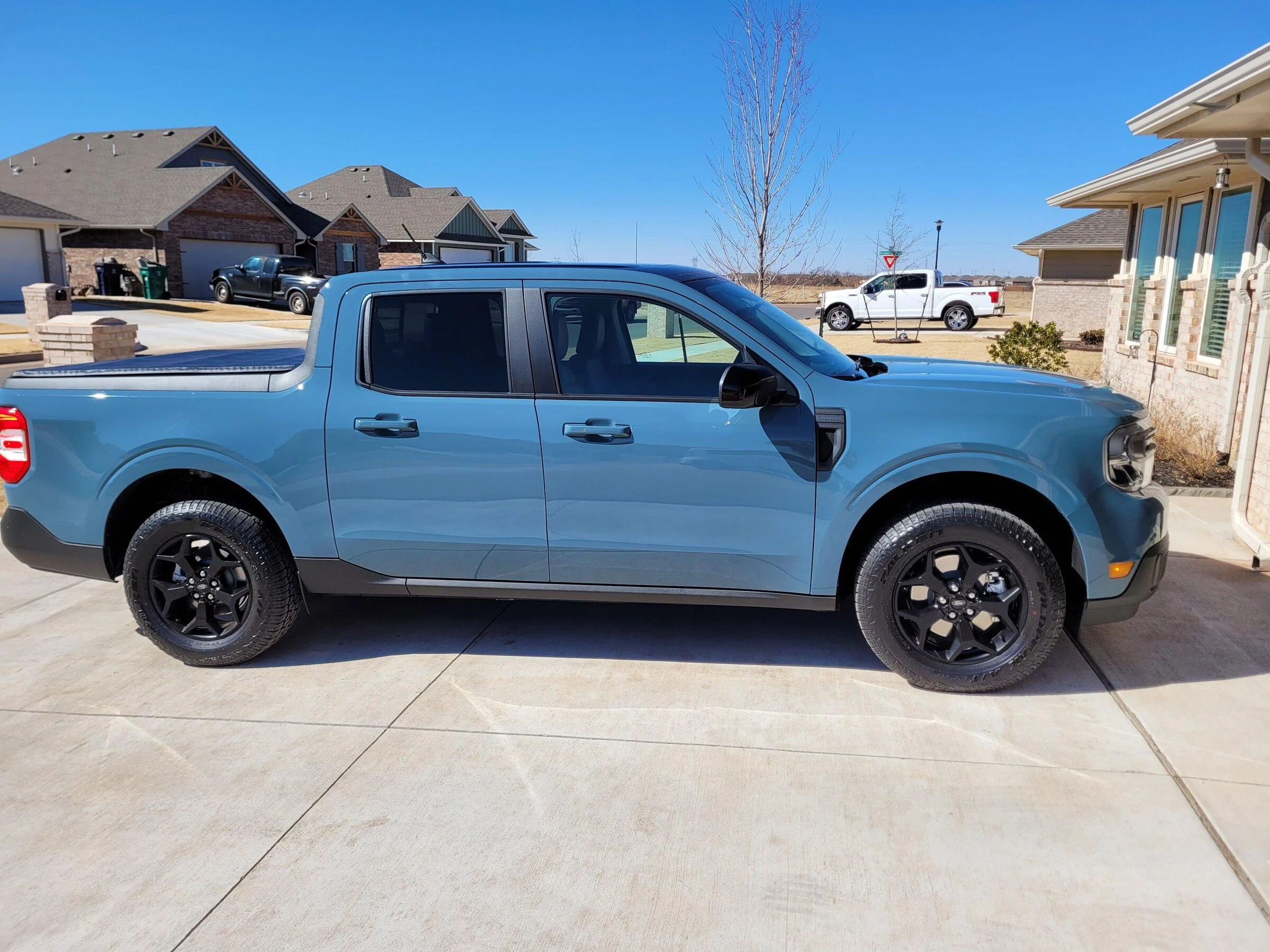

Had my 2.0 AWD for 3 months as of today. Not one single problem so far. Well, the crappy FE decals started coming off in the car wash so I had them removed. I think it looks better without them.
