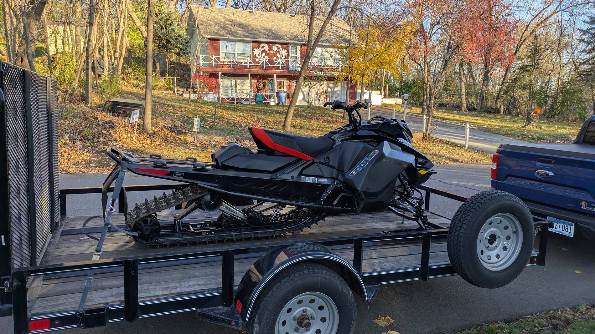

I towed the trailer and sled below for approx 300 miles at 60-70mph and averaged 15.1 mpg the whole trip. Weight was not a major consideration(~1500lbs?), but I believe poor aerodynamics may have been part of my fuel mileage. The rear ramp has to be a major wind catcher.
The 2.0 engine had plenty of power. That actually impressd me. Hunting between gears on minor inclines was irritating, but probably expected. My past experience has always been with big V8's or diesels, so those have more torque and hold the gear better.
I wasn't blown away with it's towing ability, but was also not disappointed. I do have the 4k package.
