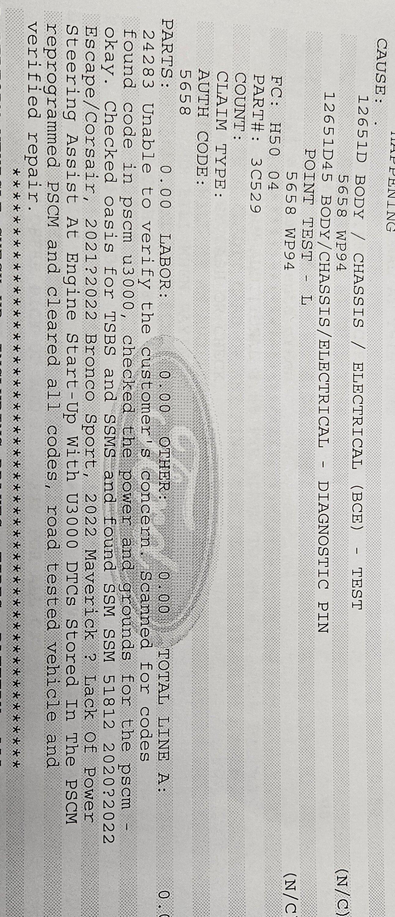

I’m currently have the same issue with my 24 Maverick (only 12K miles) and my dealership said that they have to replicate the issue there for it to be covered under warranty.
Here is video of it
I just got an update from my dealership, they said that they haven’t been able to replicate the issue and that they will only hold onto it for another day to further test my truck.
I was told that I’d have to cover all costs. Any help would be greatly appreciated

Not sure you saw this post. Maybe it expanded to 24's for other reasons besides battery, which your's should not have a problem FLA anyway.
https://www.mavericktruckclub.com/f...22-steering-wheel-got-crazy.41714/post-830598
Should also call Ford bypass dealer.

I called the service advisor and he said that there were no recalls for my specific issue. I brought up the recall that you had mentioned and he told me unless they could replicate it then they can’t do anything about it, I’ve sent him videos of the issue as well

Contact Ford directly: 800 334-4375
Mention you're having a steering issue, it is a Safety issue, and the dealer refuses to help. Mention you have video proof of the issue.
