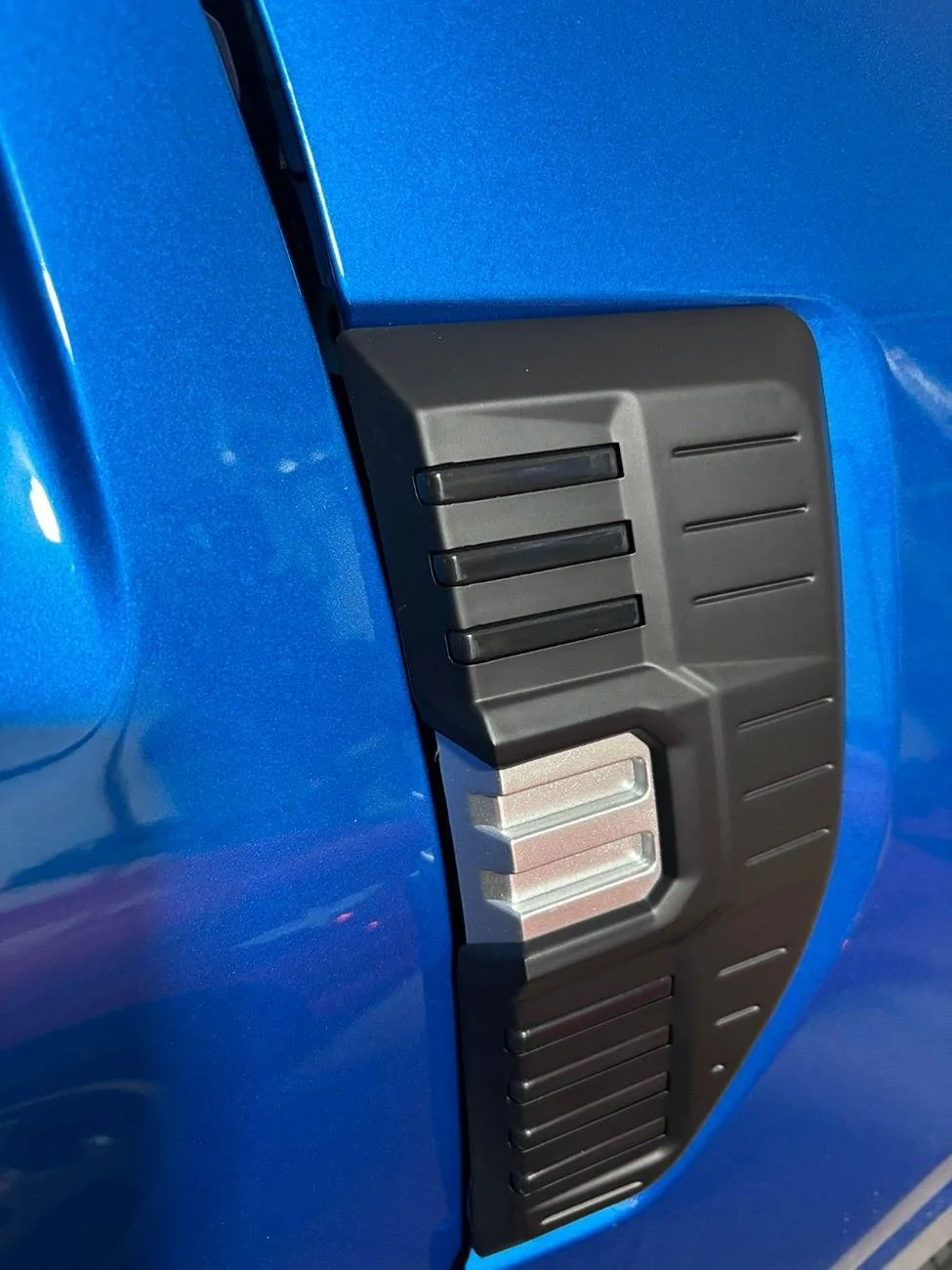

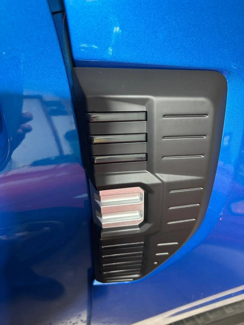

I have also installed these new redesigned Mabbett 2.0 version side maker lights as well on my 2025 Maverick XLT. Previously, I had the side maker lights version 1.0 that had the water condensation issue on the passenger side. The issue that I have now is that on the passenger side, the new side marker lightly rubs on the paint each time I open or close the door. I have tried to pry in over to the front as much as possible, but in so doing broke two of the tabs off inside. I think that it is a quality control issue. I am messaging Mabbett on Amazon for some guidance or replacement of the passenger side marker.

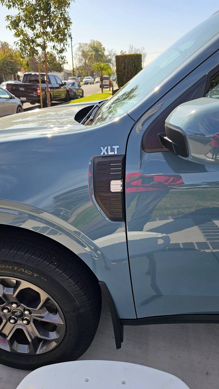

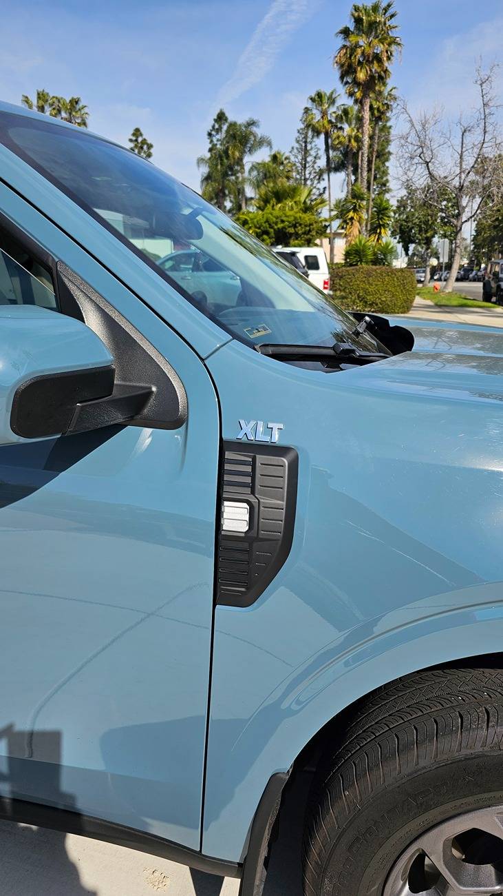

Just installed mine today. Passenger side needed to be filed down so door would not pinch it. Wiring it up was easy. Hardest part was removing the original support pins. I added some after market XLT labels.

Thanks! I didn't know that I should have modified them prior to installation. I am reluctant to remove the right side again as I have already broken off two of the tabs. If Mabbett won't replace it, then will remove it and file it down like you did.

I used my electric hand sander. It is weird how it doesn't fit on that side. But because the Tonka Maverick guy said he had this issue, I was ready to sand it down. You can't tell it was sanded from the outside. Take your time when you do it.
And you're right, it was pure hell taking out the old clips!!
