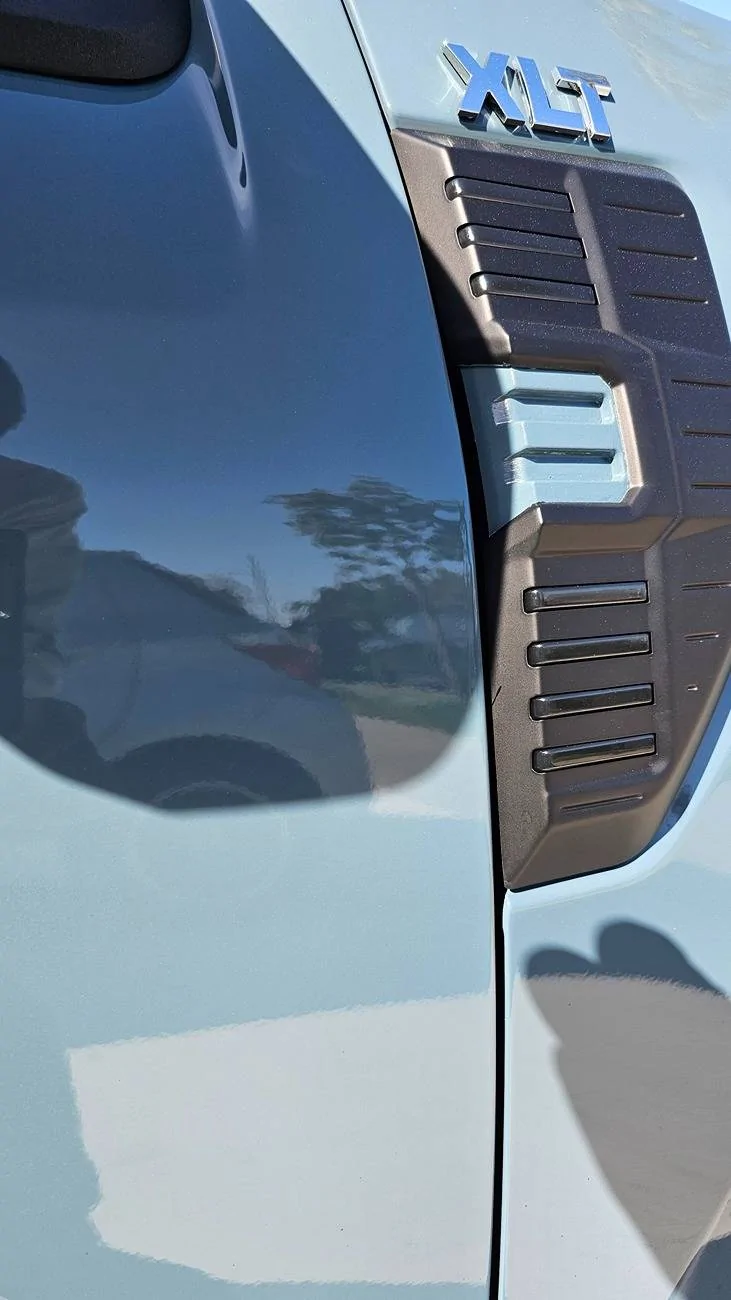

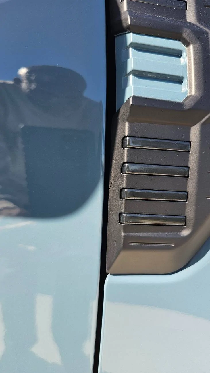

You'll definitely need to sand down the passenger side one, mine was catching until I did. Its not noticeable that its shaved down for the door to clear.
CurtisB
Jan 11, 2024
1,986
2,618
92868
2023 Maverick XLT Hybrid
Some of the people who posted pictures of how far off the passenger side is really is bad. Mine needed just a little sanding.

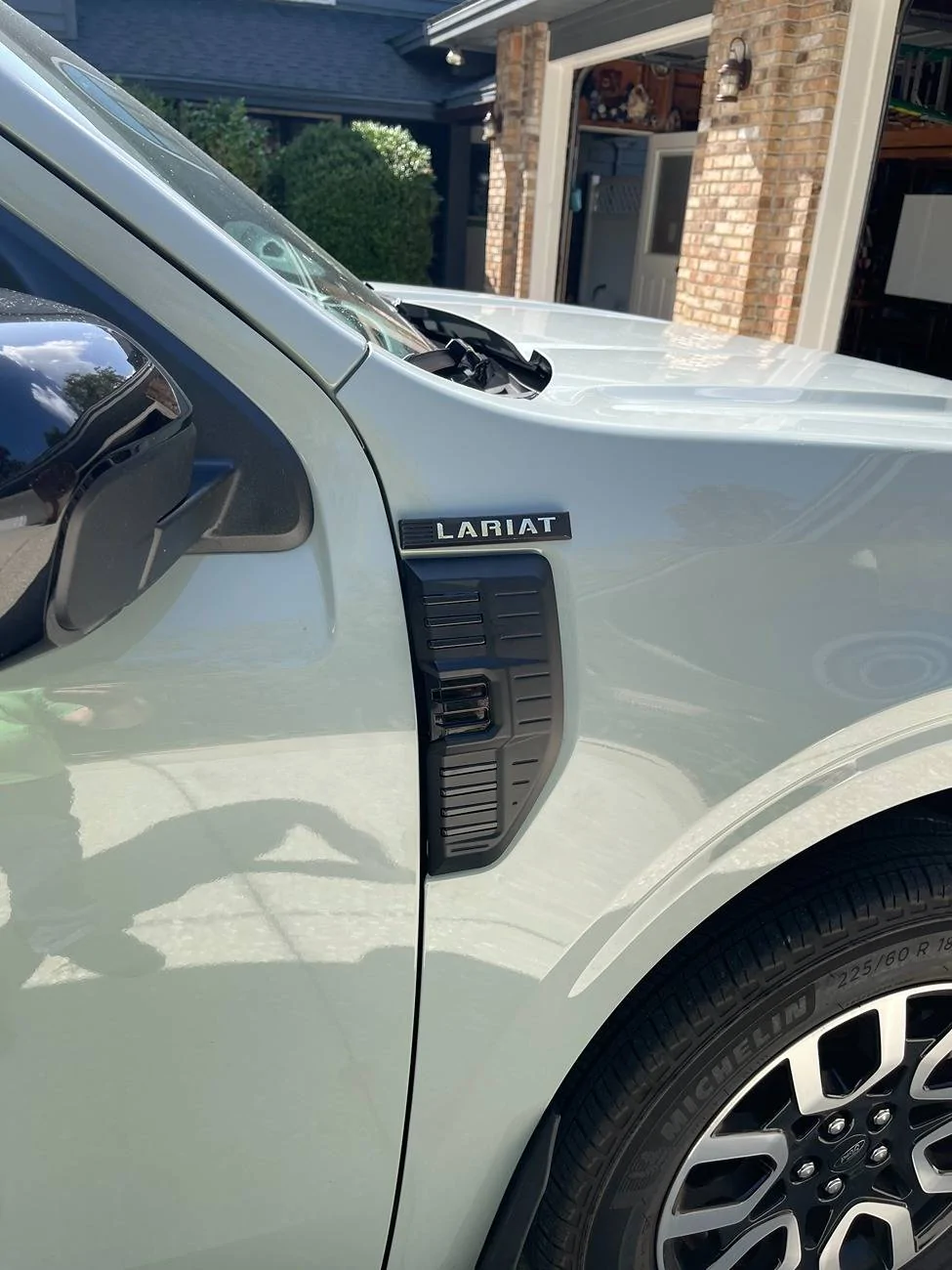

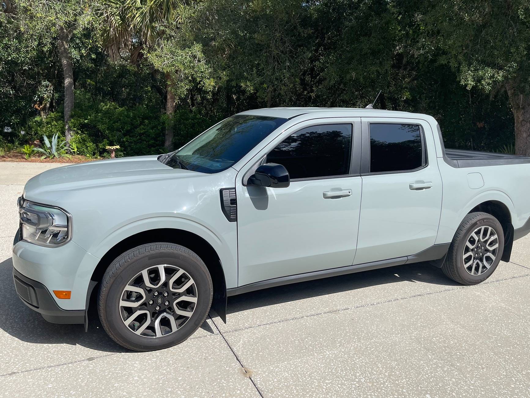

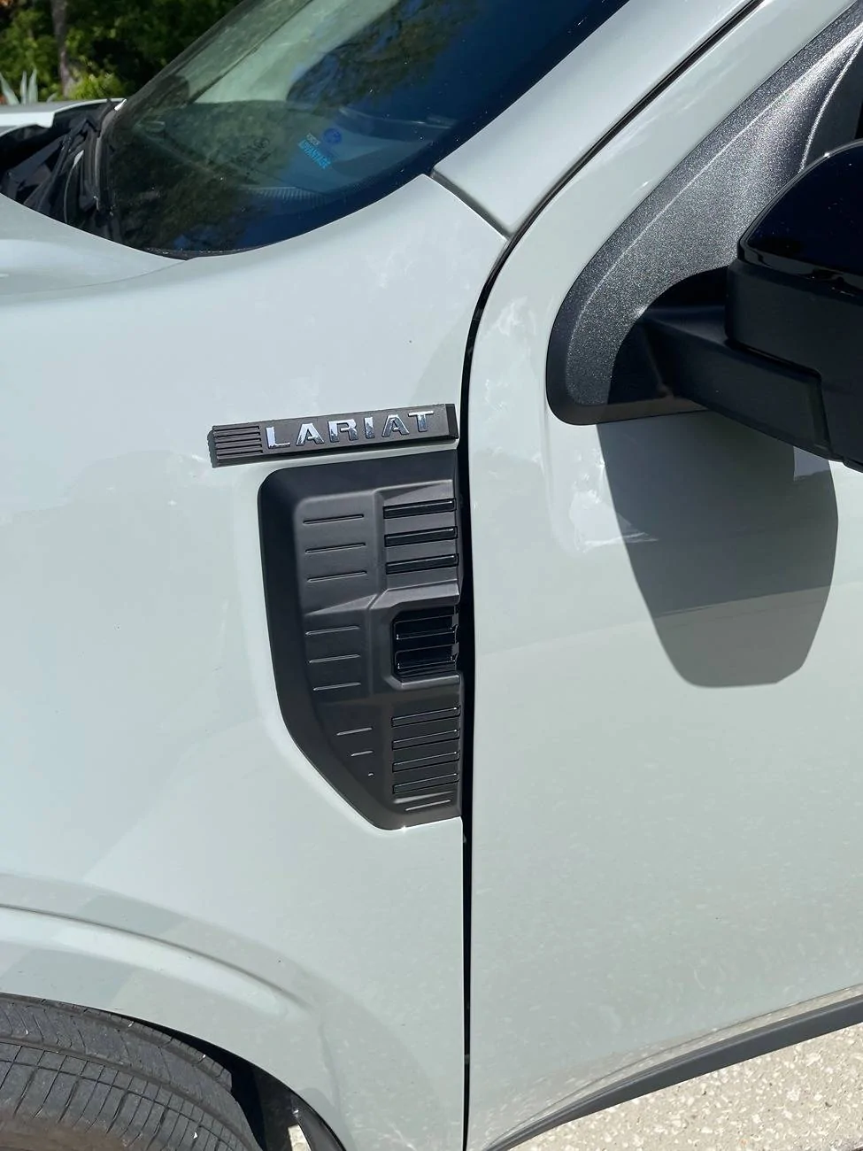

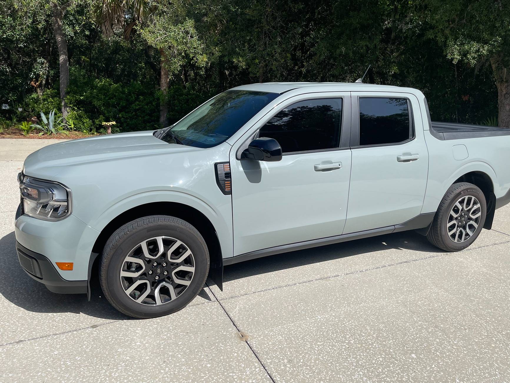

I just received the Mabett side marker lights. These are the 3rd generation just released May 28 on Amazon. The install was pretty straightforward. One thing of note was that when I removed the old badge, the clips that held it in place remained in place. I did not realize that the new badges included clips installed on them. Trying to force the new badge/lights with clips into the existing holes containing the old clips did not quite work. Left a huge gap and unsecure installation. Just a stupid mistake when trying to rush the job. Even with having to redo my first attempt, it only took about 20 minutes.
